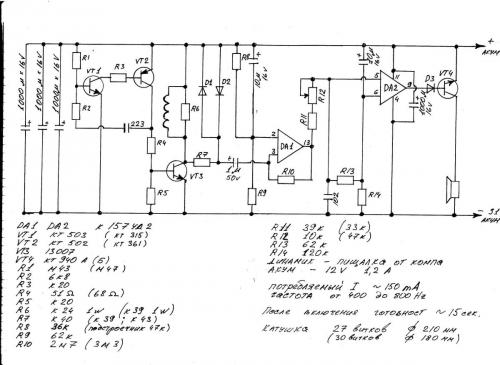

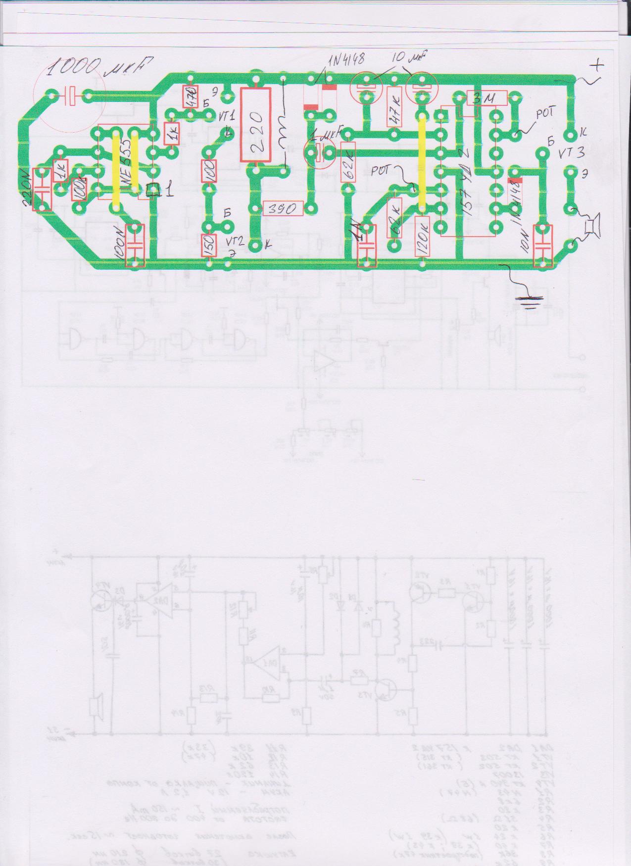

              Hey its Xmas, actually this could be a fun project, all analogue
              you can make the worlds simplest from a couple of ATtiny chips, but thats not fun.
                From Russia, with love
                  Hire more:
                  http://forum.cxem.net/index.php?showtopic=111009
                    From Australia, with thanks
                      Thanks Eddy
                      there is some xmas fun for you brucester
                      have fun
                        I have had a bit of a look around Eddy's forum,
                        the google translation is a bit hard to follow
                        but it seems that some good work has been done on this simple circuit,
                        and some alterations to the basic circuit gives reasonable results,30cm on the penny!
                        The op amp seems to be a K157UD2, which I cannot identify, but there is some talk about using aTL072.
                        The coil is something like, 190mm dia, 25T, .5mm wire.
                        A bit more reading is required.

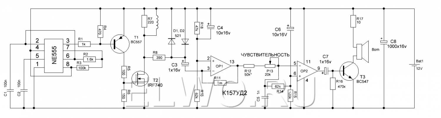

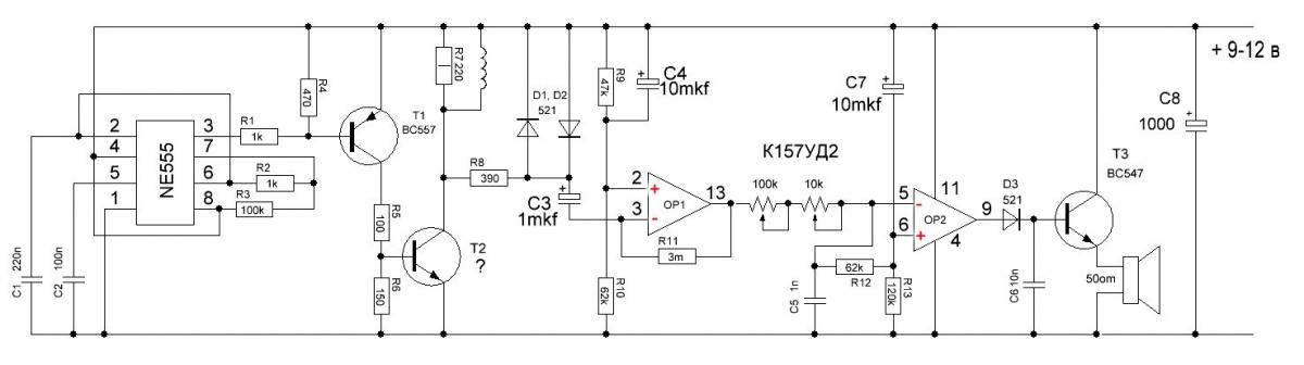

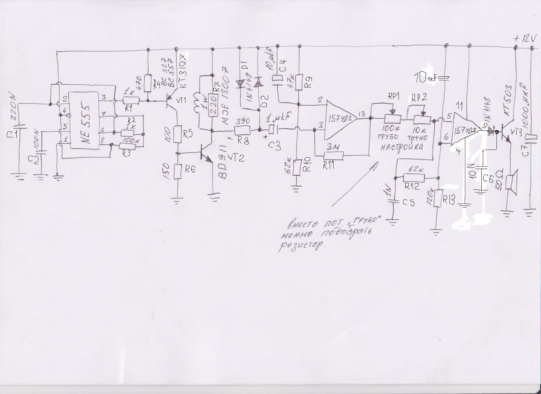

                          A couple of schematics from forum.
                            These seem to be the latest schematics.
                            TAKE NOTE if you use some other op amp than a K157UD2
                            then disregard the pin numbers and make connections to the correct + and - inputs.

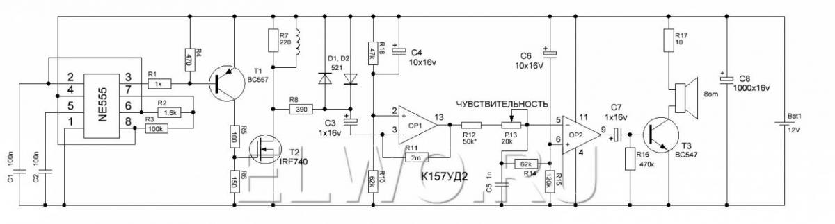

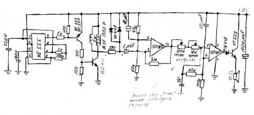

                              From Eddy's forum I was lead to another which had a project very similar, the translation seemed to call it
                              the Pirate MD.
                              9-12 volts
                              Current consumption - 30-40 mA
                              Sensitivity - 25 millimeter coin - 20 cm
                              The coil is wound on a mandrel 190mm and contains 25 turns of PEV 0.5mm.
                              Can anybody please tell us what a K157UD2 is ? thanks
