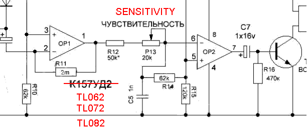

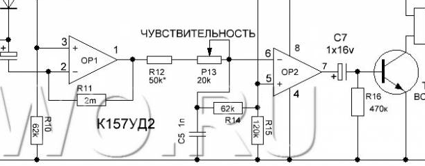

      Can anybody please tell us what a K157UD2 is ?
      It replased by LM358, schematic work stabble.

          This is an 8 pin device.
          The schematic uses a 14 pin.
          John

              as above
              TAKE NOTE if you use some other op amp than a K157UD2
              then disregard the pin numbers and make connections to the correct + and - inputs.

                  Yes, like this, but you should remove notation K157УД2 and place the suitable IC, for example like this:
