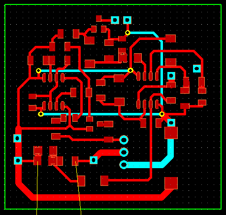

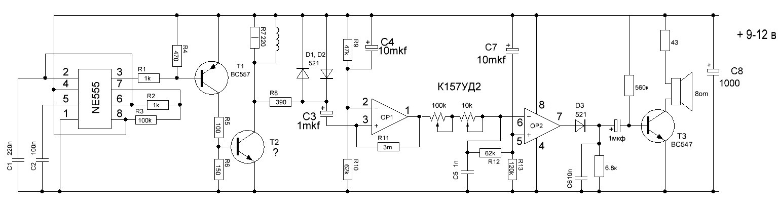

          This is what I'm starting with
ID:	334672Click image for larger version
ID:	334673Click image for larger version
          from thisClick image for larger version
ID:	334675 any suggestions ?

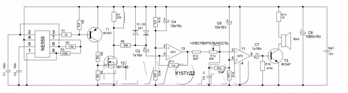

              Some change in shematic. Distance about 40cm nj 1 uero coin. R7 - 1W, D1-D2 - 1N4148.

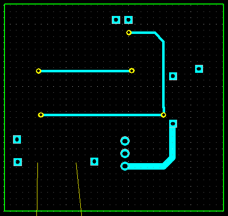

                I just built this on my breadboard.
                I used a TL072 amp and a standard npn transistor for T2
                Turned it on, nada :P
                Going to bed, will debug it in the morning

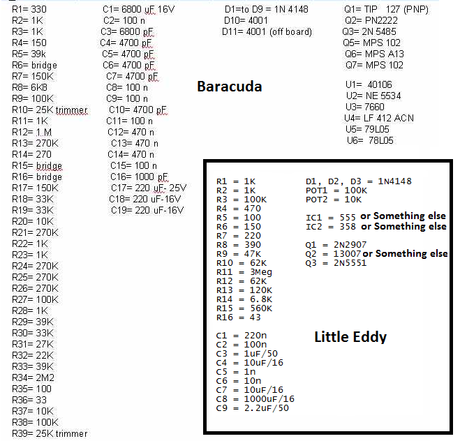

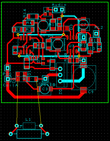

                  How much more basic can you really get than the surf or the Barracuda
                  My plan is to get it down to 1 Chip.
                    What did you use for T2 ?
                    Did you use solder-less breadboard ?

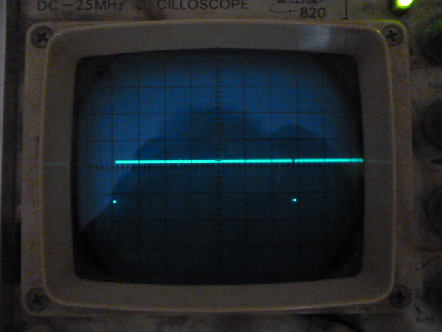

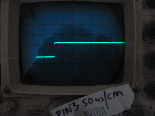

                      • #41
                        Some happy snaps
                        measured 140 PPS
                        1st 555 pin 3 50uS/CM
                        2nd slightly faster time base.
                        • #42
                          Looks like you may have reversed the invert, non invert inputs for the TL072 pins 2,3.
                          If you followed your post schematic #34
                          C3 should be going to pin 2 (inverting input)
                          • #43
                            I used a solderless breadboard.
                            Checked my TL07, the -/+ inputs for op1 and op2 are correct.
                            Leason learned, I need an oscilloscope :P
                            Will rebuild in by transfering each part to a new bread board, testing each output before moving on to next section.
