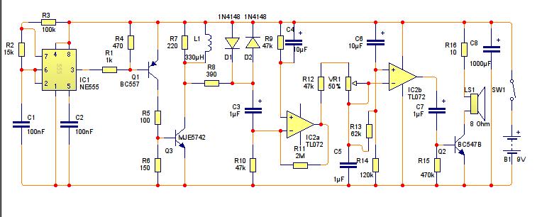

        Ok, I'll leave the build for a while and get back to theory.

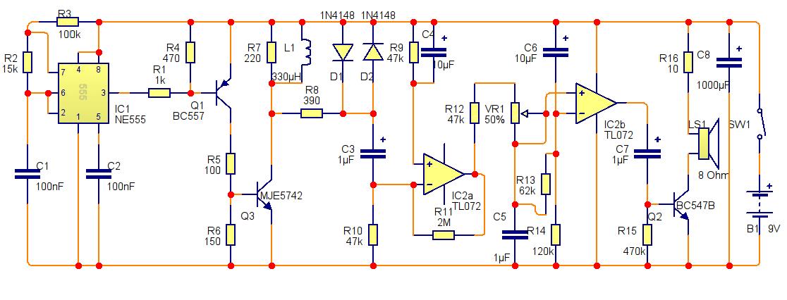

        I understand the whole circuit except for op2.
        The default setting is around 72Hertz and OP1 amplifies the final moments of the flyback and feeds it into op2 inverting input.
        I know op2 is a comparator but i dont understand what it is comparing the signal to.
        Op2 outputs a square wave so i dont see how the presence of metal can change the beating output other than always on or always off.
        If some could explain this comparator to me i would be forever in their debt.

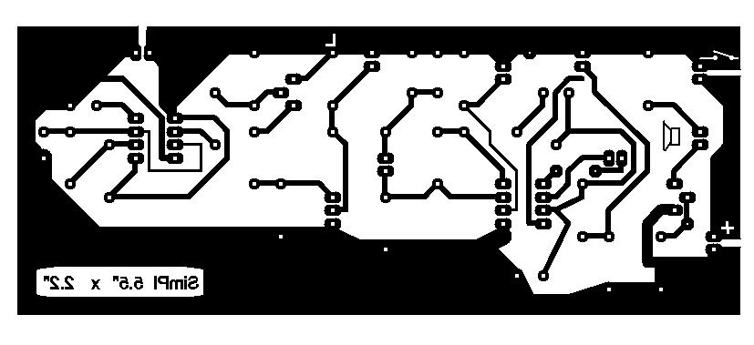

                PCB file (with russian OPamp) http://yadi.sk/d/jY-MvpOm23NhQ

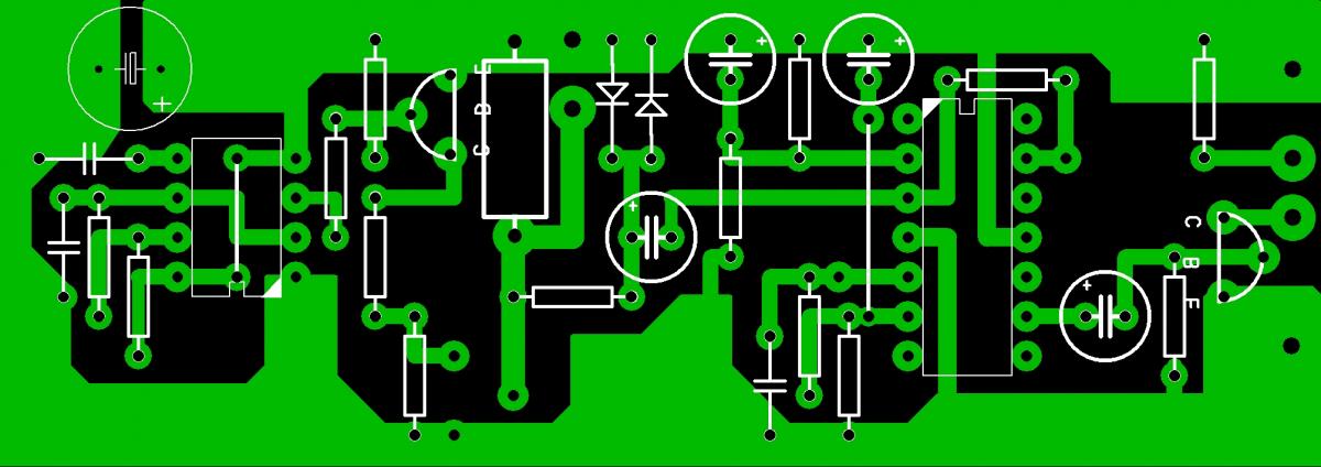

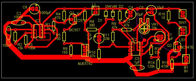

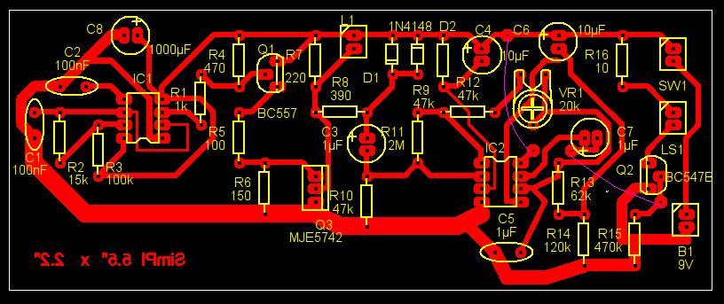

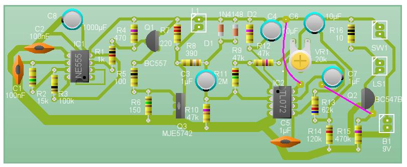

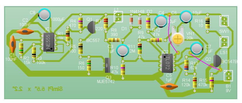

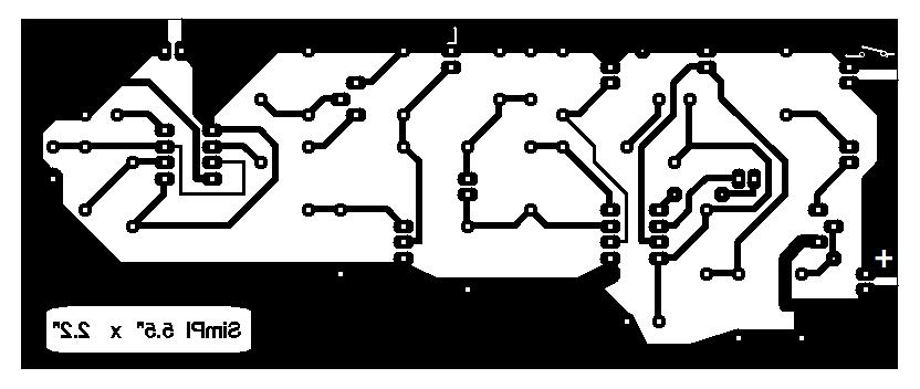

                    Maybe useful to someone (two pinky lines are jumpers):
                    PCB dimensions 5.5"x2.2". Variable resistor VR1 = 20k.
                    • #55
                      Thanks WM6
                      Looks good but is your second opam (IC2b) correct?
                      Shouldnt the +/- be reversed?
                      • #56
                        Unless it doesnt matter with comparators in which case, ignore me :P
                        Offer on the table, I will give $1mil US to whoever explains to me how op amp 2 works and what the signal gets compared to and why.
                        • #57
                          Carl already answered this question previously, so you can send the 1/1000th of a US dollar to him.
                          The input signal is split into two paths, one slow and the other fast. Note that one of the opamp inputs is charging a 1uF capacitor, and the other is charging a 10uF capacitor. This causes a differential voltage to appear across the comparator, and hence a pulse appears at the output. If you keep the target stationary, then the inputs will eventually equalize, and the output will turn off. Therefore this is a simple self-adjusting threshold (SAT).
                          • #58
                            Wow, thanks It has been killing me.
                            I thought Carls answer was referring to my wiring error. Ie, the wiring error made it a motion detector.
                            Oh well, you and Carl can split the millidollar. :P Thanks Q, you're too kind.
                                Thanks WM6
                                You are right. Corrected:
