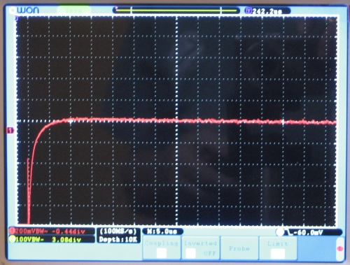

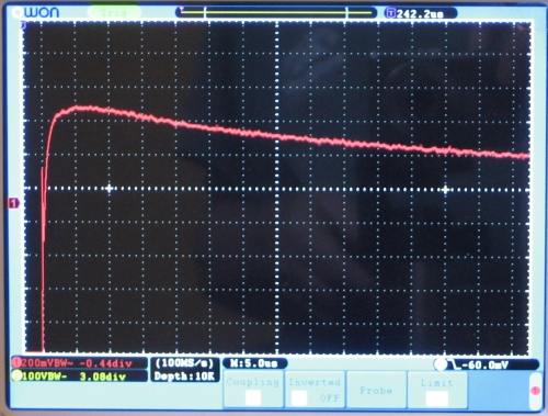

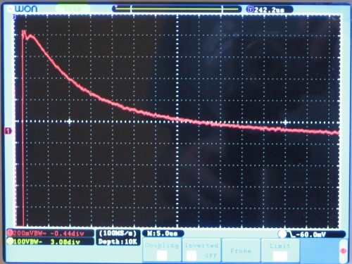

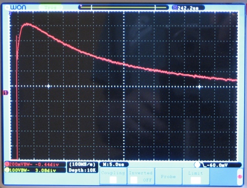

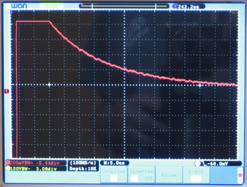

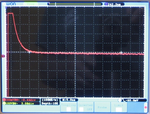

      I just took a few pictures today, of the response of different targets. The opamp is SSM2019 and the gain is 10. Since I have the circuit on the breadboard I can also take pictures of the signal before the amplification, if it is any help.

        • Hi Tinkerer, thanks for that. That is what I expected but for the life of me I cant get that response on my scope. I probed just after the limiting diodes like you did but could notice no change with any metal. I must have missed something so I'll try again on Monday.

            Actually I am quite interested in a different option for the SSM2019. As I am using a balanced system it is quite difficult to find a fully differential low noise opamp or INA that is fast enough.
            The above pictures were taken after the opamp and, just looking at the breadboard, a LP filter. The extremely noisy signal is due to a variety of external sources, including the cheap switching computer PSU, fluorescent lightbulbs etc. nearby. This simple temporary rig helps me test and balance the coil and locate the noise sources on my new bench that I have to eliminate.
            • OK, I realise that now. I guess it is not possible to see anything before the amplifier in real time.

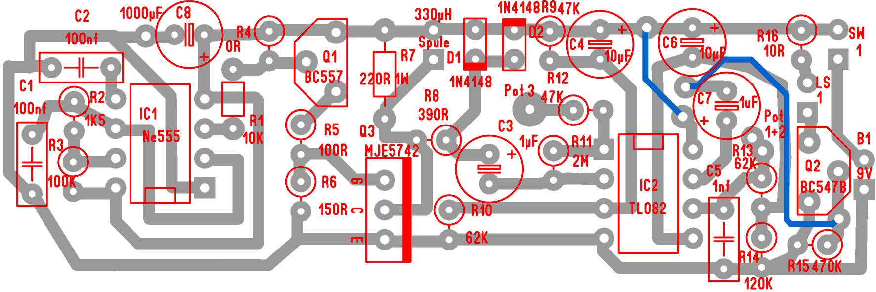

              • hello waikiki
                R2 is not 15K or 16K
                in shematics there is missing a komma
                R is 1K5 or 1K6 what you have laying around
                with r2 1K5 i get around 100µs pulsewidth
                and a frequency of 140Hz
                please lokk a inserted all corrections you say
Name:	sipi mini corrected.GIF
                many thanks

                    hello waikiki
                    [ATTACH]28118[/ATTACH]
                    many thanks
                    Yep! 1.5K is proper value.
                    Frequency: 140.097 Hz
                    Duty Cycle: 98.54 %
                    Cycle Time: 7.138 ms
                    Time High: 7.034 ms
                    Time Low: 0.104 ms
                    "0R" value near R4 looks like ZERO Ohm or just a wire jumper. If you like to remove R4 probably it is better to remove it completely or you can make it 10K too.
                    Everything else looks perfect!
                    Good luck!
                    • Originally posted by Waikiki_Sweep View Post
                      right mistake from me thx
