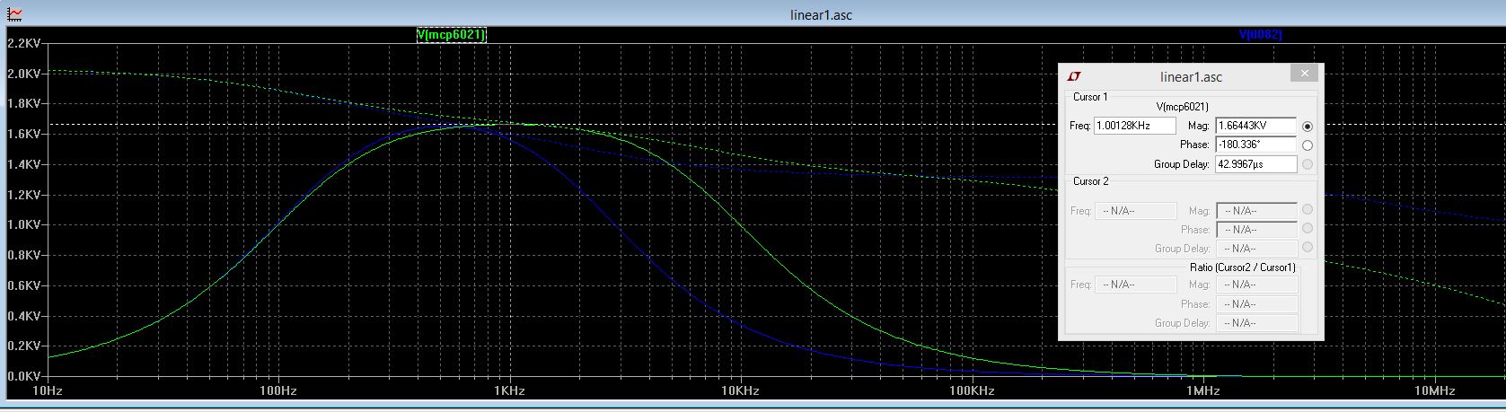

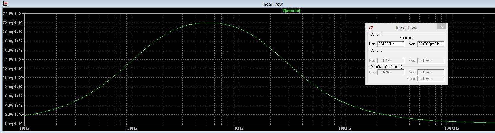

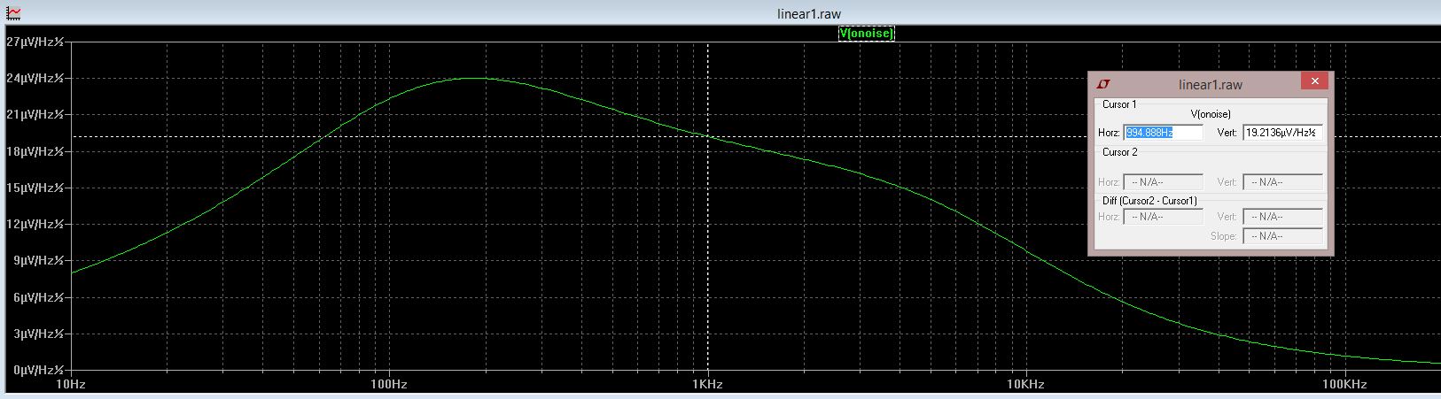

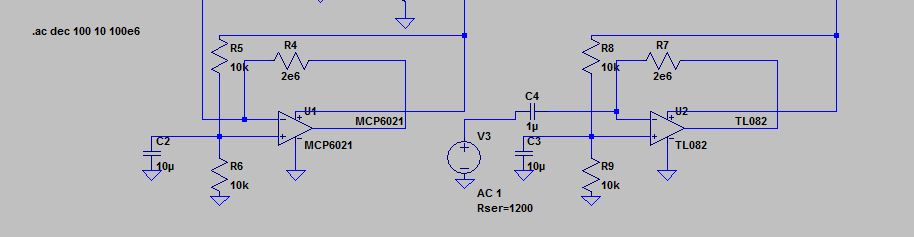

          • As a bit of fun, I compared the simulated noise in linear amplifiers using both the MCP6021 (same as the 23 really) and the TL082. Both had equal 1200 ohm source resistors and 10 k bias resistors with 2 Meg feedback resistor setting gain to around 1600x. Noise, Gain and BW plots show the MCP6021 is better.
Name:	MCP6021 & TL082 Gains.JPG
