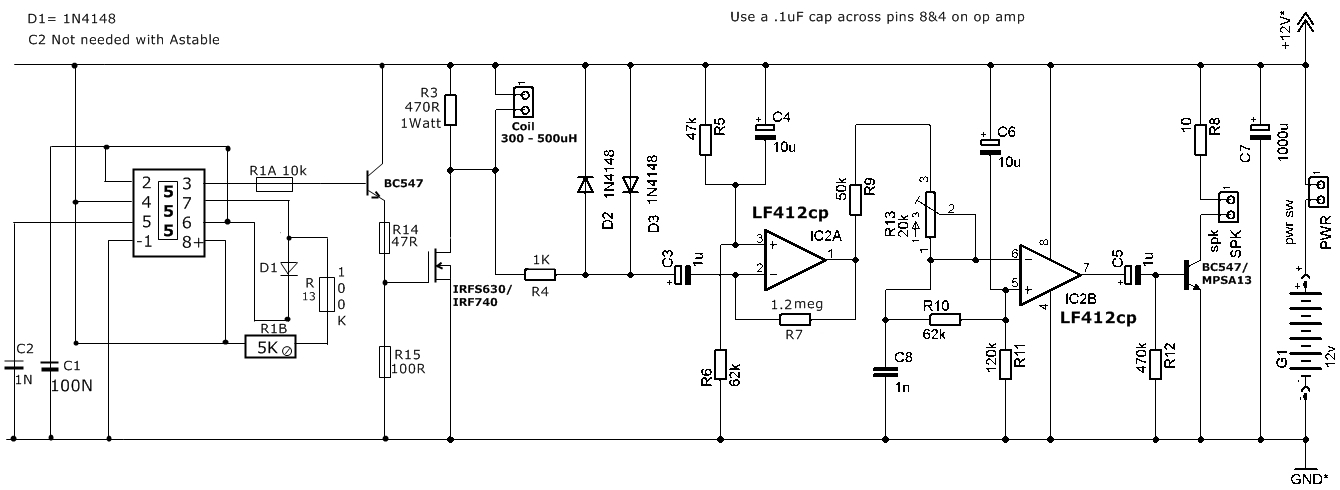

Simplest PI detector possible?
  • R1/R2 C1 set the Frequency and pulse width for the TX. I think the 1N and 10u on the second opamp set the
    sample delay and width.
    Does anyone know how to safely look at the TX pulse with a scope probe rated to 300V? If I can do that I can
    do a few measurements.
    • Looks like pin 1 of IC2A is a safe place to probe cause the diodes and resistor isolate the flyback and the amp is on all the time.

        • my changes to schematic
          Paku, this is the redraw of what changes I made and it works fine for me, it detects quarters at 8 inches, attached the latest I re-did. the only think not on this drawing is the damping resistor change, on my boards I used a 1.2k 1 watt because I am using a spider coil with them.

            • the schematic have 5k pot not clear connection
              • Someone could help me. my circuit only works with the capacitor C7 inverted (polarity) transistor Q2 becomes too hot.
                Anyone know what is???
                • C7 should explode if its in backwards. Check your power supply and show us a picture if you can...
