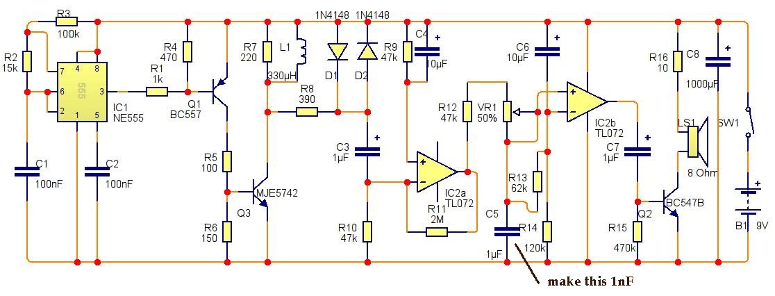

              WM6, your C5 is 1uF. The original Russian Pirate is showing 1nF for that part (connected to OP2 -in).
              • #82
                Notice that this schematic has the same error with R10, it should go to IC2a positive input.
                • #83
                  Yes C5 have to be according Russian source 1nF. Thank you porkluvr.
                  Hope there are no more mistakes in my adaptation.

                    Did u mean R9 and R10 to be 47k?
                    I tried those and they weren't as good as the original values.
