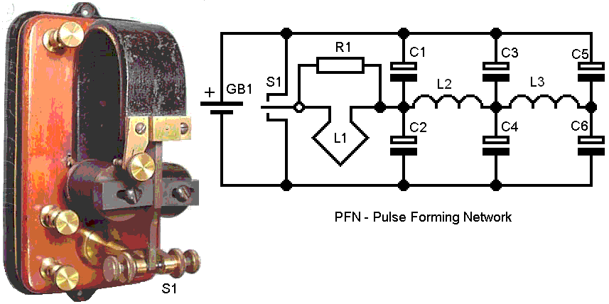

                Carl, I believe that you will soon open a museum for the history and development of metal detecting technology. However I do not know how many floors will the building of the museum. Secure your collection will occupy two floors.
                If you have a suitable building, you can order Bulgarian masters to make for museum excellent operating copies of three different metal detectors, designed and built at the end of the 19th century. There is a fourth but not operating model from 1902 with PFN and a polarized relais. It can not operate because local masters don't know how to connect several windings of polarized relais. Here is the principle of TX (relais bobbin connecton not shown):
                  By the way , this ancient relay-controlled device looks like not a square wave , but mostly like a short bipolar-pulse technology . This LC network is in fact a non-terminated "delay line" ..... and the delay time of this line ( multiplied by 2 ) will define the pulse duration . Interesting solution
                    I'm accumulating the proper parts to build a replica of Bell's 1881 detector. For the museum, of course.
                      Using an old telegraph sounder as metal detector is really great Bulgarian innovation.
                            WM6, the polarized relay is not a sounder. It is used as a controlled commutator to generate square wave. The unknown circuit should operate self-oscillating, but we don't know how been connected windings to PFN circuit.
                            The use of PFN (pulse forming network) in TX of a metal detector is the great innovation.

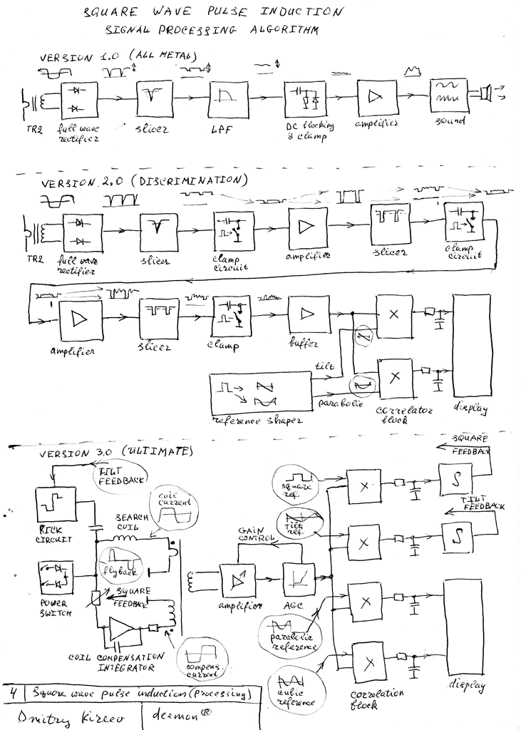

                              So , guys , let's continue
                              Now we'll talk about possible signal processing algorithms in this square wave approach . After theoretical analysis I found 3 basic algorithms that can be used here . First algorithm , being the most simple , works in "all metal" mode and utilizes the quality that I had been talking before - average coil current drop in presence of the metal near the search coil . This effect doesn't depend on the target metal type , it works very simple - our target "sucks" the energy from the coil , and we can detect it . By the way , this effect does have one VERY interesting property , I'll talk about it a little later . I'd never seen it before - it's really something new
                              The second algorithm is way more complicated , but it can also extract more information from the target . Its idea is very similar to my recuperative PI device , described here - http://www.geotech1.com/forums/showt...y-recuperation . And I used the very similar signal extracting technique , I mean the pulse slicing , clamping and amplification with the correlation block on the end of the signal chain . Main schematic idea may be called "distributed precision" - I mean the signal amplification in different stages , when each next stage does correct the errors of the previous one . As we can see on the block diagram - an exponential target response being separated from DC component , amplified by several gain stages and finally multiplied on the reference signals of different shapes ( like I did it before ) with averaging the final signal . This idea helps us to cancel the noise ( due to averaging ) and at the same time to find the real time constant of the target ( target discrimination ) - TC is proportional to the two channels output ratio ( for example , tilt and parabolic ) . I just tested it on the bench and it works with square wave signal as well as with serial pulses before . But of course , this algorithm can be easily implemented in digital domain also . In this case we must connect our ADC to the output of the current transformer ( TR2 ) via the single op-amp I-U converter , performing all other operations in DSP .
                              And finally , the third algorithm , which I called "ultimate" because it can extract maximum target information . As we can see , I use here the same compensation idea ( based on Faraday's law ) , that I described here - http://www.geotech1.com/forums/showt...3-mono-coil-IB . The only difference is that I used an "integral form" of the principle . In the previous circuit I used the derivative of the coil current to compensate the coil voltage , but now I use the coil voltage integral to compensate the coil current And I perform this compensation just in the current transformer ( which has 3 windings instead of 2 ) , so we don't need to load our signal preamp with the coil idle current wave , that can improve its noise performance . And we don't need to "rectify" the signal here ( converting it to unipolar form ) , this allows us to amplify the signal without any clamp circuits , etc , with a simple and high-quality AC amplifier , and use auto gain control ( AGC ) to prevent overload in presence of big metal targets near the coil . This allows us to push amplification to its theoretical limit and gain the maximum possible performance of the entire device . And we can do even more - we can process our signal as a continuous wave , without any "holes" in it ( due to transmit pulse blanking ) , so the "eternal" PI devices drawback is removed .
