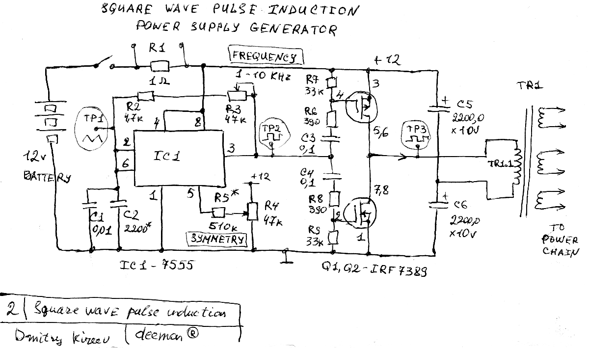

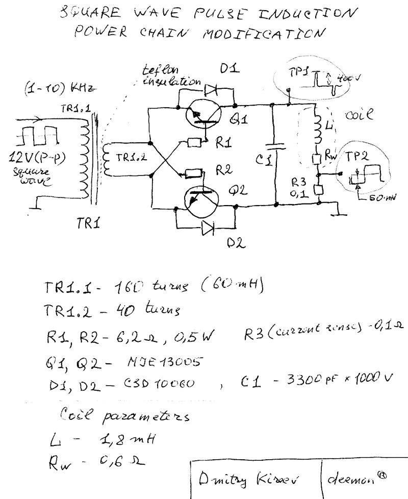

                  This is my attempt to reproduce Deemon's amazing CCPI tx circuit.
                  Still a work in progress. It uses a minelab SD,GPX style DD IB coil. This proto uses manual current compensation. Deemon devised a self adjusting current tilt, which I wanted to avoid while learning.
                  The power transformer is the key to the circuit. Deemon was using recycled toroid cores and could not ID the material type. So I set out to determine which standard cores work. I used ferrite cores with 25mm to 29mm O.D.s. Ferrite material types tested "F", "J", "W" and metal tape type "4D". One example - 29mm J material, primary 130t #32 and 70t, 2 x #26 teflon for the secondary. The primary should have about 1 ohm resistance. On the secondary the lower the better.
                  Most toroids you find are the powdered iron type which will not work. Permeability between 2800u to 8000u seem to be the sweet spot. I even made a transformer from a salvaged E-core that was used in a electronic light balast. It worked but was physically too small for the heavy gauge secondary.
                  Attached are Deemon's drawings that I based my experiments on. Also transformer test circuit along with a proto that I am still playing with.

                    Watching with interest. The preamp-output wave form looks problematic (including coil not being dampened properly).
                    • I don't think this circuit needs damping, take a closer look.
                      • The Tx coil is undamped. The rapid reversal of the current kills the coil voltage after T = 3.14 * sqrt(LC) .The Rx coil is critically damped. Coil is induction balanced and nulled. Most of the mess you see on the pre-amp output is some odd harmonics of the half sine. You can actually sample during this period. I have not tried this because the current compensation kicks in during the peak of the half sine. You can see on the yellow trace a notch at the peak. This is about +/- 20v being added to correct the current loss between pulses.
                          Your scope pictures show a longer delay time between target sample and ground sample than I've been using. Have you found the long delay time to be better?
                            Hi Green,
                            Those settings were random. I was actually learning how to use the Rigol screen print feature. If set, the sample delay would have been shorter and the gb would have been much closer to the first sample. The ccpi seems to have different gb characteristics than other BPPI's. I'm not sure where to define the start of the sample delay. If you look at the digital turn on pulse, there is about a 4us delay before the current reversal begins. What is the target seeing during the different time periods? Still lots to understand.
