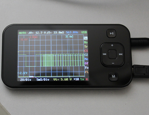

        Also a small pocket digital oscilloscope ($66 on eBay) may be installed into detector case to watch decay curve in fields.
        Why not?
