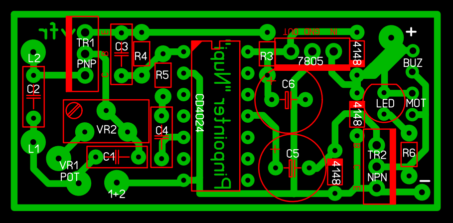

                      • Hi! My PCB.
                        • Originally posted by hadrianus View Post
                          Hi! My PCB.
                          [ATTACH]29206[/ATTACH]
                          It looks very good.
                          What do you use for transistor TR1?
                          On the PCB I see an image of a sot-32.
                          Can you tell what kind of coil you use?
                          • Thanks!
                            sot-32= BD237
                            TR1= BC560
                            Coil: 10x100mm ferrit, L1: 0,23mm 100 windings, L2: 0,5mm 70 windings
                            • Have you already made ​​the pinpointer on your pcb and tried out?
                              Are you satisfied with the result.?
                              Find your worth to build the pinpointer?
                              What would you add to or change on the pinpointer?
                              Sorry for many questions, but I am today in questions mood
                              Üdvözlettel
                              • He will be tested in the days. The results, and I will announce the modification.
                                Nupi, you can in Hungarian?! "Üdvözlettel"
