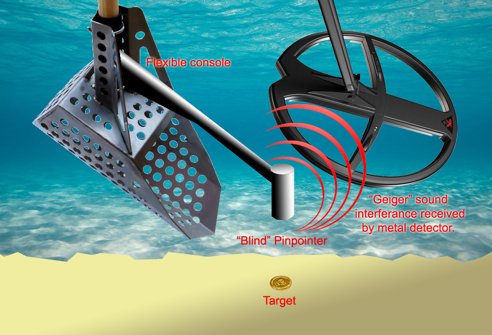

                      OK. Just catch another one.
                      I have an idea for you: BLIND PINPOINTER!!! NO INDICATION AT ALL!!!
                      But how it works? If you using pinpointer for sure you holding metal detector in other hand and your headphones are on.
                      If you hold your coil close enough to pinpointer you have to hear some interference from its work.
                      And when your pinpointer find target that noises changing.
                      So let your pinopointer to communicate with your metal detector and use metal detector coil as a receiver of pinpointer emitting signals.
                      It will make staff much more simple and convenient especially to use underwater where you can not hear your pinpointer or look on it.
                      Sure there some experiments are required and may be some changes or tunings for frequencies but it looks doable.
                        Where is my Nobel Prize?
