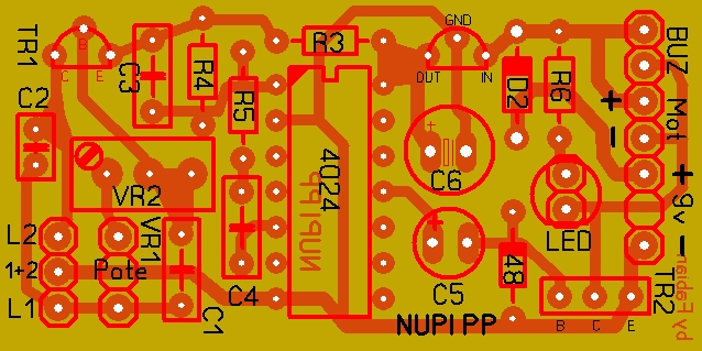

      • Hello Nupi. I have a problem: I can not get the voltages you recommend in some zones of the circuit. I set up the board to your specifications, but can not get the 4.5 volts at the junction of R5 and C4. There I have 1.65v. Also at the junction of R4, R5, C3 and IC1 I have v 2.5. With VR2 varies between 1.65v and 2.5v.
        The only difference with the instructions, is that I used a polyester capacitor 1.8 nf instead of ceramic.
        Any suggestions on how to continue?
        Fabian

        • Hi Fabian,
          I assume that you are measuring with the L2 disconnected.
          1--Take the power off
          2--Disconnect the entire coil.
          3--Disconnect R4 on the side of the emitter.
          4--Measuring the resistors R1 + R2 should be about 100K are rotated left or right. Tell me if that's right.
          5--Add the voltage back on.
          6--And then measure the voltage at the emitter of TR1 to the minus. What voltage do you measure now?
          nupi

            Hi Nupi.
            - Measurement of R1 + R2 is 103K and oscillates somewhat.
            - Between the emitter of BC560 and minus, measured 5.1 v
            • Connect R4 again and measure the voltage at the immetter. What voltage do you measure now?
              nupi
              • What is the "immetter"?
                At the same point (BC560 emitter), with the R4 connected, got the same volts: 5.1
                Fabián
                • Sorry, emitter TR1

                    That's the measurement
                    • Is good, that means that the error is not in the IC, but in the coil.
                      I'm afraid you have the coil not connected properly or is not wrapped properly.
                      1--Please make sure the coil is connected properly.
                      2--Measure the resistance between L1 and L1a-L2 and L2-between L1a and L2a and between L1 and L2a. What is resistance do you measure?

                        L1 to L1a-L2 (0,35 wire) 1,9 Ohms - 2 mH
                        L1a to L2a (Two layers coil) 4,2 Ohms (0,28wire) - 2.5 mH
                        L1 to L2a 5,1 Ohms 3.4 mH
                        • The values ​​are too high. They should be about 0.6 and 1.6 ohms.
                          How many layers have you wrapped?
                          Do you have an inductance meter.?
                          • I made it as you described in the thread:
                            71 turns in the first layer (0.28 wire)
                            74 in the second one
                            and 54 in the last one (0.35 wire)
                            I've have a multimeter with H scale
                            • What is H scale?
                              • Henries
