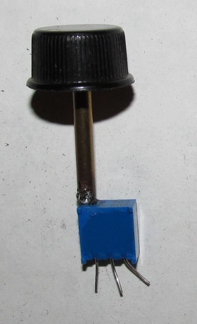

                • Cheap, Multi-Turn Pots
                  Multi-Turn Pots are Expensive. But 10, 18 or 25 Turn Trimpots are CHEAP.
                  A Short piece of 1/8 Inch Brass Tubing (From Hobby Shops) can be soldered to the Brass Screw Adjustment on these Trimpots, And than can be fitted with a knob for 1/8" Shafts.
                  Make sure the Brass Adjustment and the Inside of the Brass tube are Clean.
                  Carefully Than Pre-Tin the Top of the Brass Screw and partly fill the inside of one end of the tube.
                  Be Careful to Position it Sraight near the trimpot, than using a Weller Soldering Gun,
                  Heat the Tube to melt he solder in it, Than place it onto the Screw and Quickly Remove the Iron.
                  If all goes well it will be Straight and work really good.
                  On MY FIRST ATTEMPT at this, I had to Re-melt the tube Two times to get it Straight, But still didn't damage the trimpot.
                  • Great solution Gary, thank you for share.

                        • Originally posted by chemelec View Post
                          Thank you for your positive and constructive contribution.
                          The Multi-Turn Pots are indeed Expensive and often very large.Your tip is very useful.
                          I have sometimes used, but I glued the shaft with two component adhesive, because perhaps the problem of the
                          excessive heat for the trimpot. What I did was supporting the tube so that it lasts longer.I think these tubes are ready on sale.
