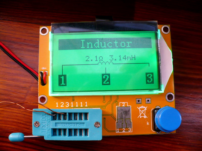

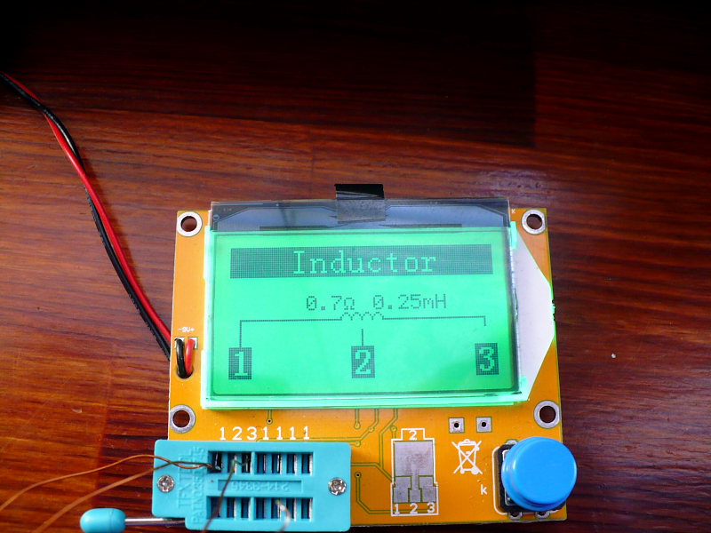

    I changed R2A 68k to 4k7 - my coil is 0.5mm wire and has lower resistances. C8 I threw out because the sound was strange -> https://youtu.be/DZ42f5ohKLA. Buzzer and led are powered by stabilizer LM1117 sot-223 and not directly from 9V. R2 is on pcb, R1 is available externally.

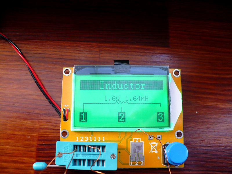

        • What are the parameters of the coil? What is the resistance and inductance? It looks like the resistance was too large. If 100k is too small, add additional resistances in series.
          • Originally posted by viwaldi View Post
            the inductance is- 1.70mh and 3ohms(coil1)
            = =- 450uh and .6 ohms(coil2)
            when testing inductance between 1+ and 2+ terminals the meter reads a combined total of 3.31mh and 3.6ohms
            so not that far out but maybe could be tuned better, but I would have expected it to work.
            its the pot adjustment not changing voltages that is driving me crackers.
            • I think that the L1 resistance is too large and you have a problem. Insert the 100k resistor as I wrote and check. Or change R2 to a larger one and also check.
              I did chemelec's versions and the coil had smaller resistances. I had to greatly reduce R2A to work.
              Images relate to the coil of post # 608. Nupi org and nupi chemelec work without any problems.
              The C1 and C2 capacitors are also key. MUST be MKP.

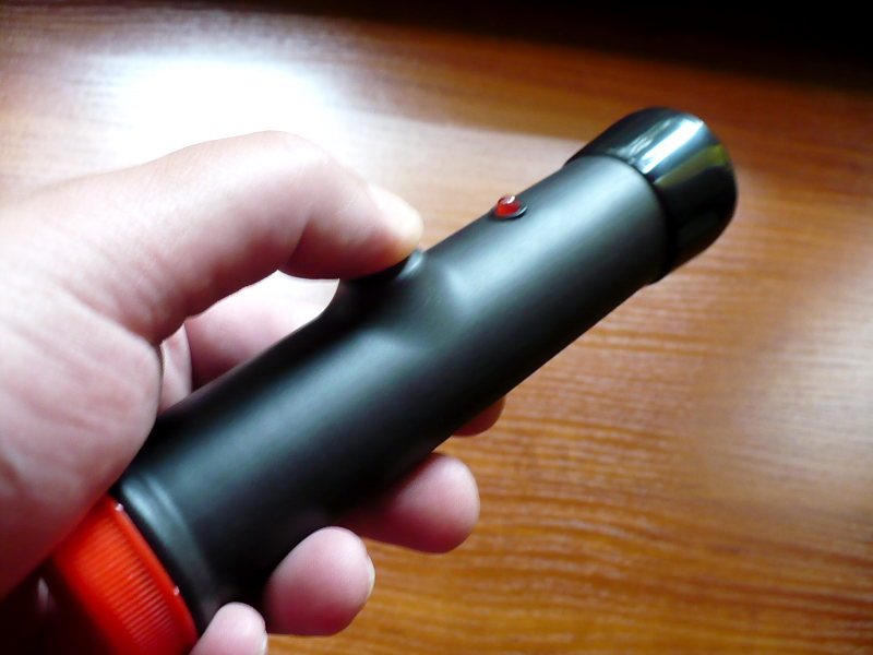

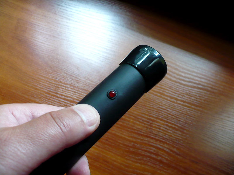

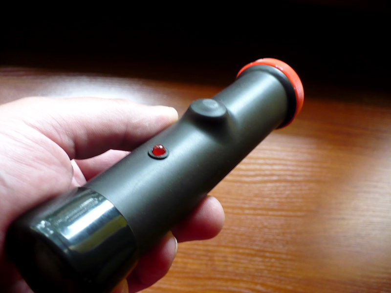

                          • New NUPI. Coil on ferrite from the anti-seize filter. Dimensions: 18 cm x 3.2 cm.

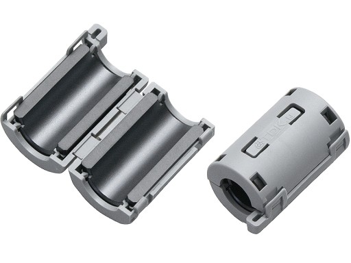

                                I had a similar situation - stirring the pinpointer under pressure. it was a ferrite wine. I bought ferrites from old radio antennas. the coil's housing was thick. she did not bend while searching. it was enough to change the ferrite and the pin started working normally. Wound the coil on OTHER Ferrite and check. you can use ferrite from an anti-seizing filter.
