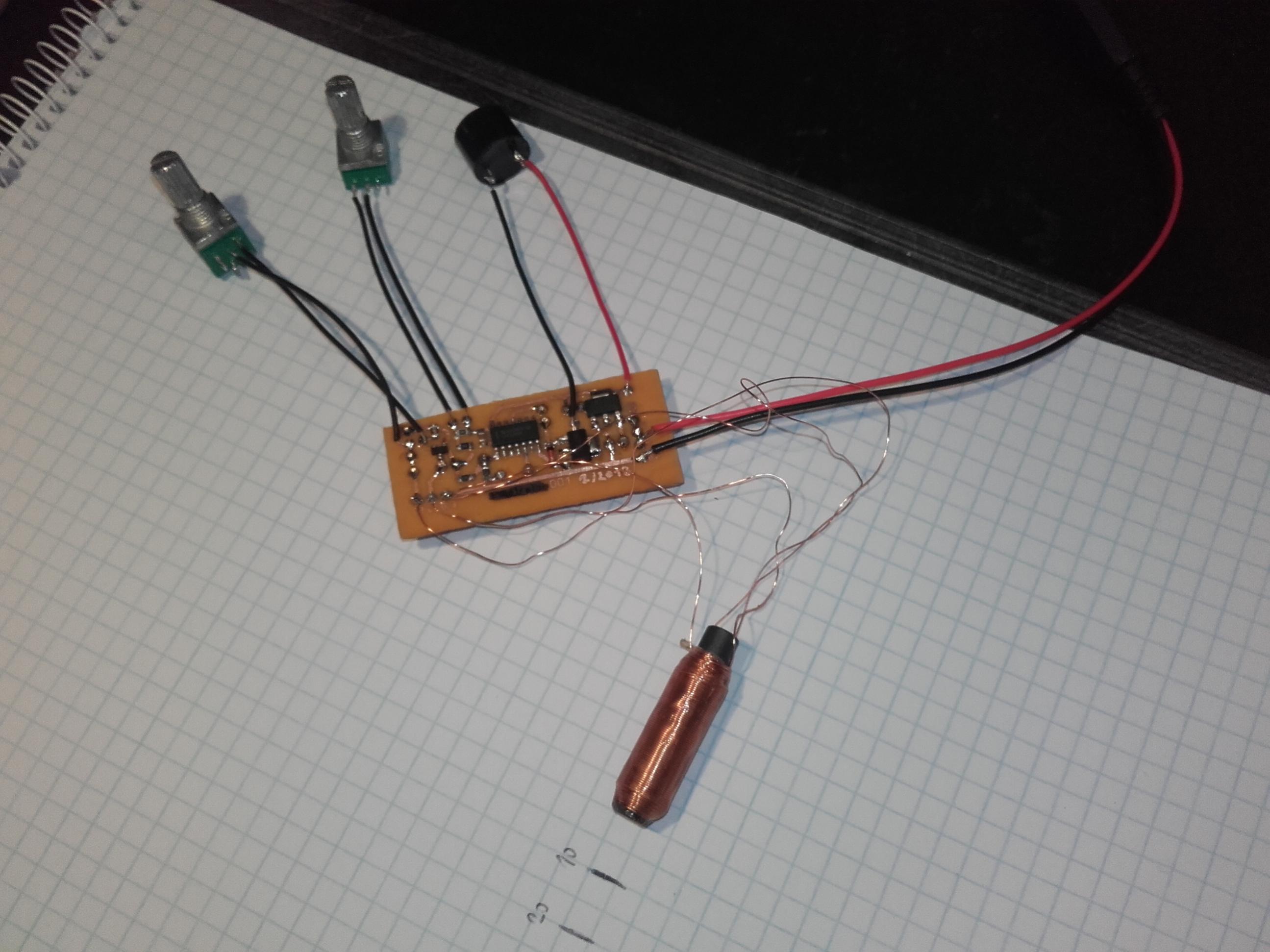

          Coil winded on small 8x30mm ferrite rod from ali. ~700uH and ~2,5mH. I use drill for winding these coils, hold ferrite on few mm and wind tightly to end and back. Second coil is twice the same process, so in the end there are 6 layers of 0,3mm wire.

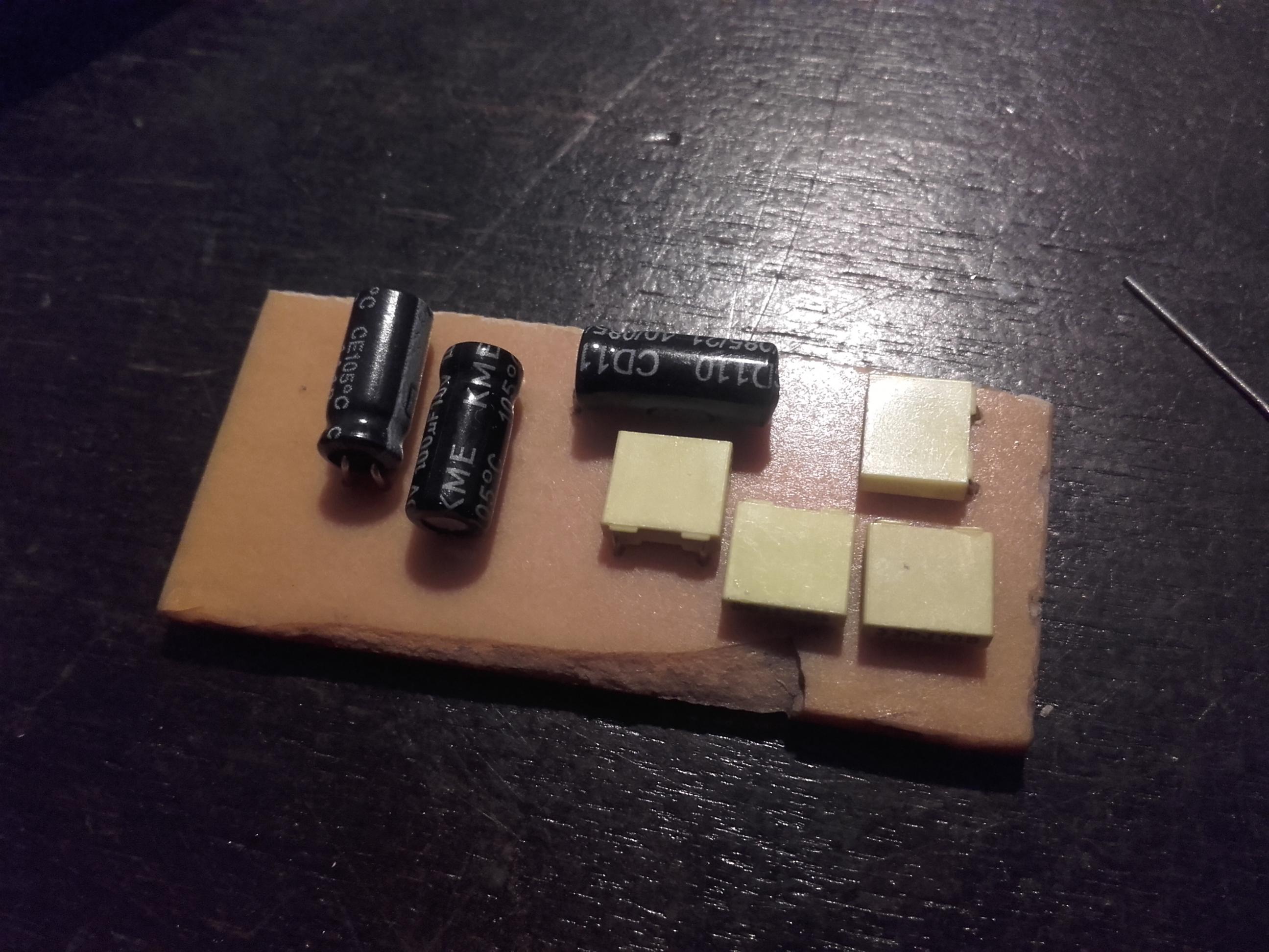

          Sensitivity drift over time, but slowly and for me its absolutely usable. Maybe coarse potentiometer could be trimmer or just a pot on board. I drawn board in SMD except elyts and few caps (I only added bypass cap for 4024 and omit 22uF cap for buzzer, also changed 78l05 to asm1117-5 with drop voltage 1V to be able using 2 lithium batteries). I etched it by myself so I made just contact pads to avoid unnecessary drilling. I do not have MKP, stable enough for me... Size without potentiometers is only 45x20x10mm! Able to detect coin up to 5cm. Sucks from 2mA while silent up to 60mA while screaming.

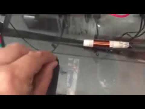

              • I finished my pinpointer.
                Thanks nupi and chemelec friends.
                This schematic used.
                https://www.geotech1.com/forums/atta...0&d=1493827365
                https://www.youtube.com/watch?v=7uK7uc2OAmg

                  • And when the rod rotates in space, isn't there an erroneous detector response?
                    (rod looks long)
                    • Northfinder pinpointer pro.
                      • Originally posted by Eddy71 View Post
                        (rod looks long)
                        Hi Eddy71,
                        I haven't seen such an error yet. I will continue the tests.
                        Ferrite rods 1cm diameter and 70mm long. L1=1,6mh L2=0,330uh
                        5,5 cm under the brick 1 coin detect.
                        • A long rod works well on a table if it is not moved in space.
                          I've seen errors when the rod moves up and down, right and left. The magnetic field of the earth has a strong effect on the long rod.
                          • In the F-Pulse/TekPoint I used a 9x65mm ferrite rod, or something like that. With bipolar pulsing to cancel Earth field there is no compass effect at all. Probably will get similar results with monopolar pulsing and an EFE subtraction sample.
