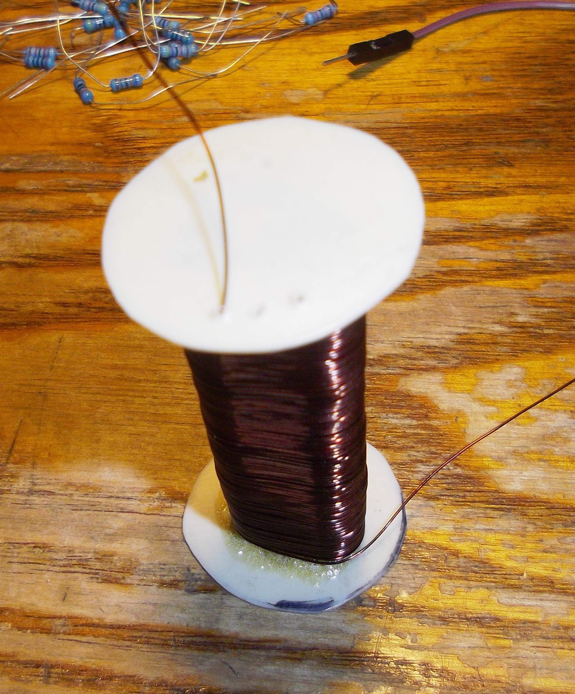

  • Also attempting to make a NUPI pinpointer here, my progress so far has been:

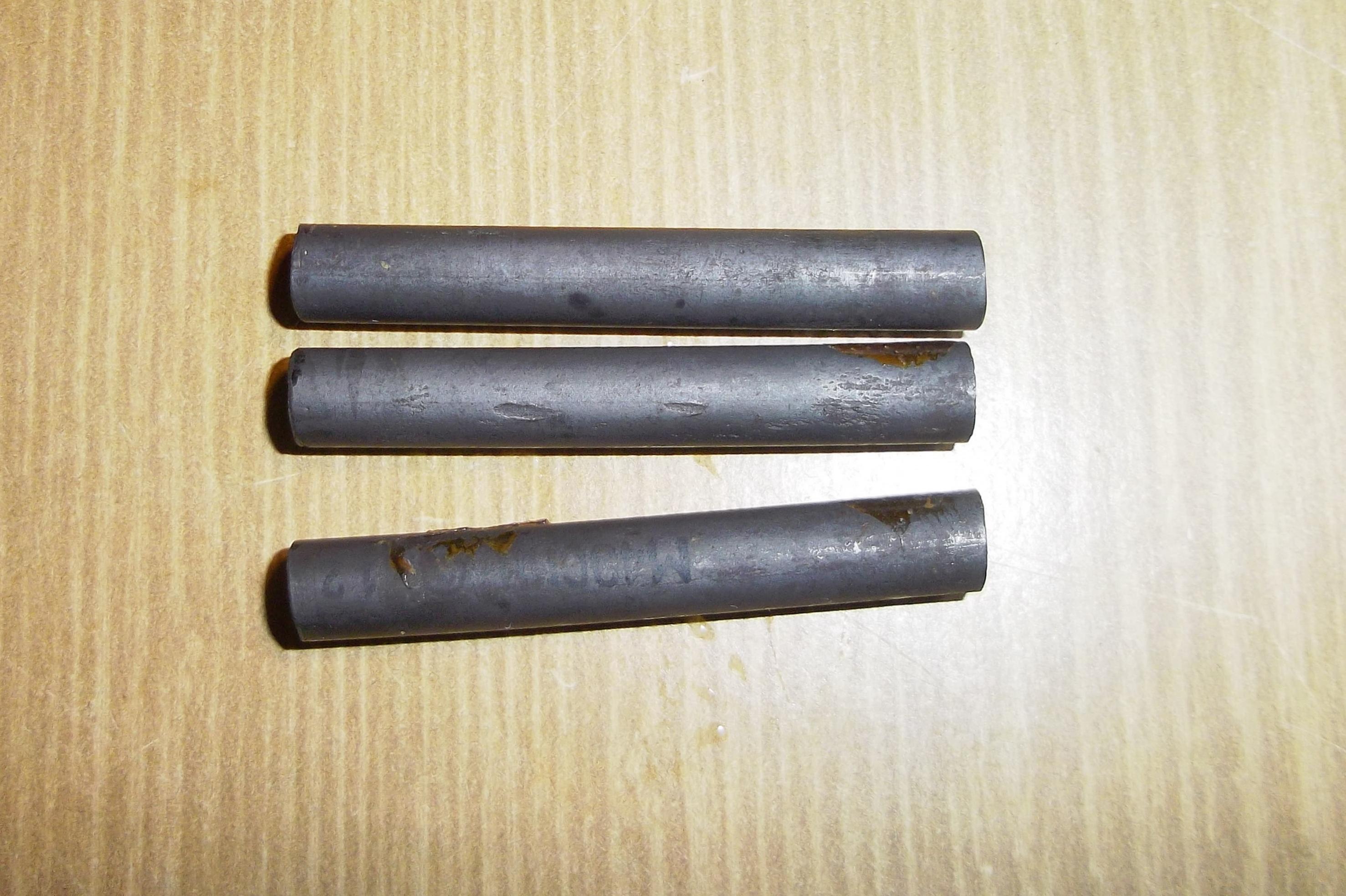

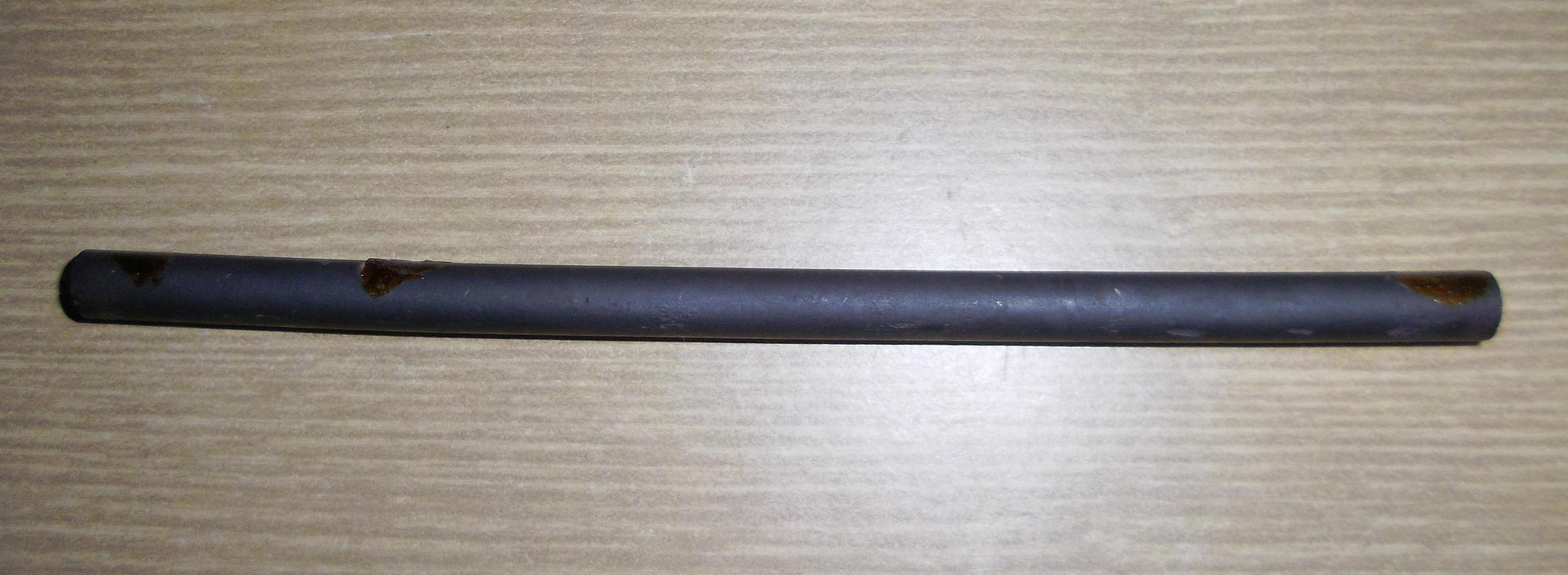

ID:	357442 - 8 mm x 160 mm "400НН" NiZn ferrite rod from Урал-112 radio
ID:	357443 - cut into three 53 mm long pieces by filing a groove around the rod and snapping

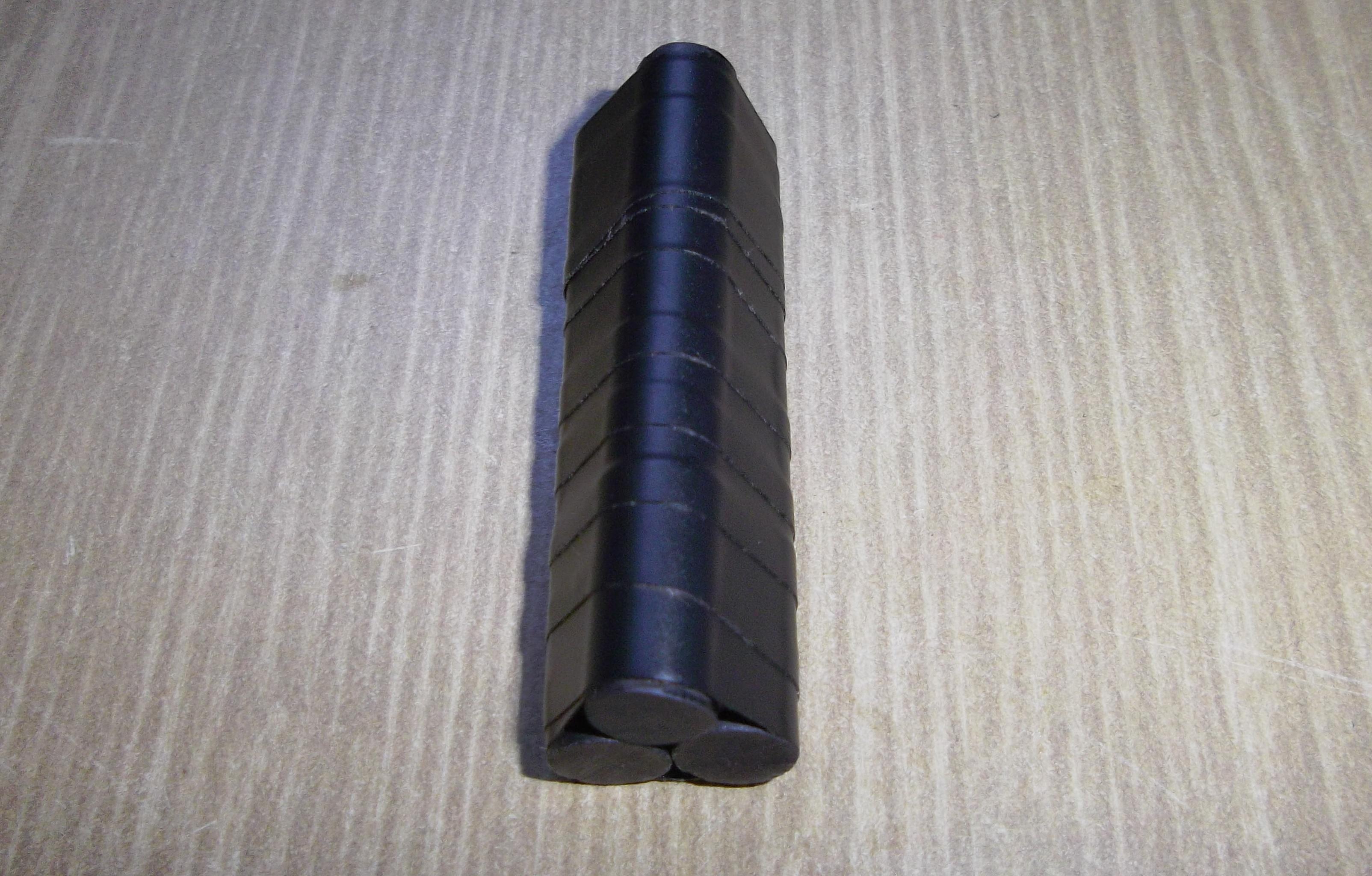

ID:	357444 - cores taped together with electrical tape

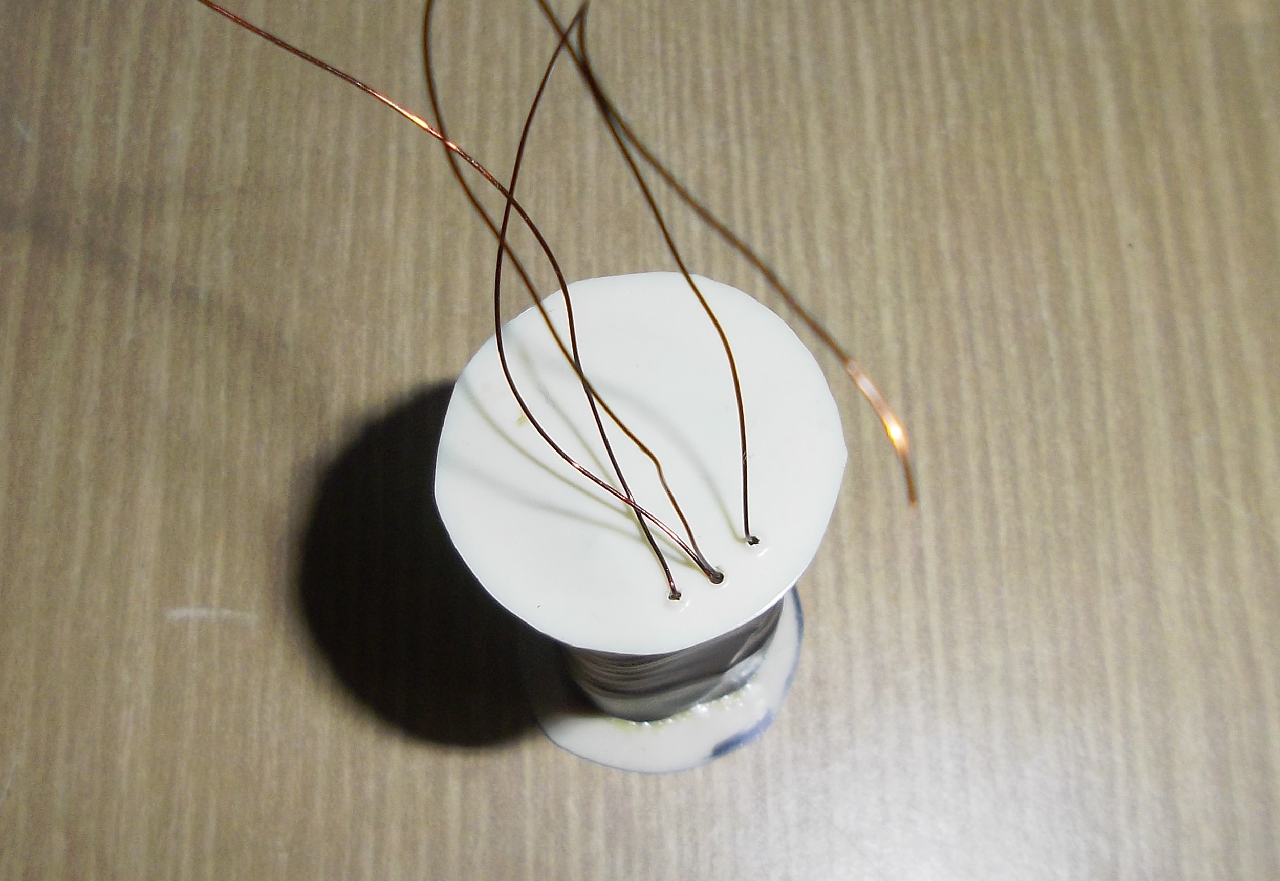

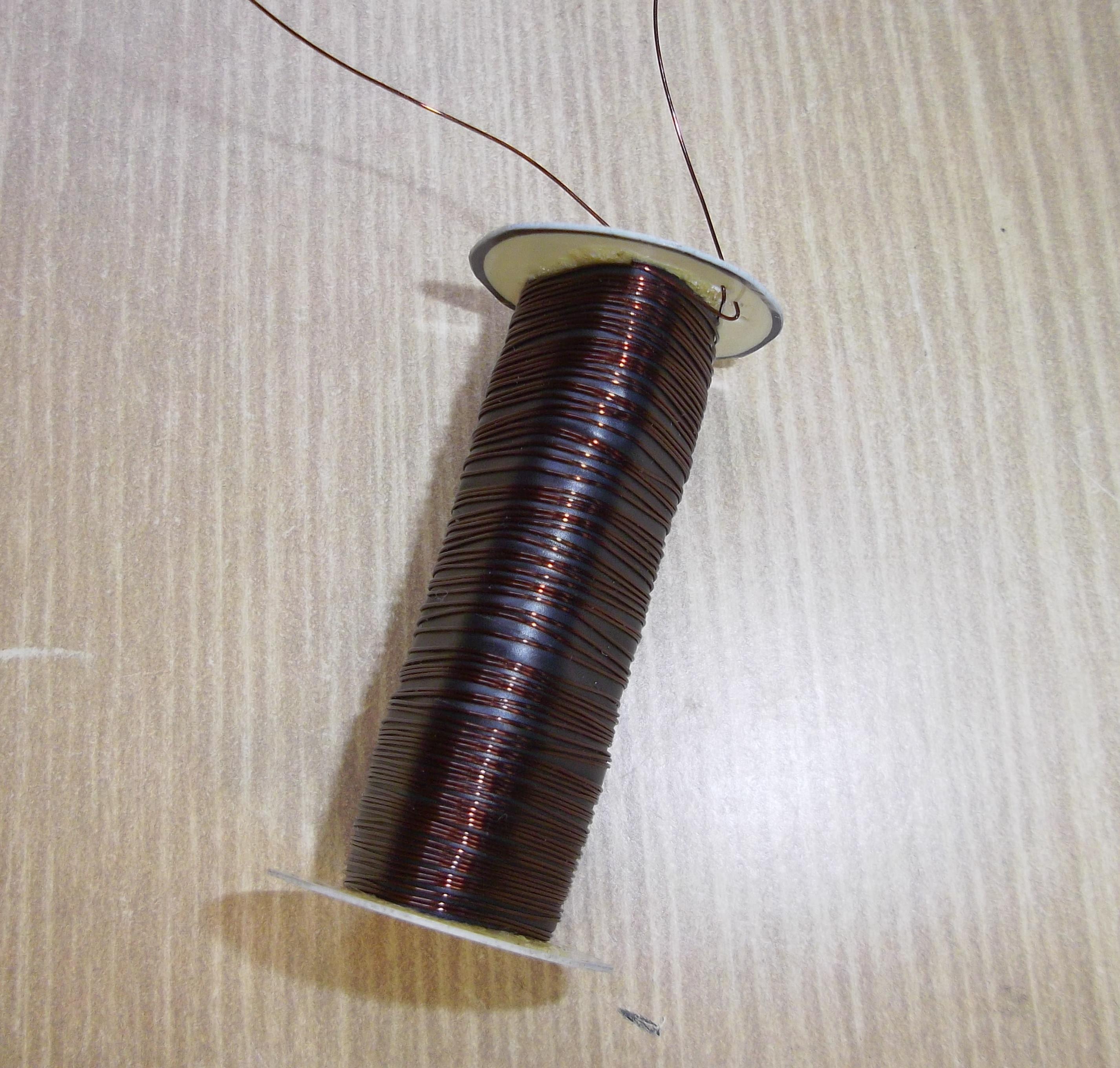

ID:	357445 - first layer 104 turns of 0.32mm wire
ID:	357446 - second layer 79 turns of 0.32mm wire = total 183 turns in L1 giving 1.56 mH
ID:	357447 - third layer 100 turns of 0.32mm wire giving 0.42 mH, combined whole coil inductance 3.57 mH, coil finished

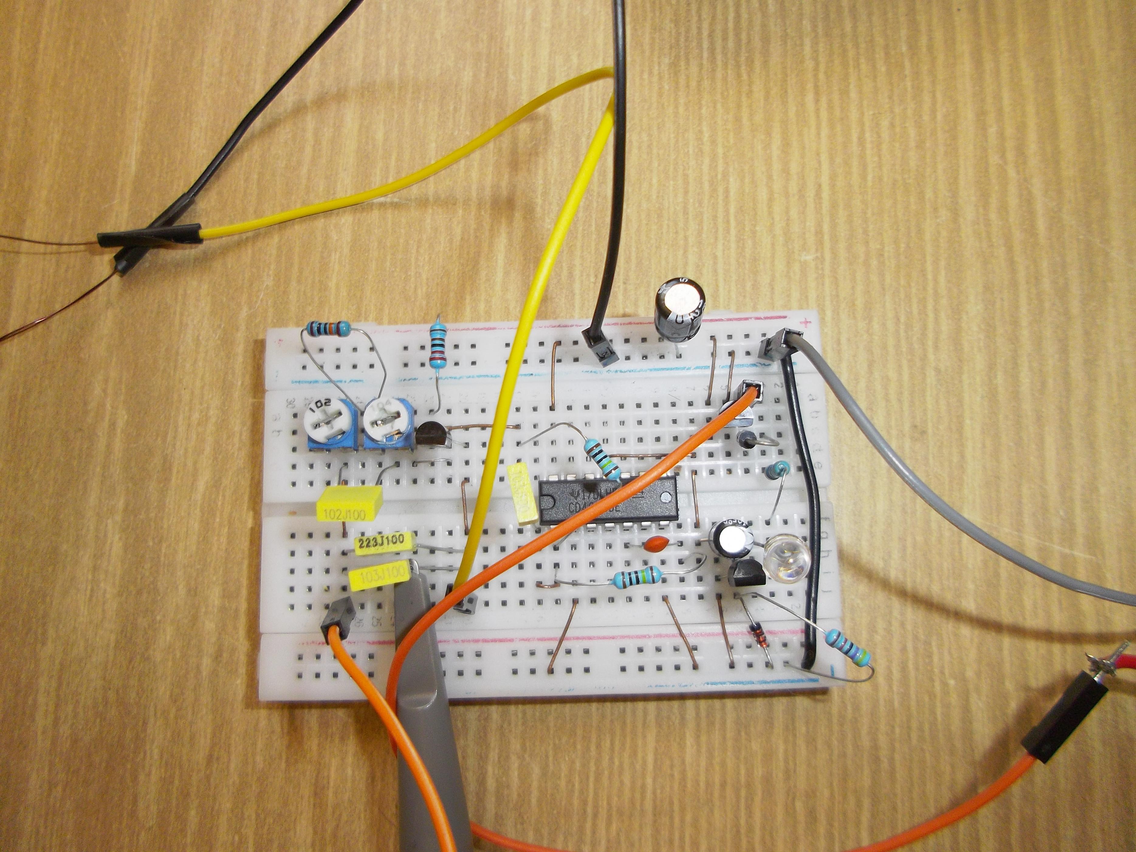

ID:	357448 - wired up the NUPI FINAL 2014 circuit on the breadboard, with some changes due to available components:
    LM2931-5.0 regulator for low dropout
    TR2 is S9014
    TR1 is S8550 with beta of 260
    100k resistor in series with the pots to find the correct bias point which turned out to be 136.6k
    C4 is 2.2 nF ceramic
    C3 is 10 nF polypropylene
    C1 is 1 nF polypropylene
    C2 is 22 nF + 10 nF polypropylene in parallel

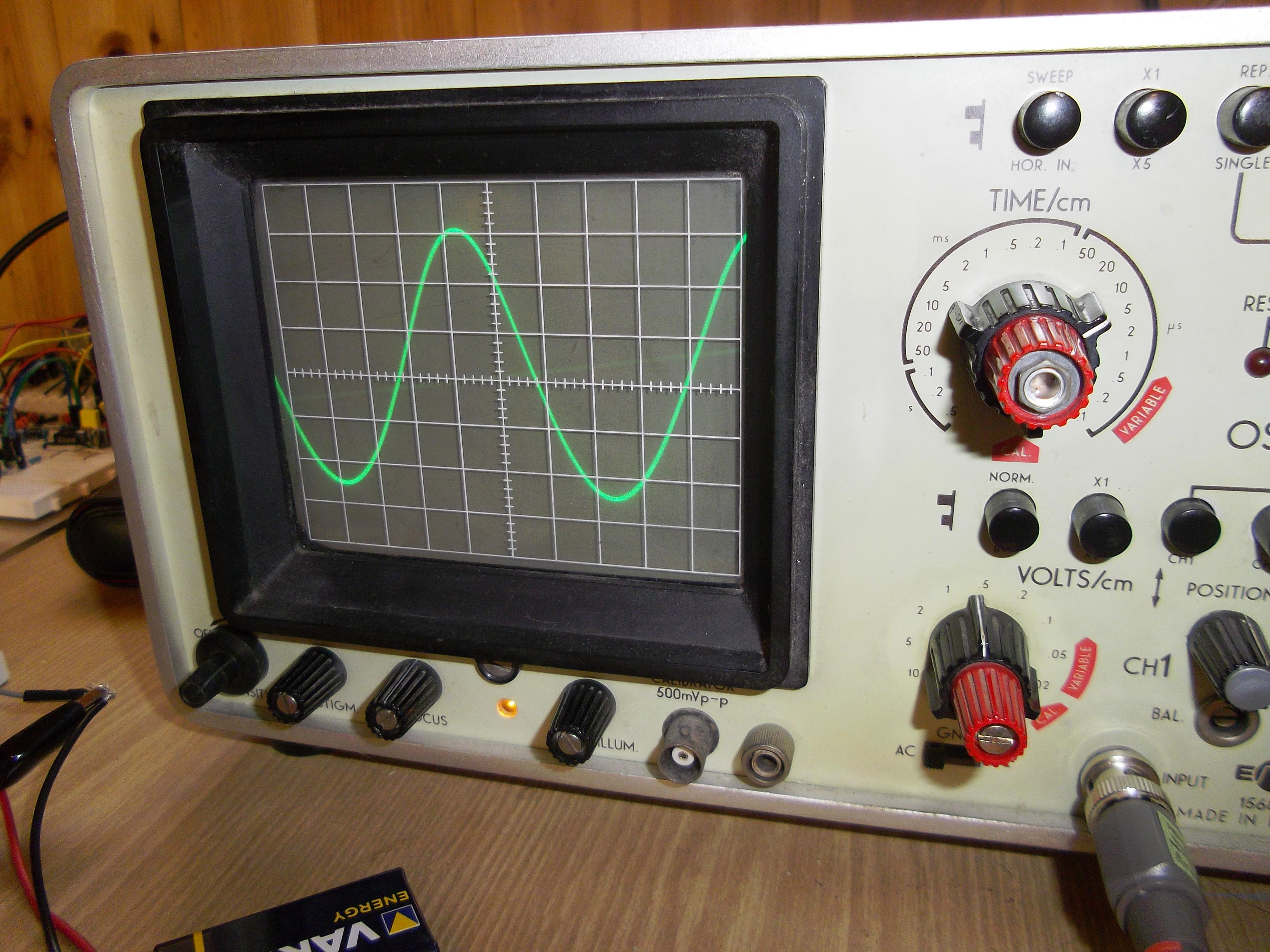

ID:	357451 - nice sine wave on L1, frequency approx 15.3 kHz
    Really impressed with the circuit considering the low amount of parts. The sound is very nice. The power consumption is just 1.2 mA with no metal around. But the PC buzzer takes 80 mA at full blast. That'd be 0.7W from a 9V battery! Sure doesn't sound like that. Must be possible to reduce. With loose balancing I detected 1 euro reliably from ~5 cm. With on the edge balancing more is possible, but I didn't bother yet due to higher instability/drift.
    Also I checked on the scope that if I put a metal object closer to the coil the oscillator amplitude decreases and beeping starts. If I put a larger object really close, then the oscillator collapses and the sound stops completely. Any way around that?

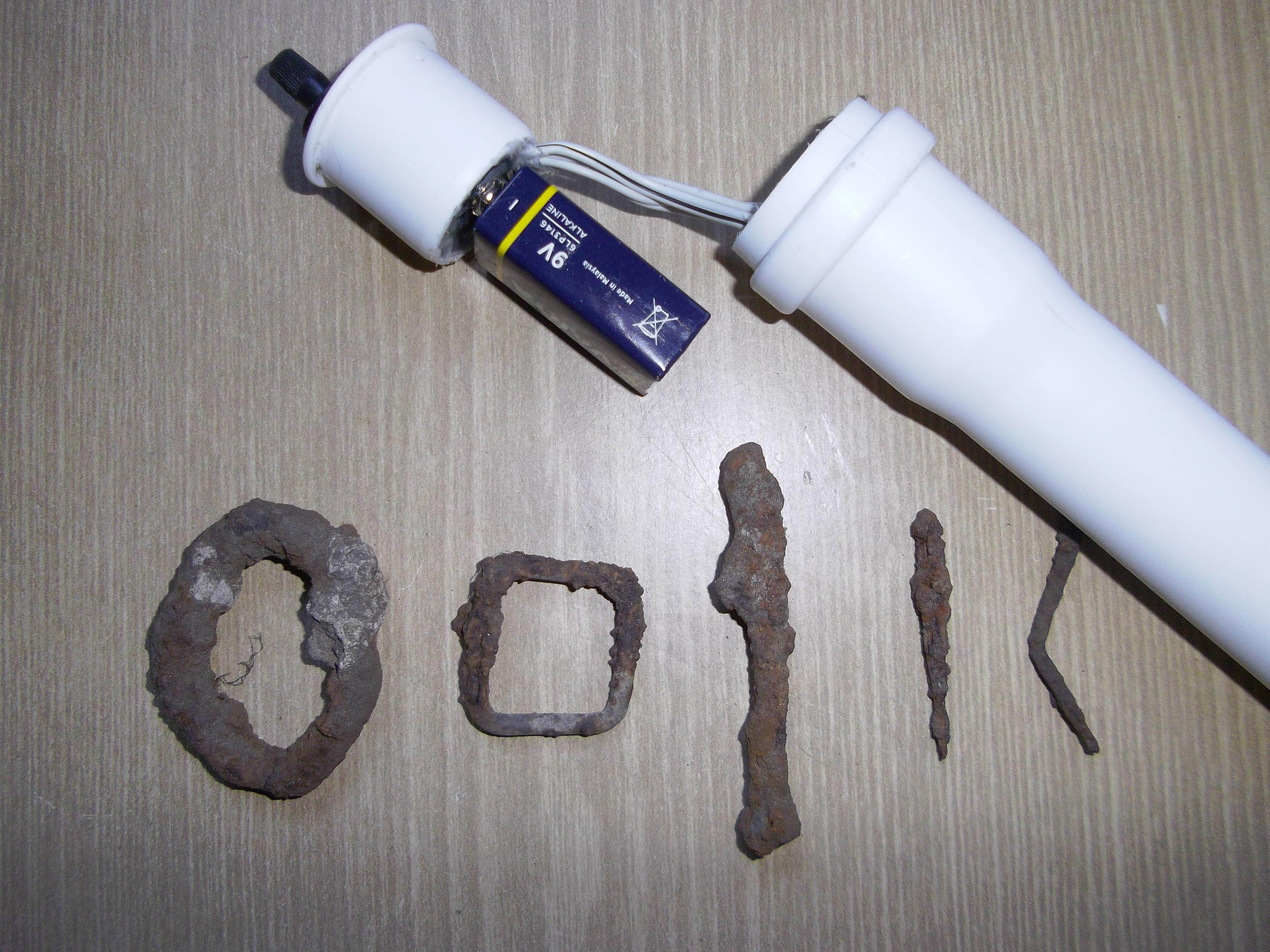

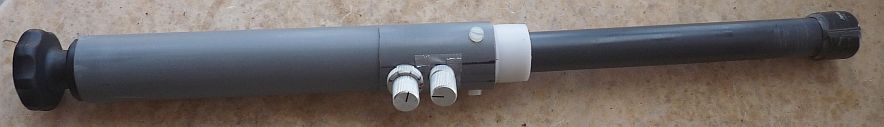

      • Now that I have measuring equipment and more experience, I have revisited this project.
        Made a new coil to the NUPI uH specs by measuring whilst using the Chemelec schematic.
        This pinpointer runs extremely stable, compared to the ones I made before.
        Running at ambient 35?C whilst lying in the sun and tested in the fridge at 4?C.
        No more sensitivity to movement in the air when waving around (compass effect).
        No more reaction to probing pressure in the ground.
        Distance for a nickel is about 2 1/4 Inches.
        Not as far as the previous ones with optimal bench conditions, but waaaay better out in the field.
        No more constant adjustments of a finnicky little critter.
        The ferrites I have used now are NOT from am radios.
        They are from inductive welding. 5cm long x 9mm diameter in this case.
        I have also NOT potted the ferrite coil in the pipe this time.
        Its "suspended" in the pipe with two wound foam strips front and back of the ferrite.
        So the ferrite is now mechanically decoupled from twisting, bending, pressing when probing.
        Have also used proper pots instead of the tiny 10 turn ones this time.

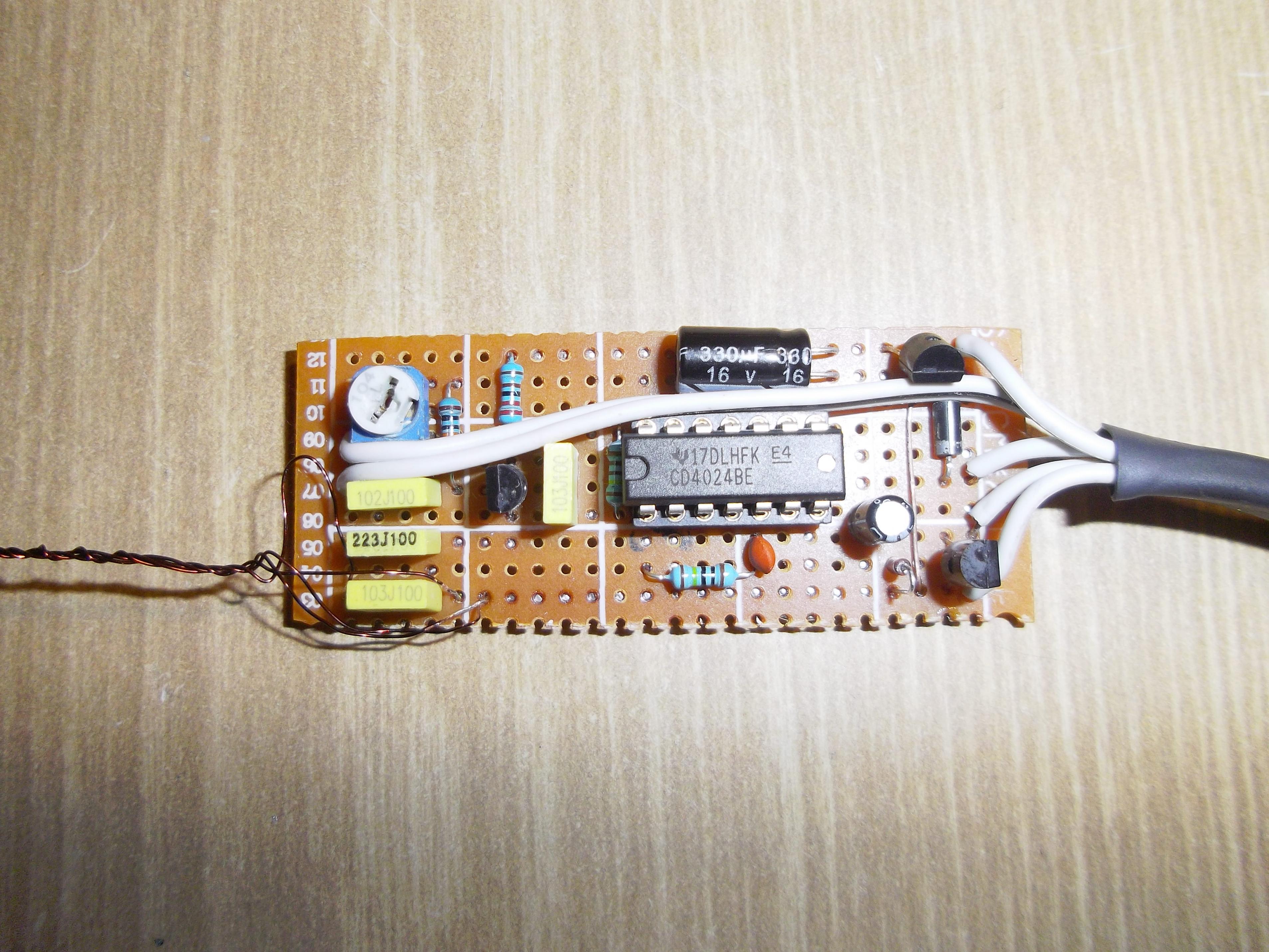

              Is this the one
              https://www.geotech1.com/forums/show...205#post231205
                Yes, thats the one!
                You can leave out the 22uF capacitor parallel to the buzzer.
                I have used the 68k Ohm resistor and a 10k Ohm pot for coarse adjustment with inbuilt power switch.
                The fine adjustment is a simple 480 Ohm pot, no parallel resistor.
                Your needed resistor adjustment values will vary with the 4024 ic used.
                Its all mounted on simple strip-board.
                Good Luck and enjoy!
                I will be travelling and using this pinpointer intensively the next months. I will see how it holds up.
                Quick photo of mine: Click image for larger version

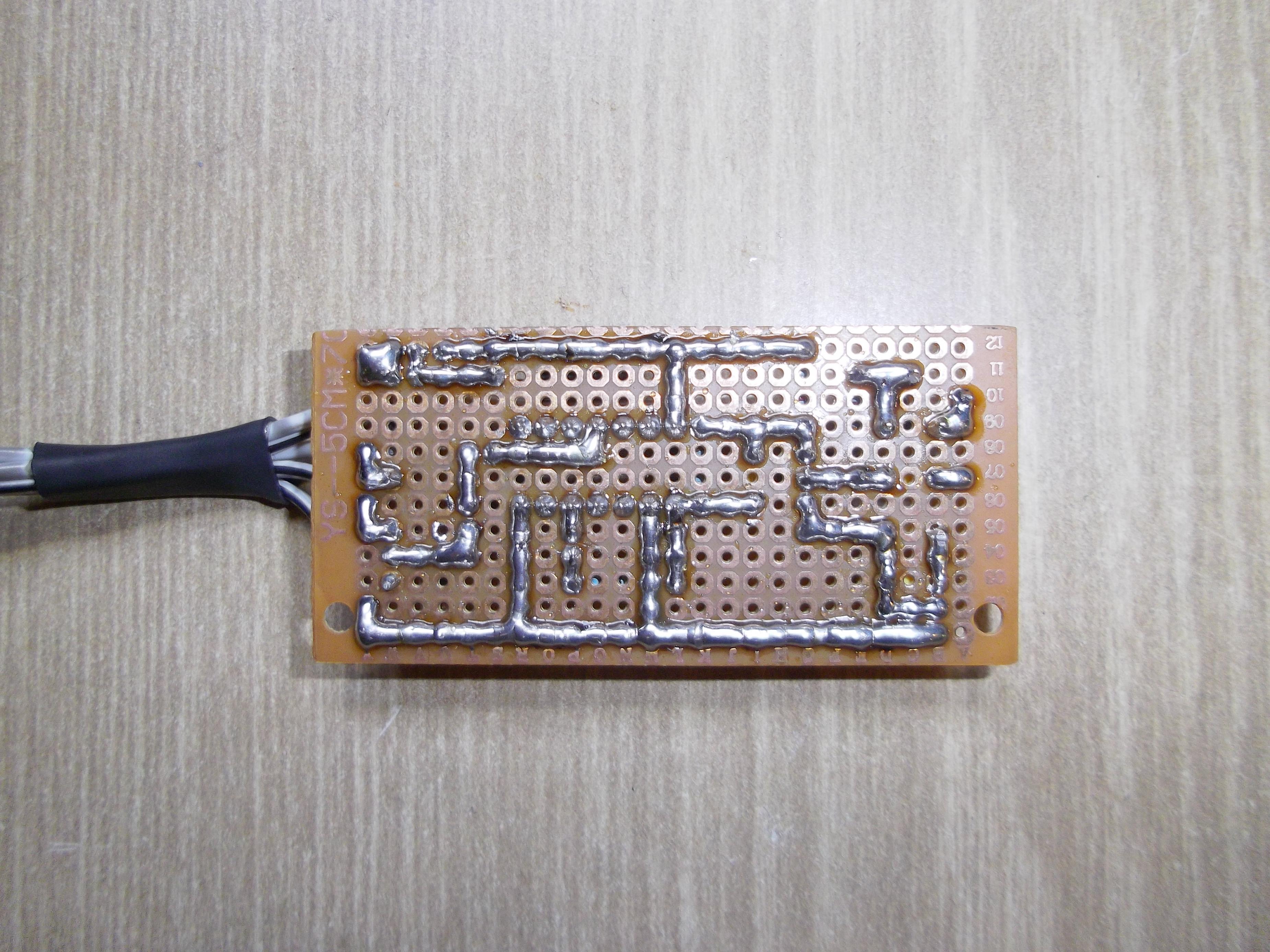

                                I built a perfboard version of the original NUPI circuit so board is not the problem. Attached a few pictures including some of my finds with solely this pointer.
