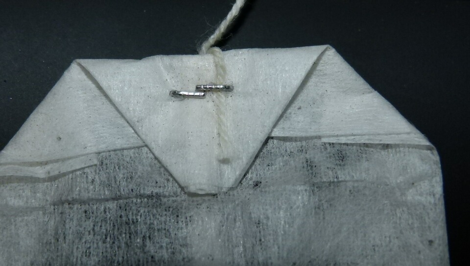

  • For the ultimate sensitivity-test all you need is a teabag!
    If your Pinpointer detects the 5mm iron clip it's really good!
    The Garrett-Pro-Pointer only reacts if its modified and set to
    highest sensitivity while directly touching the coil-housing.

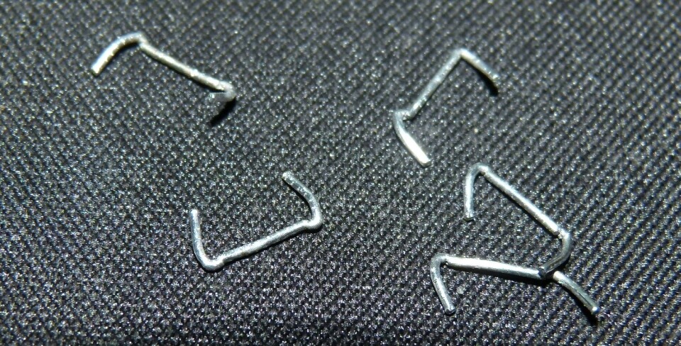

      • You are the profi - you have checked it perfectly!
        The consumption-date was: best before 2011 !!!
        See jpg!
        You need 6 bags in 1 l. water for still getting some taste!
        btw. the clips are already aluminium - said the magnet test.
        Sorry, I don't drink much tea but herbs-liquor, its much healthier !!!
        I can recommend Jaegermeister, Fernet, Ouzo, Raki and Mastika!
        Just the best herbs there are inside and not like caffeine containing chai
        which just makes everyone nervous, hyperactive, unruly and sleepless.
        I hate coffee, tea and nicotine !! This is only cheap "opium for the people" -
        seducing the mind so they are paralyzed enough for accepting every crap!
        Most poeple take this as some sort of Red Bull or Coca to have enough power
        for getting over the hard working day, but all this freaks up their brains, too!
        Drinking tea is for old people to stay awake when death calls for: eternal sleep!
        But if you'll wait 7 years until the caffeine is deactivated and everything tastes moldy,
        you might can enjoy some interesting drink - if you use at least 6 tea-bags!

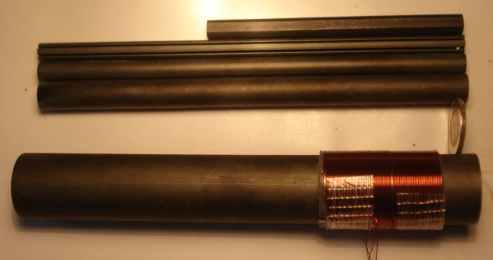

          • NUPI PP thermal drift
            I measured the needed adjustment of potentiometer R1 to get back to the tipping point in respect to temperature.
            It's roughly +500 Ohms/°C with 3 ferrites in my setup.
            I thought a simple linear ptc in series would do the trick and couldn't find one with such high ppm values.
            Put many of them in series I thought. Aaah f**k, they combined have a much higher base value than the pot R1.
            That path doesn't work here. So I dug a little deeper.
            Here are some temperature basics I came across for the components involved:
            Component change ppm/°C Values are not precise, ballpark figures (sorry about the formatting, can't get it to work properly)
            Metal Film Resistor +- 50 to 100 (It's sort of a U-shaped curve)
            Trimpot Cermet + few 100's
            Copper wire (R) + 3900
            Ferrite low f +500+- 100's
            Ferrite high f +30 to 100
            Transistor Si -3255 (or given as 2.1mV/°C) ???
            MKP Capacitor (PP) -300
            FKP2 Capacitor (PP) -200
            Polyester Caps (PE) +200
            Where to begin? I don't understand how the analog side NUPI PP really works, so I feel lost
            at how to really go about this. Here's some other things that came up:
            Since my NUPI PP beeps faster as the temperature rises I'm assuming that “C1 + C2” values are dropping,
            causing the frequency to rise. A polyester cap might be better here instead of MKP,
            if higher dielectric absorbtion is no issue. Is that line of thought correct?
            The two "strongest" factors here appear to be the transistor & coil windings.
            I have read that a matched transistor pair configured as a differential amplifier
            can solve thermal drift problems (not perfectly, but substantially).
            Could this be a feasable possibility within this circuit?
            I may well be mistaken with my thoughts and it may be something completely different.
            You are all welcome to give your input, corrections and insights.
            Last edited by Polymer; 12-10-2016, 07:39 PM. Reason: formatting went crapola, can't correct it

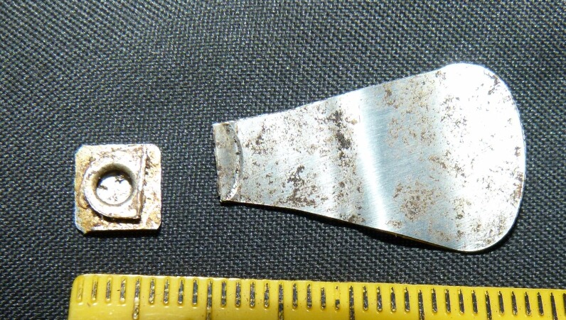

              • Here's another test-object:
                The "bolt"-region of a pulltab, 6x6 mm aluminium.
                I've found it with the Makro Racer (standard coil) 50 meters from a highvoltage line -
                5 cm grass & 5 cm buried. 3 meters away I've got the missing part of this thing, too.
                The Garett-Pro-Pointer detects this 6 mm alusquare at 1 cm distance
                normally, but already at 4 cm with modification set to high sensitivity.
                Which means that the Pro-Pointer is pretty useless without modification
                because if such a piece of metal is just 2cm away, the Garrett no longer
                finds it !!!
                And now we all wanna know from what distance the Nupi PP detects it!

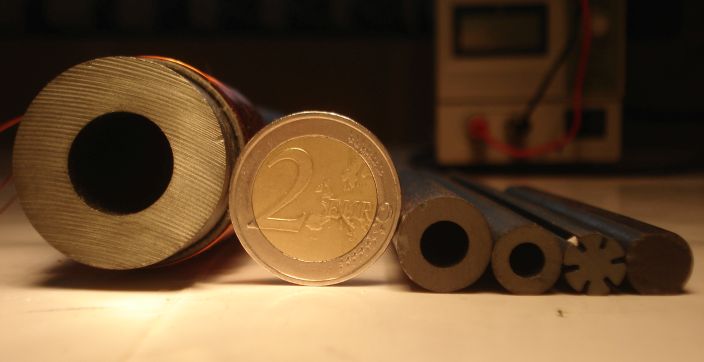

                        Here photos of ferrites I could not put in PM - Only the URL thing shows up there !??????.
