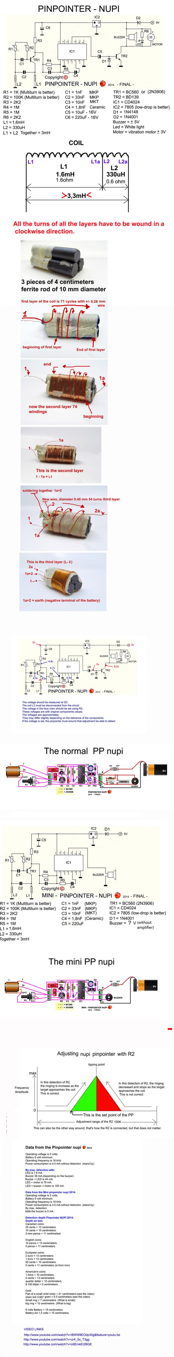

        ToddB66 said to me, that he found the data from the pinpointer confused.
        He has absolutely right, I've messedup.***
        I often (I mean to frequently) made mistakes.
        That's why I post all the data of the PP together.
        I hope this time without error.
        Hey Nupi, in the drawn picture of the coil in post #410, you have L2 as 330uH, but in the text you have L1 as 330uH ????
        your picture did not attach to this quote.

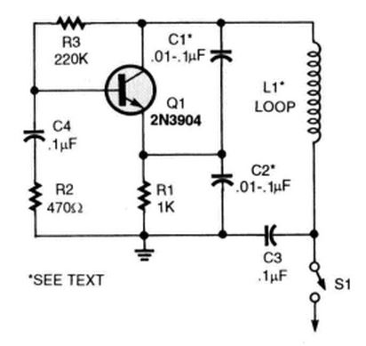

          • I've built similar things for fun in the past. Some ideas to avoid the constant whine produced by such a circuit (some of which I have tested):
            A simpler (single coil - no tap) oscillator running at around 200 kHz (similar to this):
            Program a PIC to capture the rising edge time from the output from the counter and produce an output when this signal drops in frequency.
            It can be coded to capture the no-metal frequency of the signal by pushing a button near ground but away from metal and this value is then used for the comparison when detecting.
            The colpitts oscillator is quite stable in practice but adding a FET buffer to it before taking the signal to the counter helps improve stability.
            Alternatively, build a 4th order (or better) analogue filter designed to pass only frequencies below the no-metal frequency. Two Sallen-Key op-amp filters in cascade should do the job.
              Thanks, You are absolutely right.

                            • Hello Nupi,
                              I am absolutely thrilled with your design and really appreciate and adore your step-by-step picture instructions!
                              Yes, yes, yes! I will be building a Nupi-Pinpointer
                              I do have a few questions though, argh:
                              Are the tolerances critical for R's and C's. Would it be better to use 1% resistors and 5% capacitors instead?
                              Could i use one piece of ferrite with 19mm diameter instead? Or perhaps asked better: how critical are the dimensionalities
                              of the ferrite core? I'm asking because I would like to make do with what I can get here locally.
                              An absolute heads-up on your construction
                              • Originally posted by Polymer View Post
                                Hello Nupi,
                                5% resistors can be used. The value of the capacitors are critical.
                                You can do some differ from the values but you need to know what you are doing.
                                You can use a different ferrite if you keep to the inductions.
                                You will need to use an induction meter.
                                If you can not build the same as in my example then I can unfortunately not give you support. Sorry!
