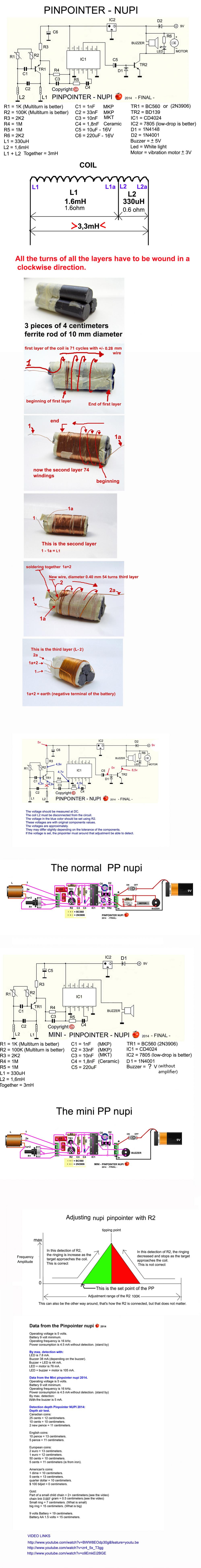

  • C7 gets charged via R7, from top to bottom, and when it passes ~2.5V U3c and U3d toggle by means of a syncing circuitry. D3 accelerates discharging for the purpose of repetitive use. This circuit is a timer that switches from stabilising stage to the active stage.
    Nupi, this schematic is built in ExpressSCH which is a freeware, and often used here.

          • ToddB66 said to me, that he found the data from the pinpointer confused.
            He has absolutely right, I've messedup.***
            I often (I mean to frequently) made mistakes.
            That's why I post all the data of the PP together.
            I hope this time without error.

              Is any problem when I use the TLC271 instead of CA3140? Should I change maybe C9?
              • TLC271 has an unique feature: a bias select. So you MUST connect pin8 to a steady voltage, in this case connecting pin8 (bias select) to a non-inverting input pin3 is OK. Connecting pi8 of most other opamps will result in things unexpected. CA3140 has no such quirks, and I found it cheaper locally.
                • OK, thanks, I've started to mount, wish me luck ......
                  • Good luck
                    You asked about C9, and maybe it'll require some extra care. There is a dependence between C7 and C9 regarding a timer period and reaching stabilised conditions, so perhaps C7 may need increasing. I designed these to reach a solution in ~1s.
                    I expect TR2 to be sufficient for reaching a solution. Expected behaviour is: "click!beep... beep-beep-beeeep (ready) ....." or "click!beep... beep-beep-beep-beep-beeeep (ready) ....." and the number of beeps in a row is set by TR2.
                    • Thanks for the info, Can you look at two same-numbered resistors? Number 10 is 2x. one of the drain and the other U2 pin 3. Could you give me another number?
                      • Nice catch, let the upper one at pin 3 be R18. Value is OK.
                        • OK, done.
