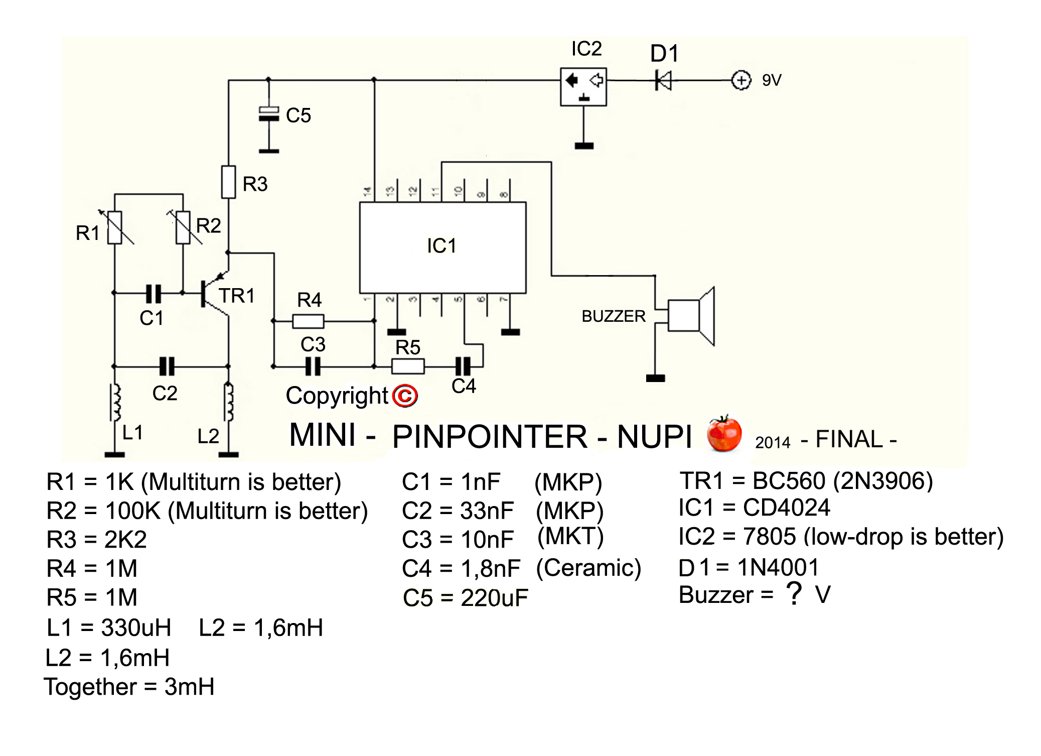

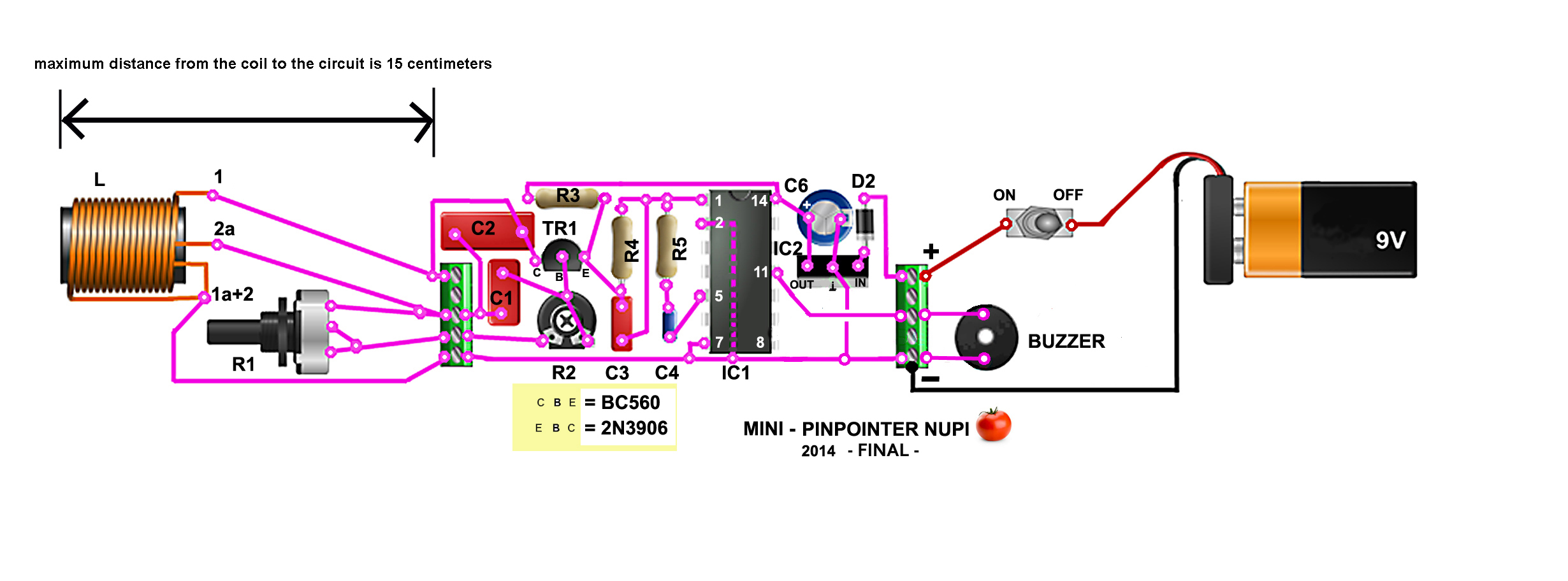

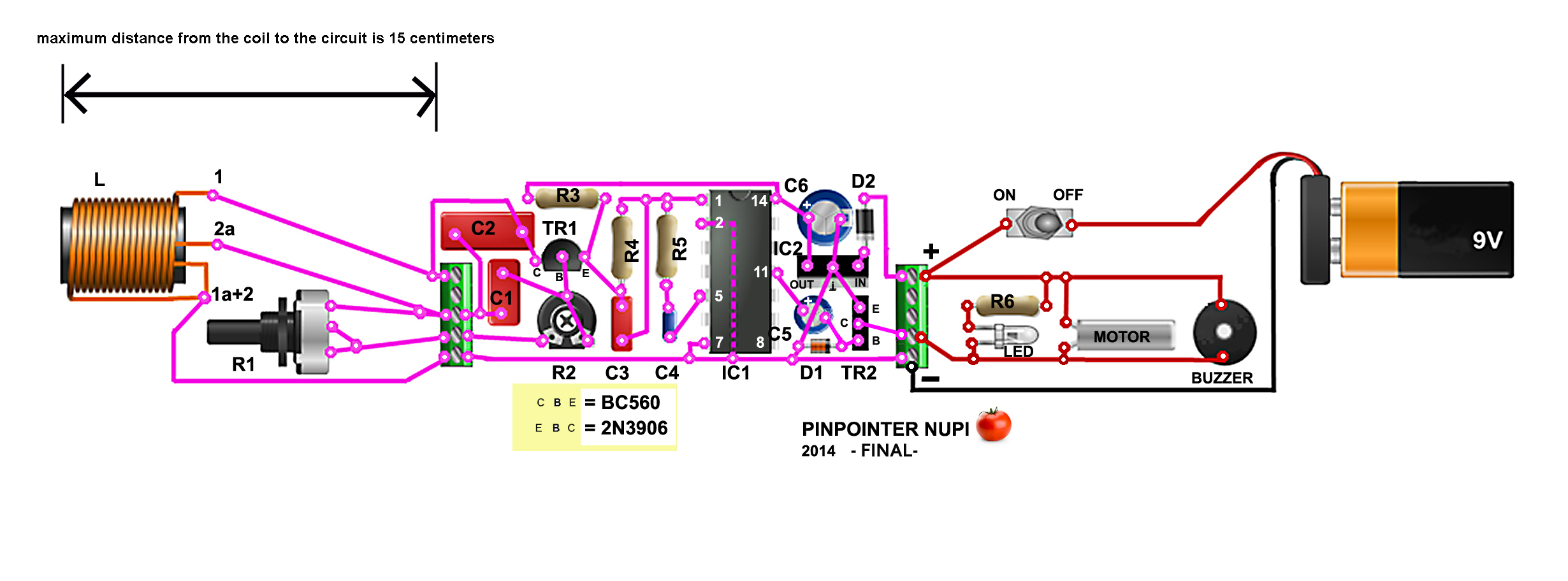

Hi Thomas, very nice work.
I just hope it works well in smd.
This circuit is simple but is sensitive to the type of components you use.
It can happen if you use another type of transistor TR2 can do less well (or better
). It took me many hours to try different parts But as I've said it's a prototype,
so maybe it can be improved.
I've never tried the Circuit itself in SMD. I think it's a good technique, but I can not.
I've tried it several times but My hands are shaking too much.
Maybe it's because of too much tomato sauce in my head.
So I'm glad that others will try.
Can you explain us the advantages of the two front to front diodes?
I'm fascinates if anyone has built the circuit.
regards.
