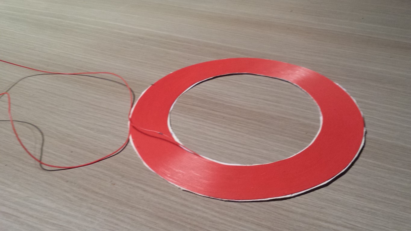

thanks for the info (again)! I'm waiting for parts to arrive so meanwhile I made a few more coils. My best sensitivity for a one euro coin is almost 30 cm with a flat spiral coil (inner diameter 13.5cm; outer diameter 21cm; pvc insulated wire, see picture). I noticed that the initial beep, when powering up the device takes a lot longer to fade out compared to the normal bundled enameled copper wired coil. Can someone explain why this happens? I'll try to update with more pictures/video this week.
