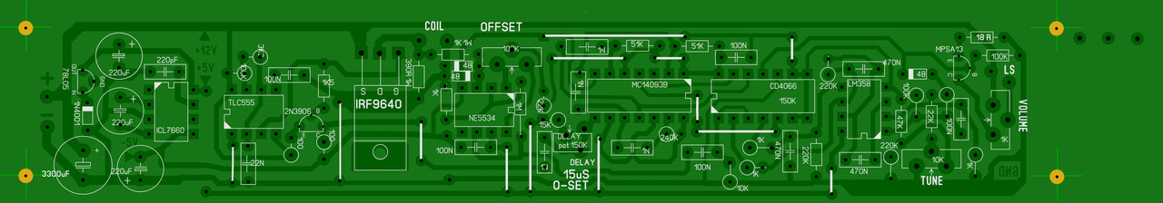

          hello sir. I ask for help, I am a beginner trying to make 2 Surfpi units but it seems all fail. i am not good in electronics components, i have checked the path and the component makes sure it is in place properly.
          The problem that I experienced when I turned on Surfpi was a 1x beep sound.
          and when the sensitivity pot is played, it will always make a sound, I mix it by turning offest a silent sound is obtained but cannot detect objects on the coil that I use 320uh. please help, thanks in advance

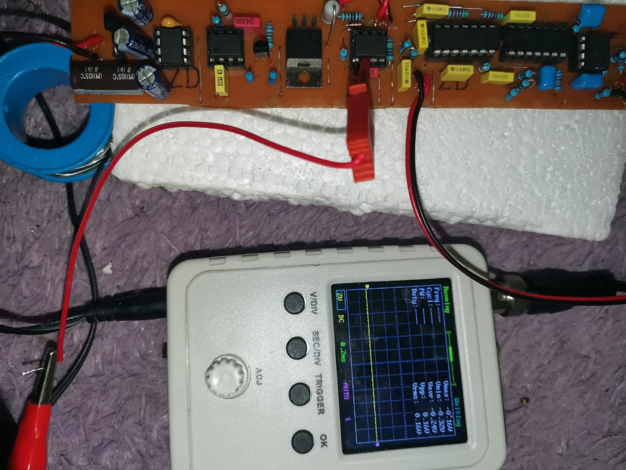

          this image :
          back
          front
          ne5534pin6
          tlc555pin2
          tlc555pin3
          tlc555pin7
            previously i used a buzzer sound audible. then I replaced it with a speaker but there was no sound.
            I tried to change the MPSA13 but there was still no sound, I have a multimeter. and mini oscilloscope but I don't understand what to measure using an oscilloscope because I just have it,
            on the U4 ic CD4093 I didn't see any waves with the oscilloscope

            U4 pin8
              U4-pin14 should be +5v
              U4-pin7 should be -5v (give or take)
              My first guess is the charge pump (U6) isn't working. Pin5 should be ~ -5v.

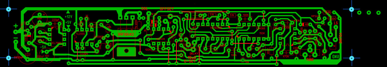

                    this is the schema that i use

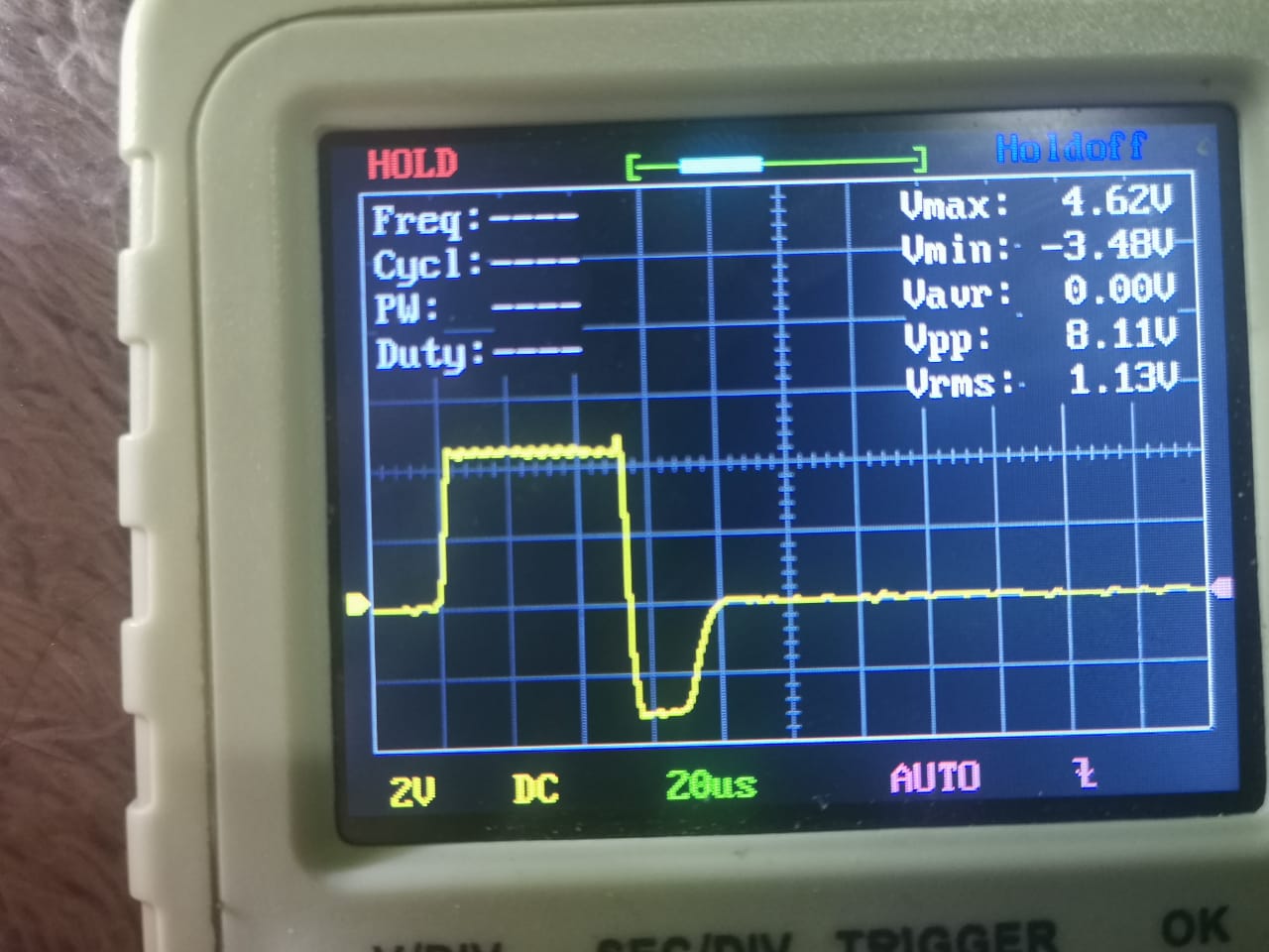

                      progress now if i set u2 pin 6 = -2.27v detector
                      and opening a little tune pot, can detect the hammer within 7cm
                      and the coin is only 2cm
                      If the pot is turned too much, it will make noise and cannot detect objects.
                      I have tried to replace U7 and U4 but there is no change in the detection results.
                      how to fix this problem

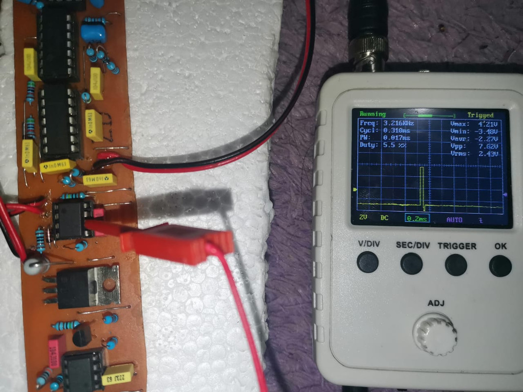

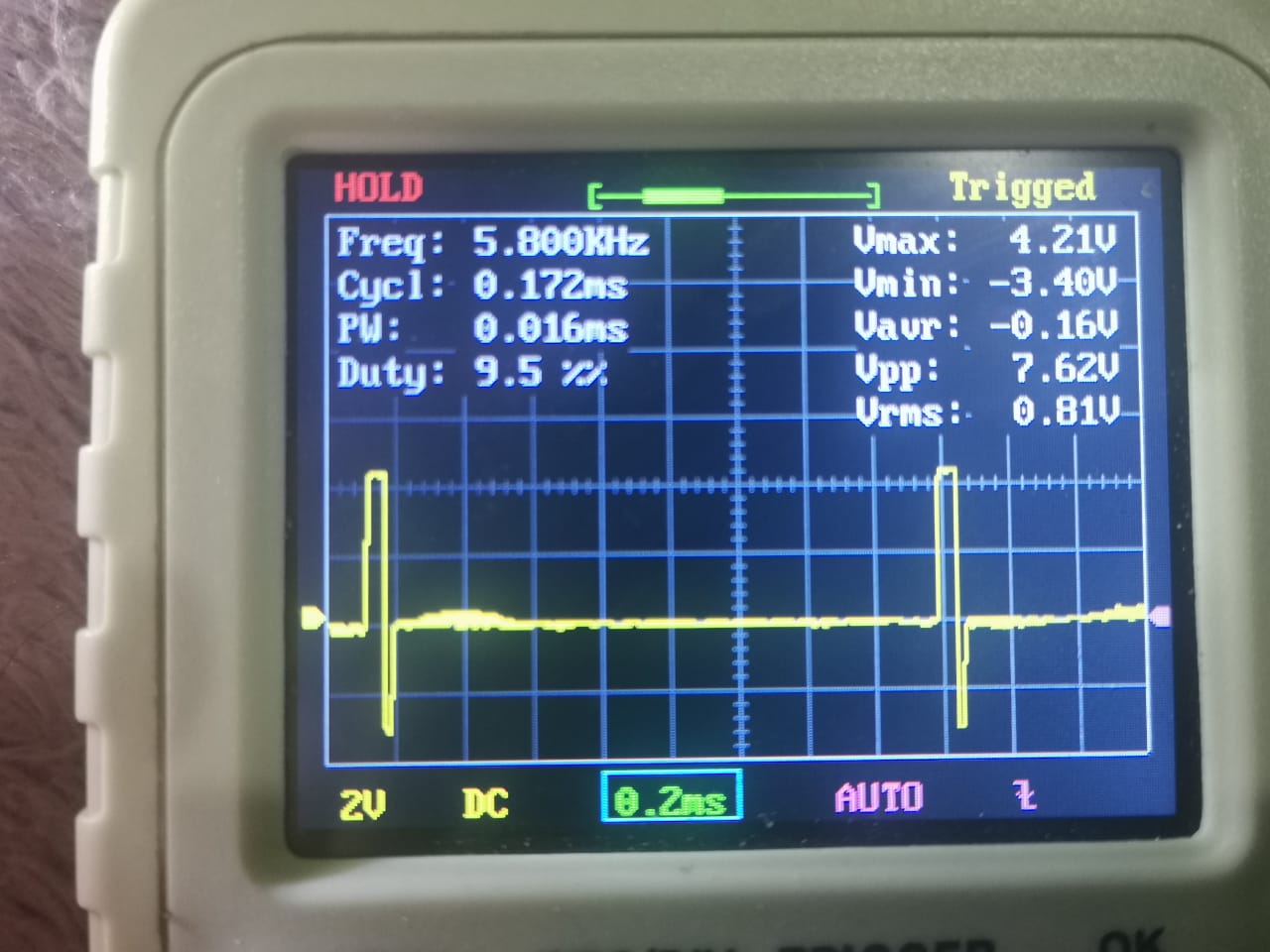

                      • #41
                        combine null o-scope's level to null opamp output's level (free part from the impulse) and give right pic. your pic is nonsence for me.
                        • #42
                          sorry sir. I'm sorry, I really do not understand what you mean "combine null o-scope's level to null opamp output's level".

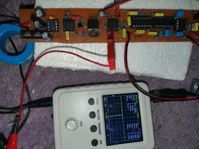

                          I don't have much electronics skills, please tell me which pin to measure. and what should i do
                          I measured connected to the ground power input and pin 6 on U2 (ne5534)
                          by turning the offset pot I can adjust the output on pin 6 from -3.5 to 4.1v
                          like this:
                          • #43
                            i wrote unright... do offset to nulling like you see on a pic.
                            • #44

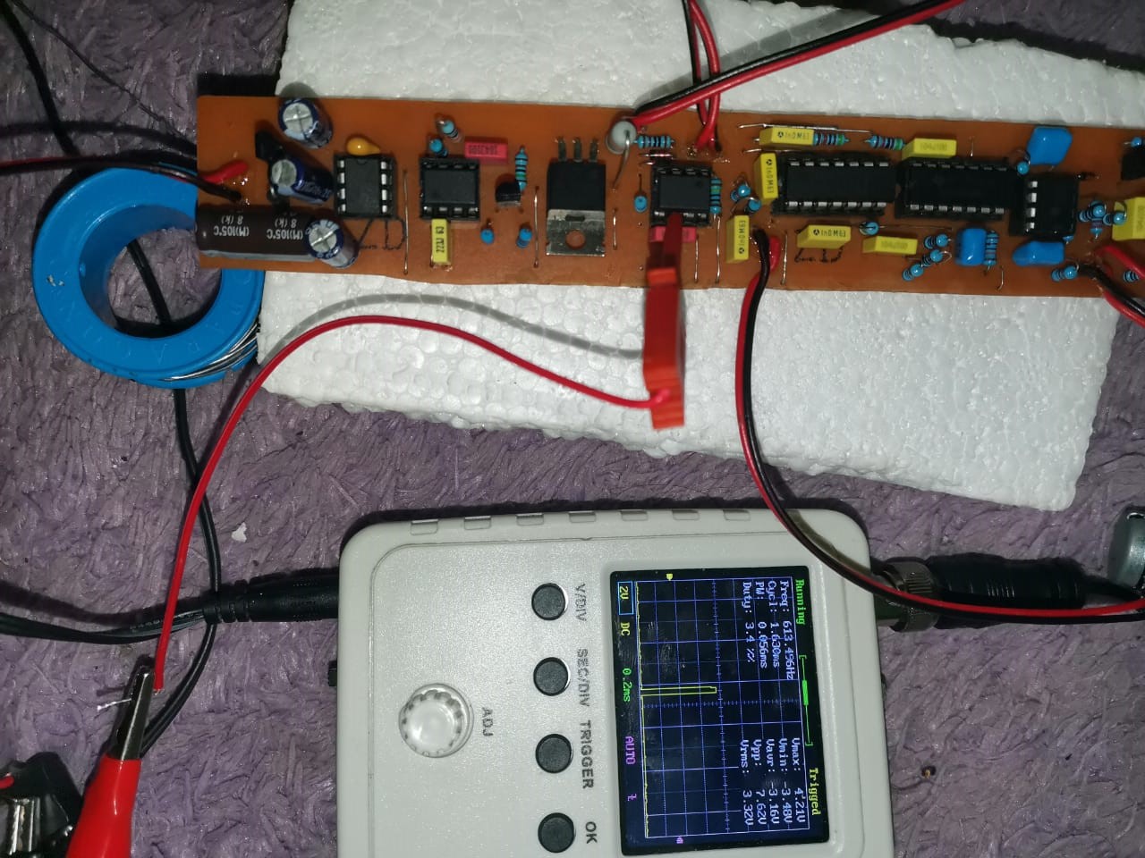

                                Thank you for the quick response, sir.
                                is it true like this
