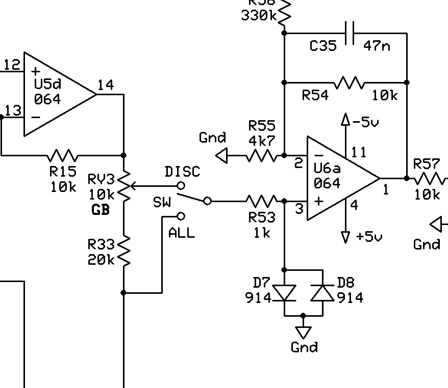

      It is okay !Click image for larger version
Name:	all metal disc.jpg
ID:	343466To see put works measure GND=pin 14 U5d voltage have to go to less negative and GND= pin 1 U 5a when the measure voltage rises positive !
      • Beautifully drawn schematic, Eduardo.
        Has anyone built up the timing/logic part of the circuit yet ? It would be good to see a timing/firing sequence diagram for this circuit. Like the one Jose did for the original GS. It would be a useful reference.
        • 6666; I share the "all metal, discrimination", published in the latest Eduardo scheme mode.
          I have my doubts, about the time/logic scheme, in both channels must be equal, so that R20 should be 240K.
          You probably have to invert the inputs 2 and 3 in the integrator "U3a".
          I think it is necessary to carry out the checks mentioned greylourie, to compare with GS4 times.
          Pay special attention to what mentioned in his post 212, Orbit, concerning how they should be the polarities of the voltages on both channels if everything is correct.

            It is okay ![ATTACH]33434[/ATTACH]To see put works measure GND=pin 14 U5d voltage have to go to less negative and GND= pin 1 U 5a when the measure voltage rises positive !

            • Orbit's design is a beautiful and interesting project requires attention and some improvements and will get a super detector, and indeed is a stable detector. Thank you for the effort Orbit
