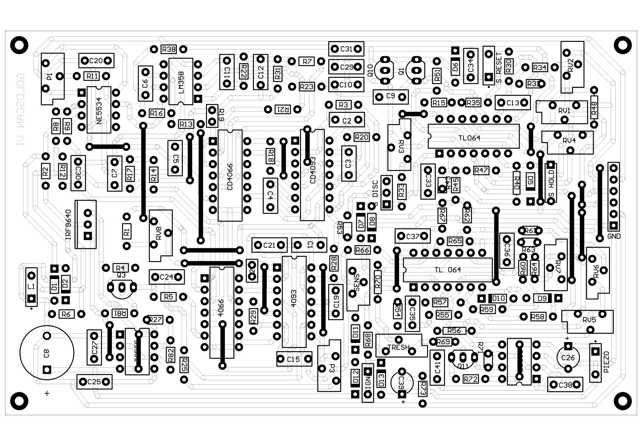

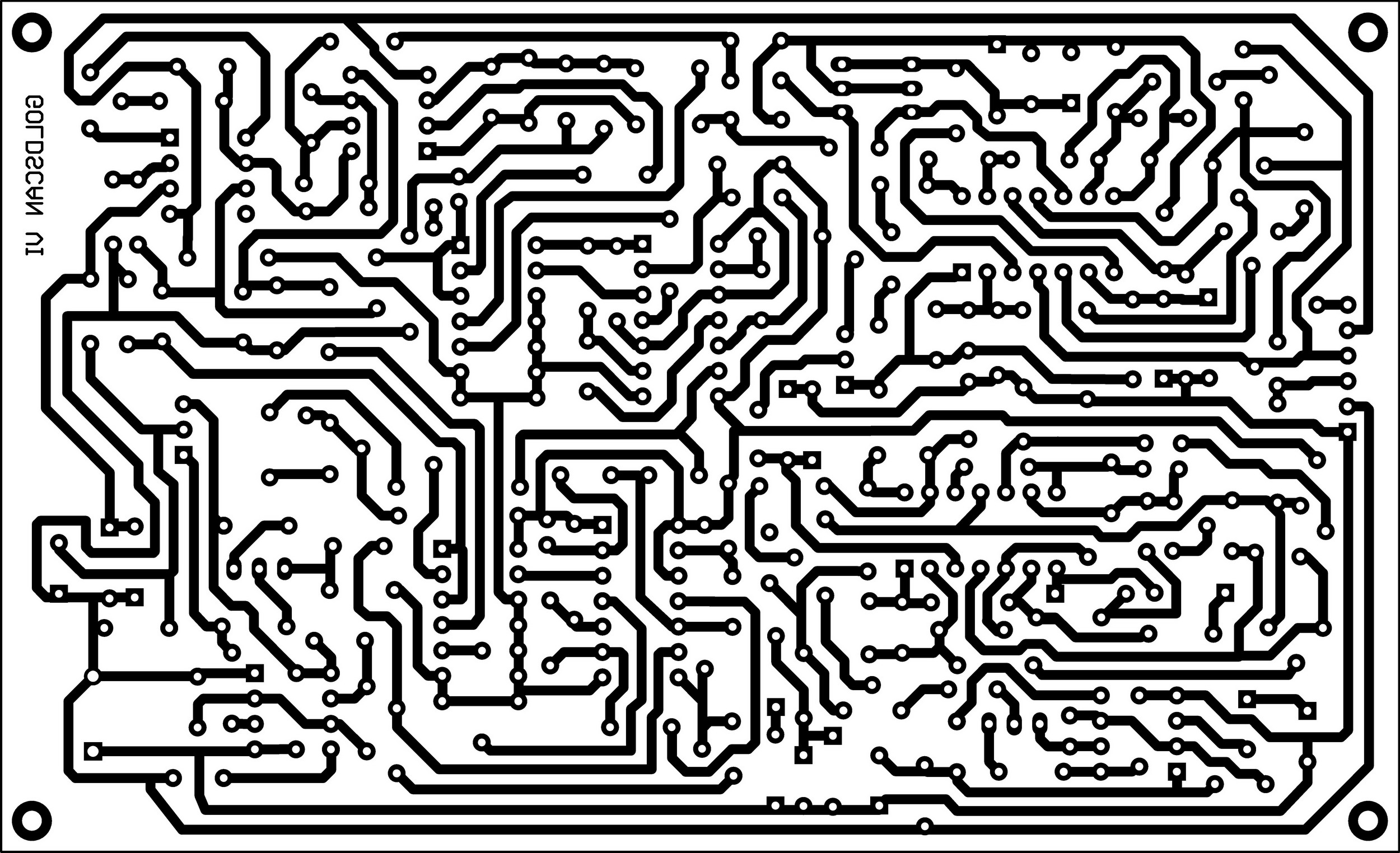

jeste plocica je radna verzija , osim sto ne ide piezo vec zvucnik od 8 r/ 0,25w

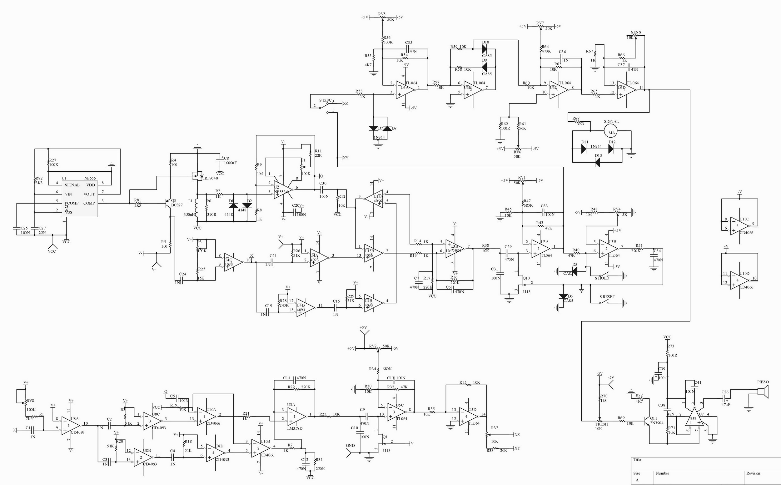

final project that I finished on 3 years ago .And much more stable of the original Goldskan 4.
between d12 and d13 the meter ,not mandatory .
I'll put that power It is in another hard disk .

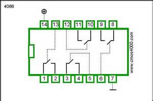

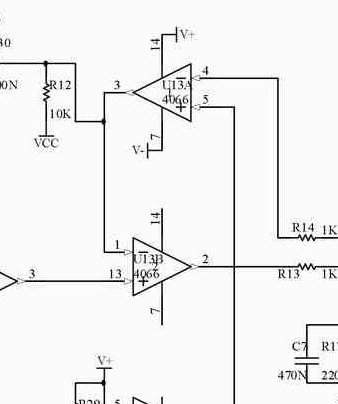

that what symbol ?that I that I in which I have worked I did not have a symbol for the gate so I put op amp .methinks mthat everyone understands the scheme If you want ! Simboli su stavljeni umesto simbola kapije simbol operacionog pocacivaca zbog nedostatka simbola kapije u tom programu za crtanje .

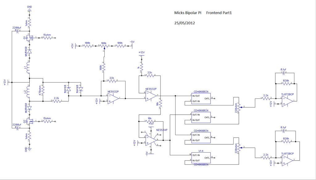

When this was over Goldskan 6 and that the three or four years ,You are doing this in 2012But you are completely clear so Goldskan 6 working and I have shared ,and where is your Completed Project Share it with us
They have been deleted. Were the videos, "Hibrid 2 pulse technology", and "Hibrid 3. pulse technology" = your videos ? It would be very interesting to see the power supply circuit. Thankyou.
