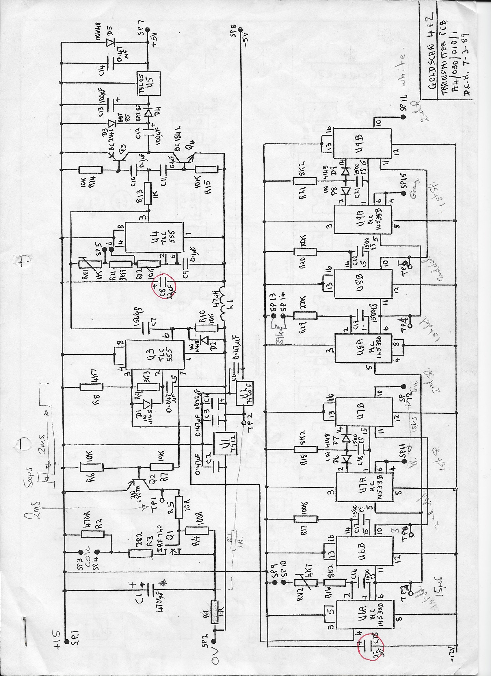

    Eric released gold scan2, and I don't think there's a problem with it. This 7805 is really hard to understand.

        • look HAMMERHEAD PI schematic and you'll see that 78L05 gives +5V above +12V.
          ie on output of it really is +17V in relation to the -VB point (Carl uses VB, i do not know what it is, voltage basic or
          something yet, not in my competence).
          • look Fig. 4: Power Diagram
            in https://www.geotech1.com/pages/metde...ead/HHv1p5.pdf
            • The power supply scheme in post 298 is different than in post 302.

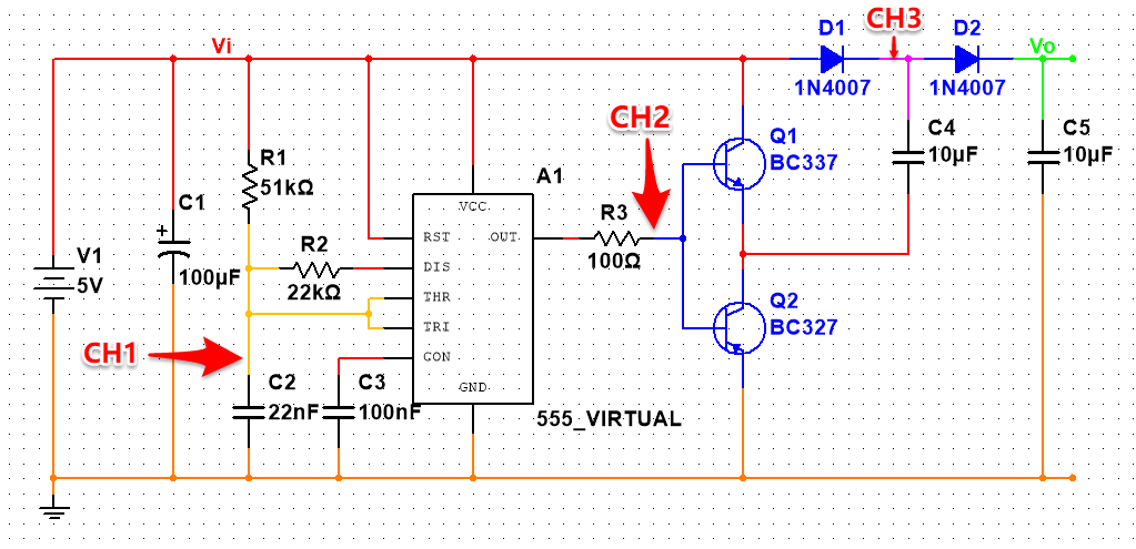

ID:	362298I found a double voltage circuit that doubles the output voltage like the 7660 of Hammerhead, and the rest of the polones, the problem should be solved.:哈哈:
                • found a double voltage circuit
                  for what??? seems you are like the senseless weather vane that turns the arrow in any direction but not where the wind is blowing into.
                  you need to get just +5V above your +12V.
                    No, I need to understand it. Pure numbers are hard to understand. I want to know how the whole circuit works.
                    • The voltage doubler circuit drives the 7805
                      • The positive is used as a ground, and they work in the same way.
