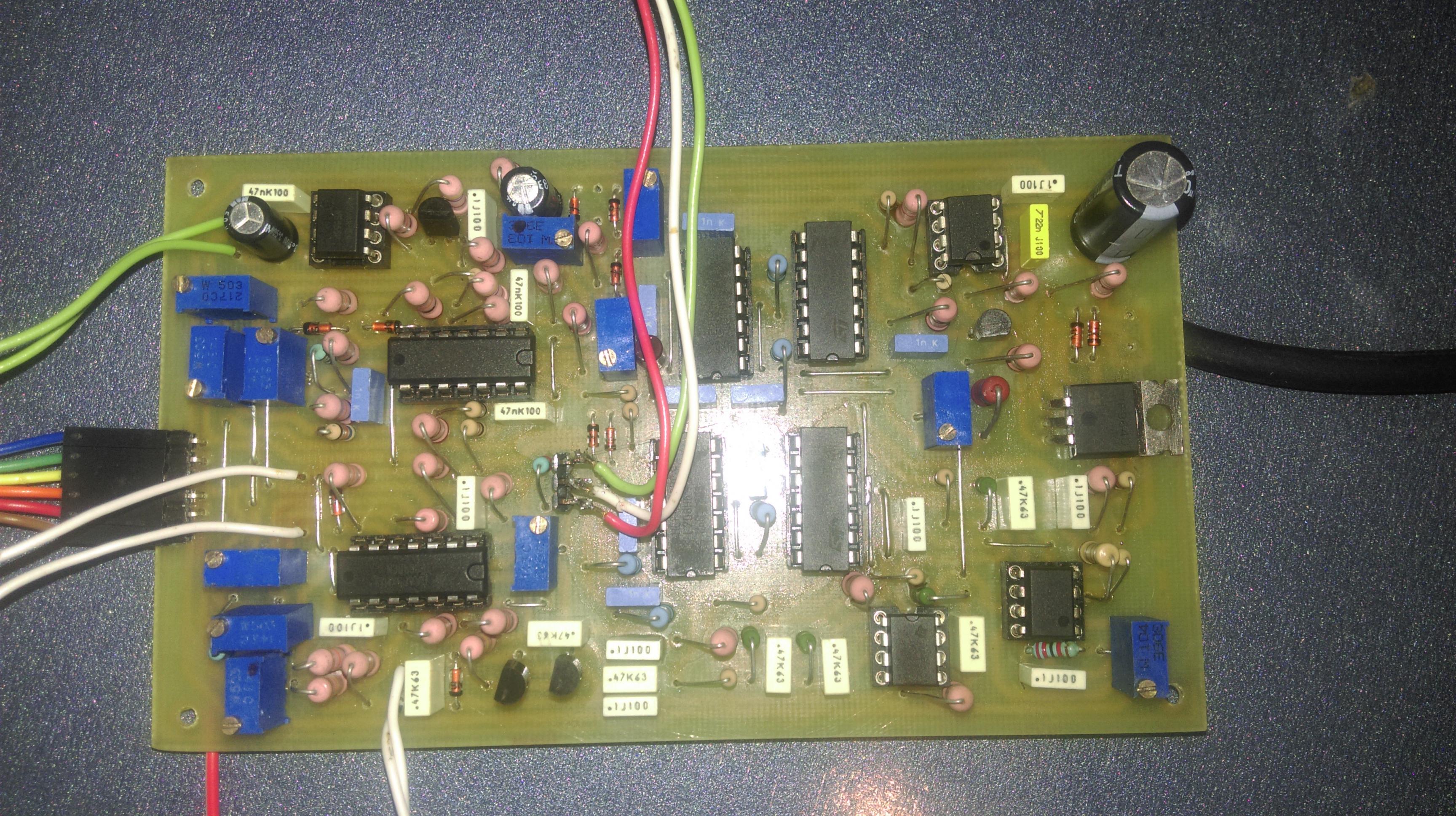

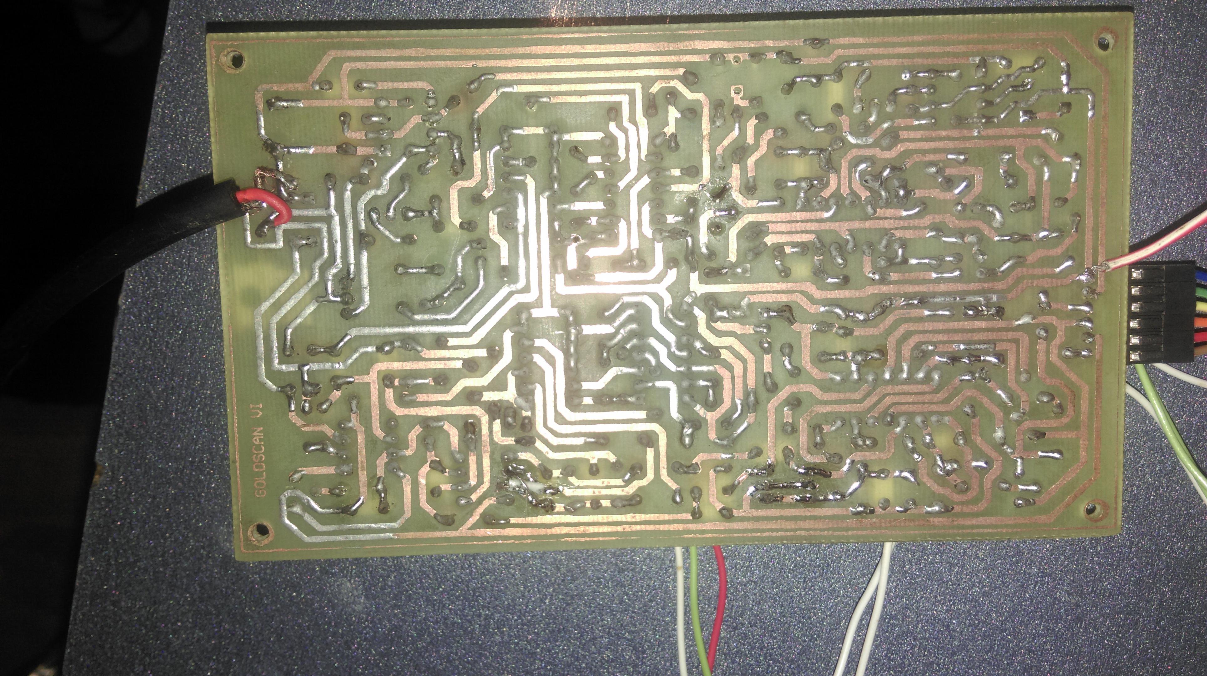

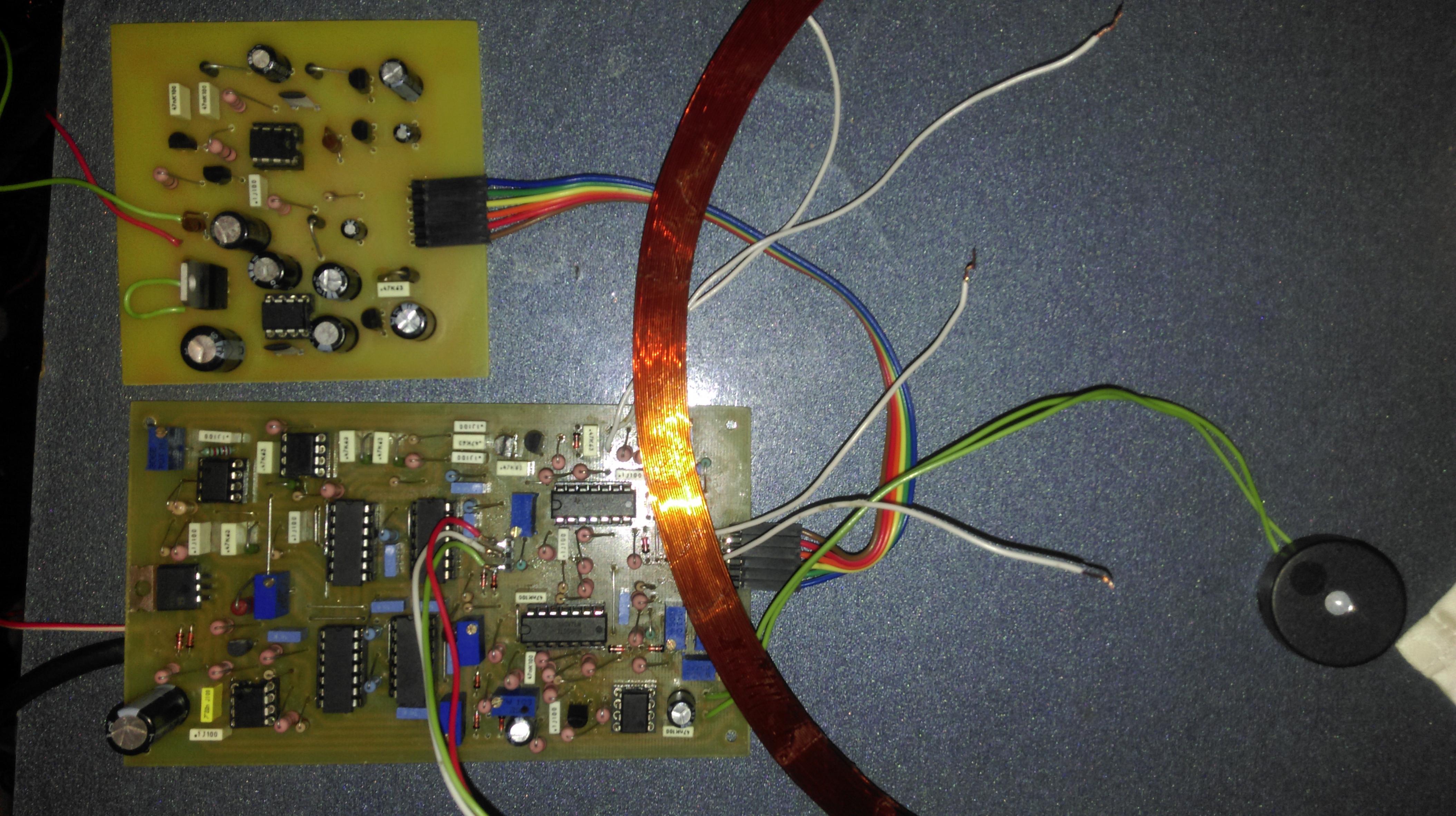

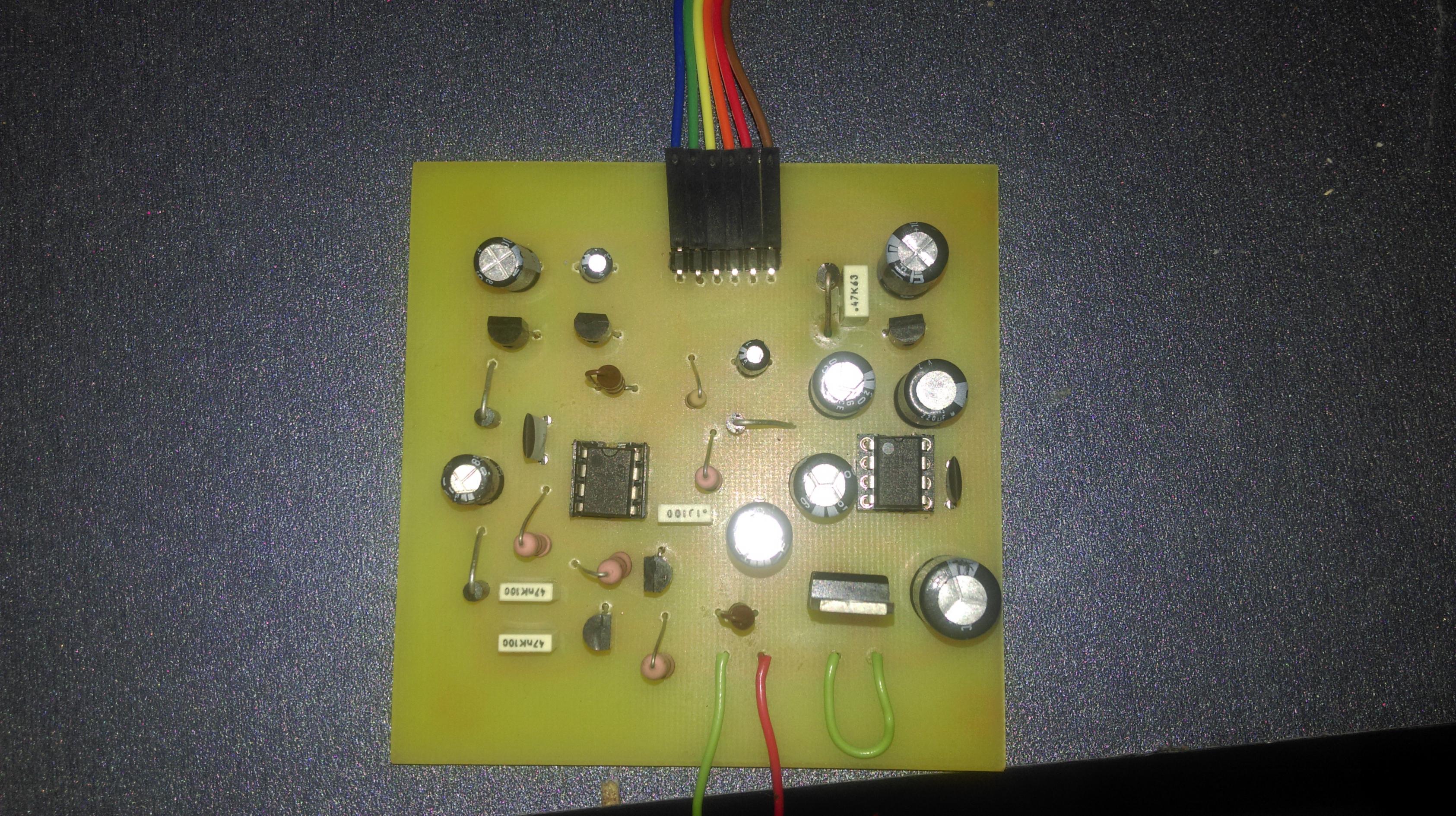

                  • Hi Orbit, how do i adjust P3? Thanks
                    • We finished constructed Gold Scan 6, but I can not manage to adjust RV4 , RV8 , P3 , P1 etc. I oscilloscope, and do not discriminate
                      • As you adjust trimmer potentiometers hold reset all the time set out to zero ,with P3 set sampling another channel for iron ,something you're wrong this certainly works ! pay attention somewhere I wrote that there is a fault at the gate for channel iron , go back and read from the beginning ~!
                        https://www.youtube.com/watch?v=4GG-j5uKDTU later suffered modifications here is the snapshot of the same detector ,of course with quite modified, now has a smoother threshold of Whites TDI .
                        • Yes I did have reversed pin change and I set 2-3 LM reset button pressed, I put trimmer RV1 = 0V; RV2 = 0V; RV4 = 15mV; RV5 = 0V; RV6 = 0V; RV7 = 0V; P1 = (0Vpin6 ne5534); RV8 = 80K RV3 =? P3 =?It is ok?
                          I did not mention that the oscilloscope to make adjustments to 50us-75us and the delay 25us. Thanks
                          • Can you record video !?
                            • I will attach a video as soon as possible.

                              It's ok as we set trimmer? Thanks
                              • Take a picture below to see !
