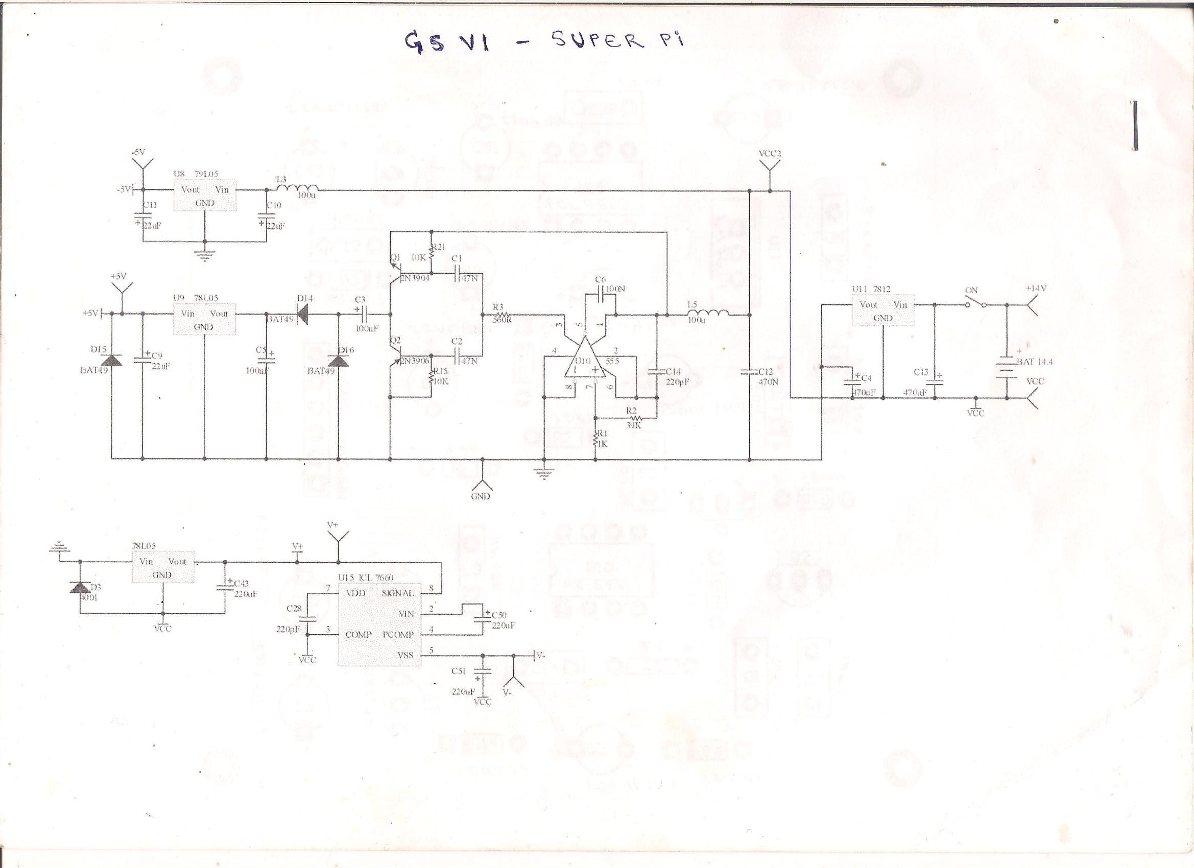

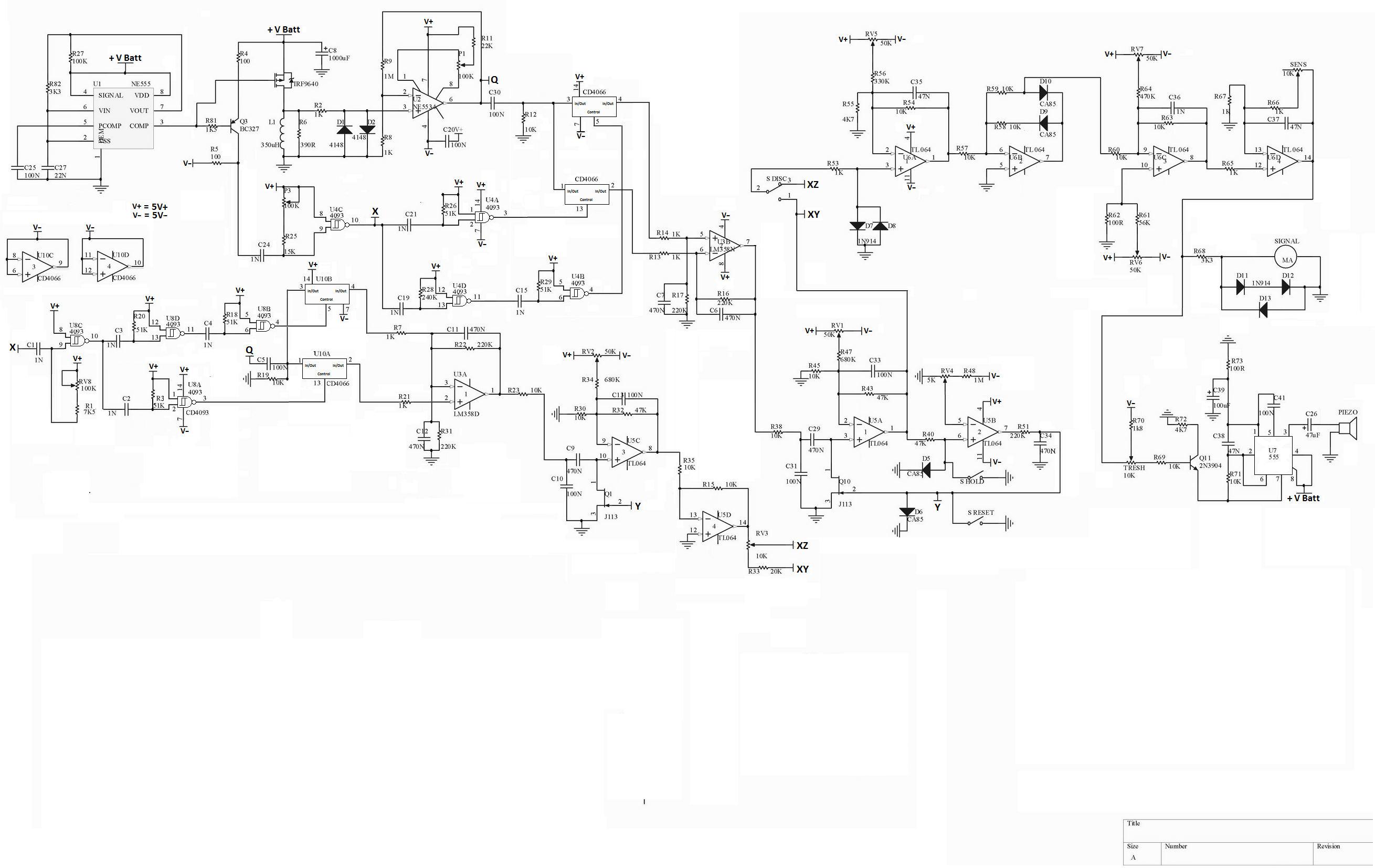

                            Orbit, Click image for larger version
Name:	Goldscan VI sema.png
                              that it is ok !
                                Originally posted by Thomas View Post
                                Orbit, [ATTACH]30562[/ATTACH] Correct?

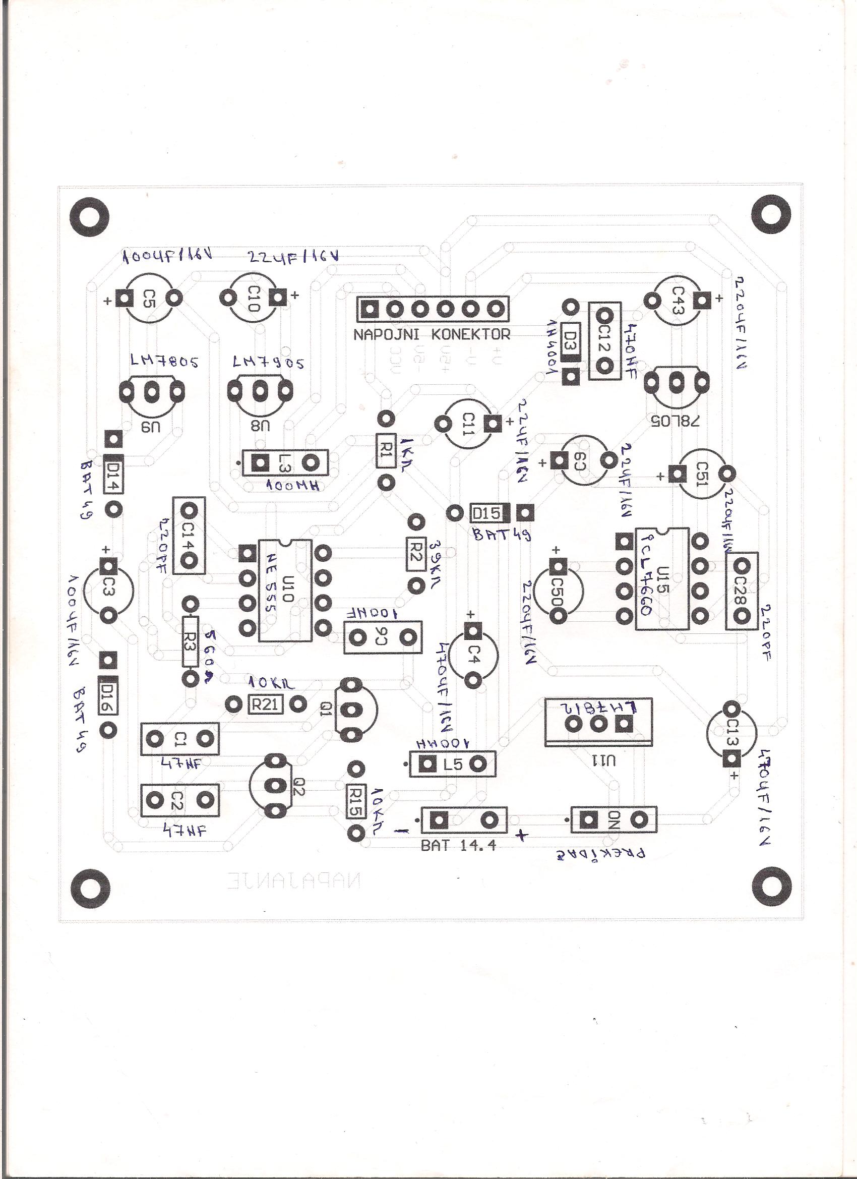

                                I noticed a an error part of goldskana 4 power from other sources ,must be marked -5v x and +5v x
ID:	341217Click image for larger version
