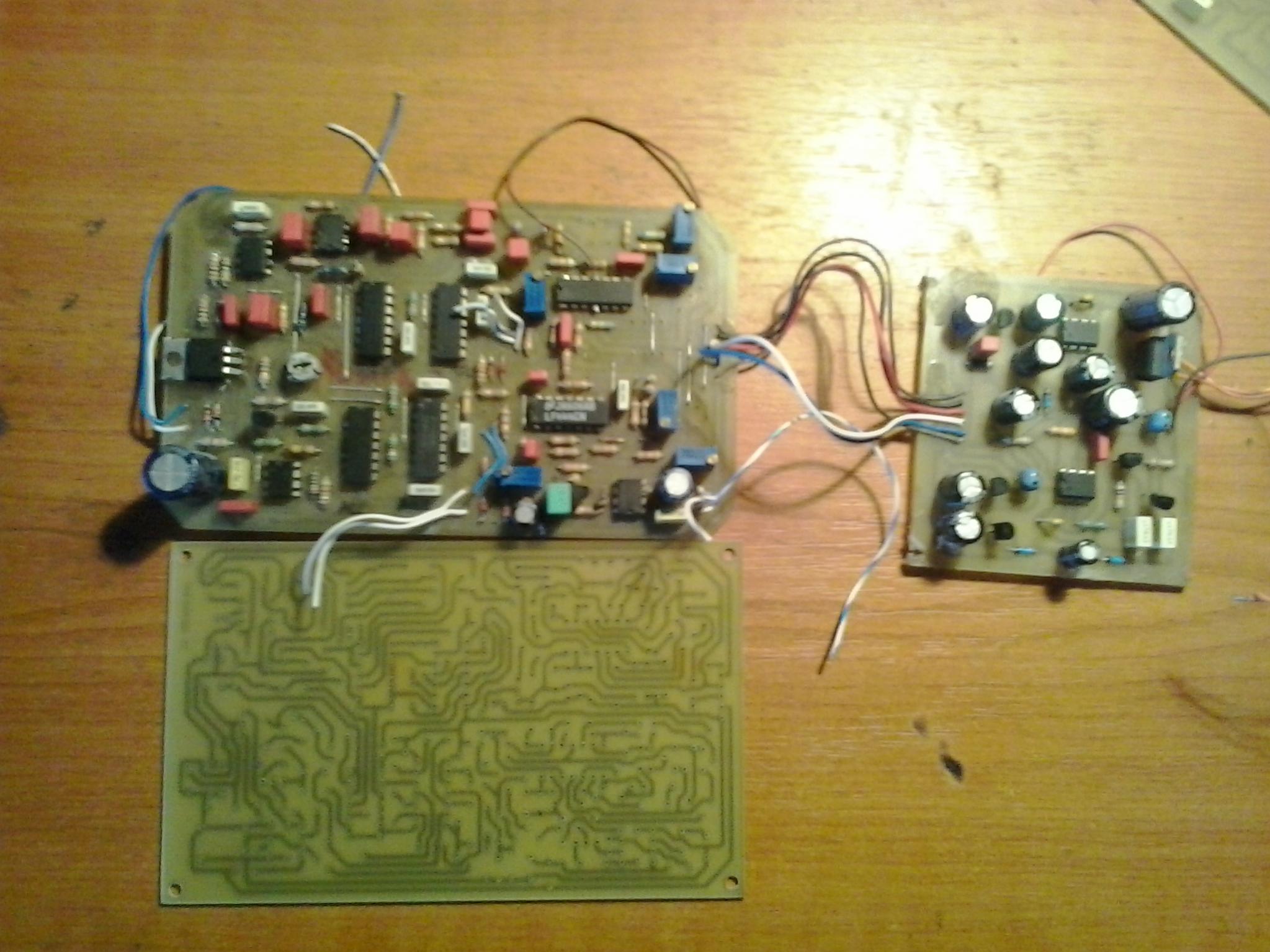

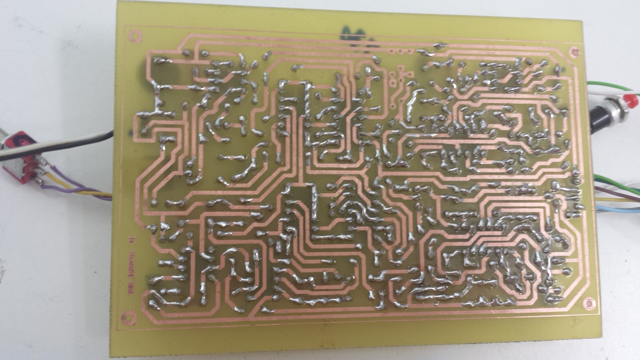

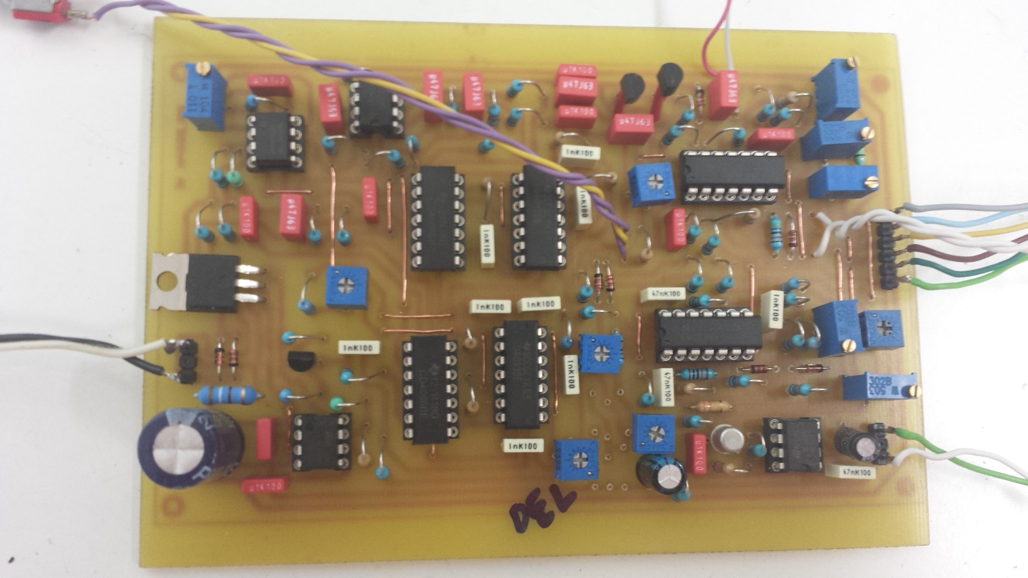

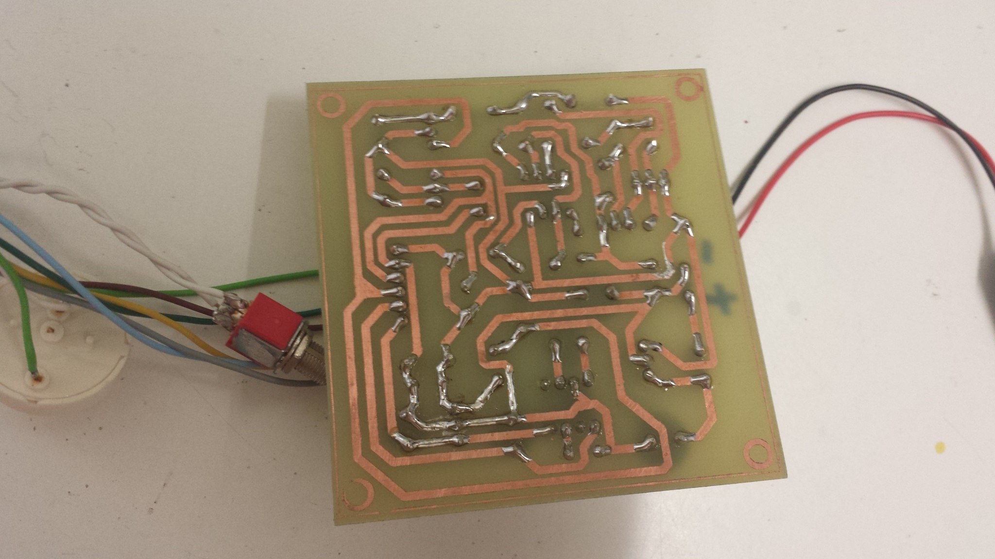

                            GS-6
                            Here is my GS-6. The detector works properly in all metal mode. Disriminacion mode does not work. There is no type of discrimination. I have checked all the components, I made all measurements, but without any success. No what can happen with discrimination. I need help. Orbit Thanks for your great work.
                            • #45

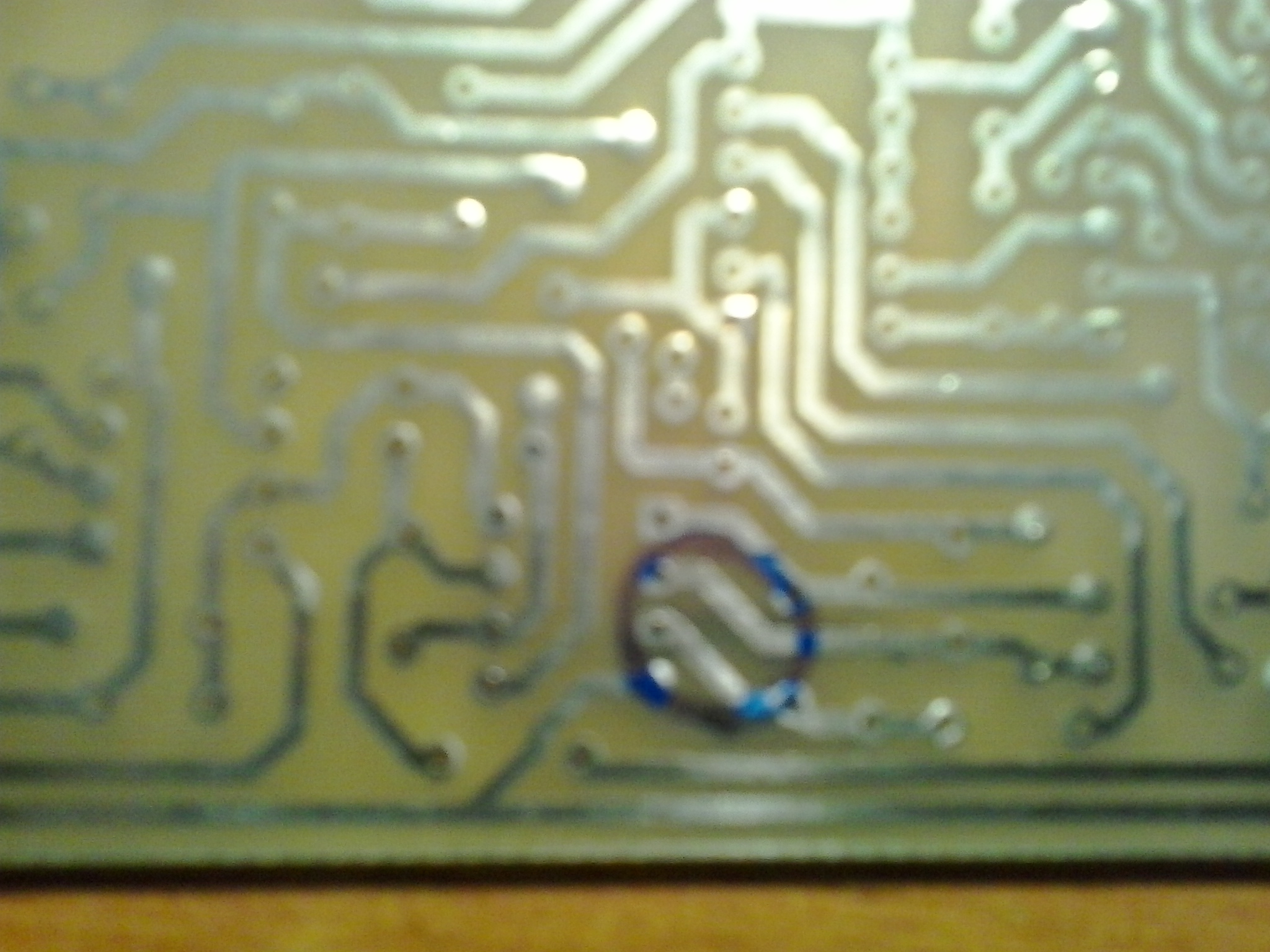

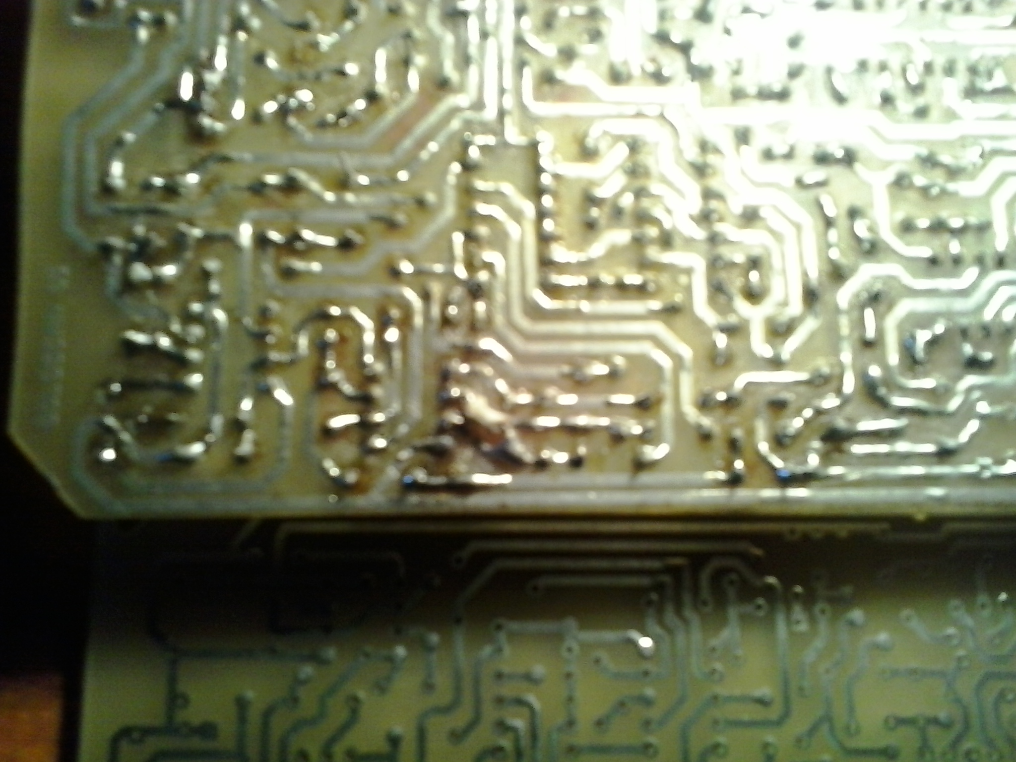

                              just cut Ties to 2 and 3 pins lm 358 and Rotate them
                              ties with cd 4066 what goes on 3 to the 2 and ties with cd 4066 what goes on 2 to 3 pins lm 358 !
                              That's the only error but only to the pcb I think the scheme is OK !Click image for larger version
