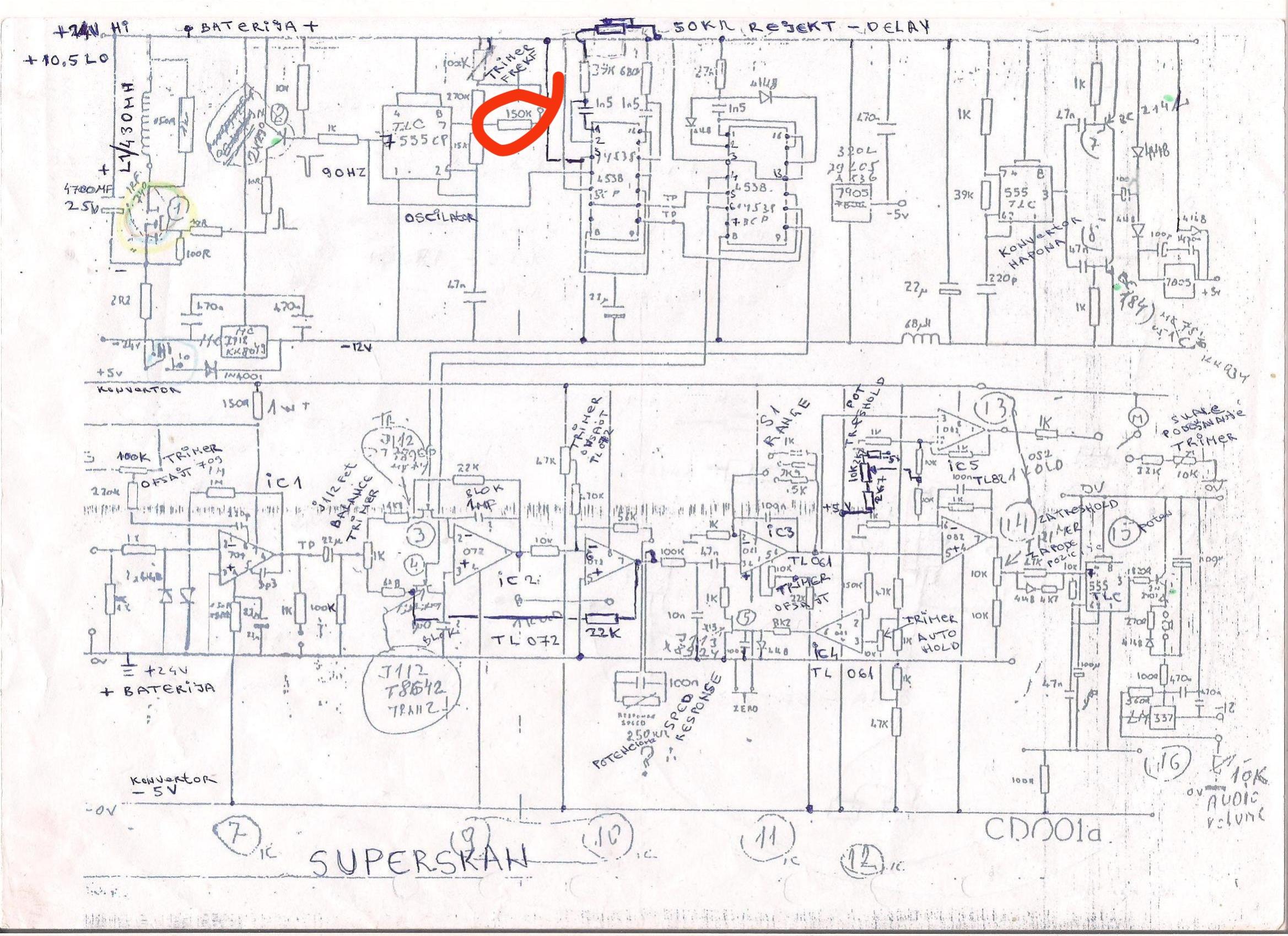

            Hi all the experts, can you tell me how to install the frequency control?

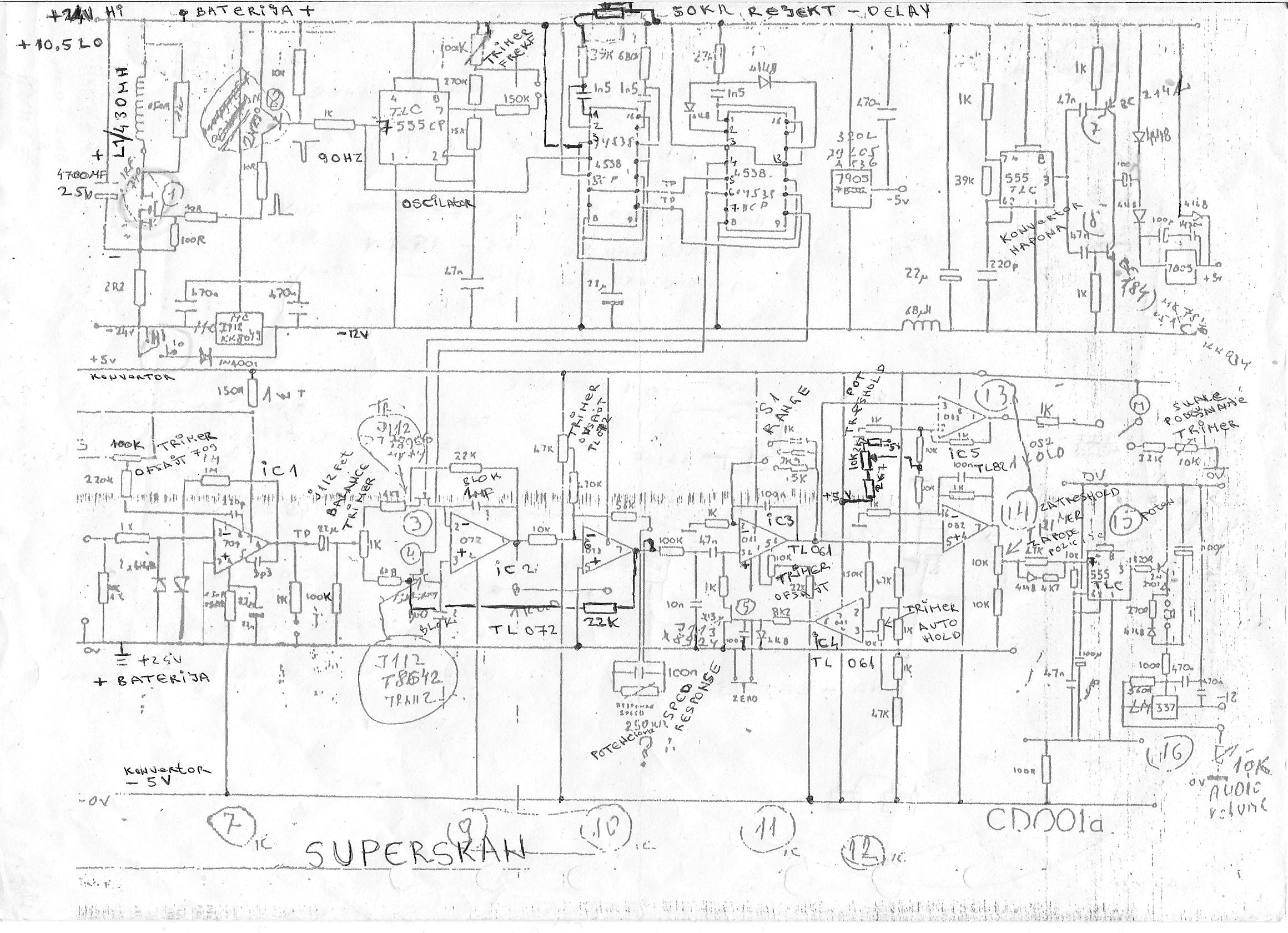

Name:	superskan by erik foster orginal kopija2.jpg

                    Change the resistor values in the 555 oscillator. There is already a pot that appears to be labeled "freq trimmer."
ID:	363506Thank you for replying to me, is this here? I do not know English
                      • #56
                        There is a 100k, 270k, and 15k resistor that set the frequency and pulse width. It looks like the 150k resistor might be switched in for changing the timing. Do a web search on 555 timer oscillators, you will see how the resistors (and cap) set the frequency & pulse width.
                        • #57
                          hi, have a look here : https://www.electronics-tutorials.ws...ts-part-1.html
