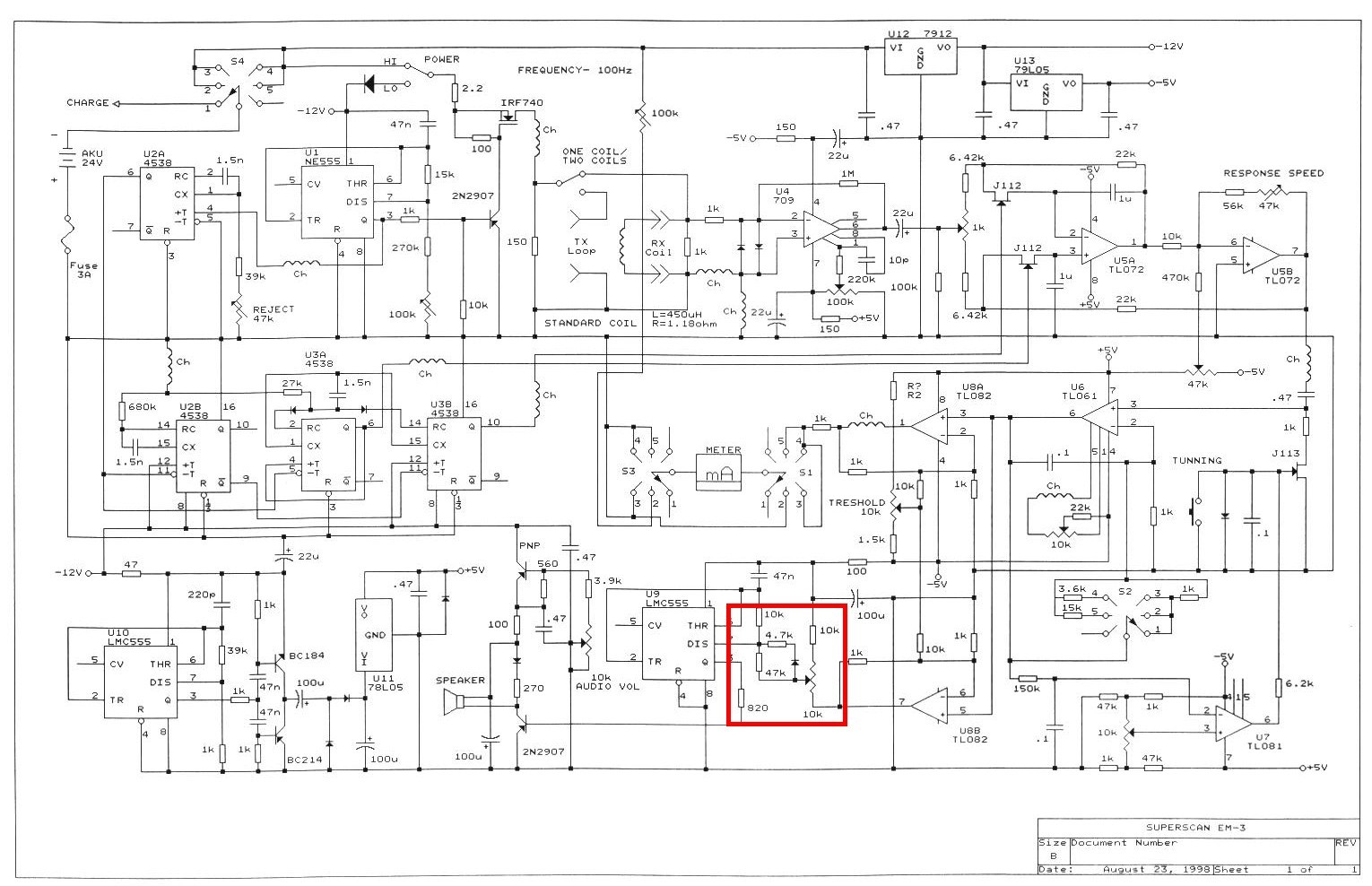

    Hi Maxe,
    here is another better schematic of the Superscan. Superscan EM-3
Name:	Superscan EM3_m.jpg
    Unfortunately, only this circuit diagram is available, not a printed circuit board.
    Excuse me, that red square is covering three numbers; could you tell me what those numbers are?

      Hello,
      I've asked about these three components before. So far, no one has been able to give me a satisfactory answer as to why there's a diode in the circuit.​
      • #78
        Hello,
        Hi Geomax
        When the signal goes higher than about 0.6v the diode begins to conducts through the 4.7K and becomes actively parallel with the 47K. The lower resistance causes a rapid increase in vco audio frequency. When the diode is not conducting the LM555 only see's the 47k so the vco is idles at a low threshold frequency. It also reduces some audio noise when no targets are detected
        • #79
          Hello Altra,
          Thank you very much for the explanation. That's well explained and makes sense.​

            What are those numbers below the red line—the one I’ve outlined in green? I can see the numbers 6 and 7, but the other one isn't clear; could you write those numbers out for me from top to bottom?
            • #81
              Hello Maximo.
              It seems you like having everything handed to you on a silver platter. If you took the trouble to look at integrated circuit U10, you would realize it is similar to U9. The pin order from top to bottom is: THR=PIN6, DIS=PIN7, Q=PIN3. Attempting to build a Superscan PI detector without any knowledge of electronics strikes me as very bold on your part. I hope you have some luck, because you’re going to need it.
