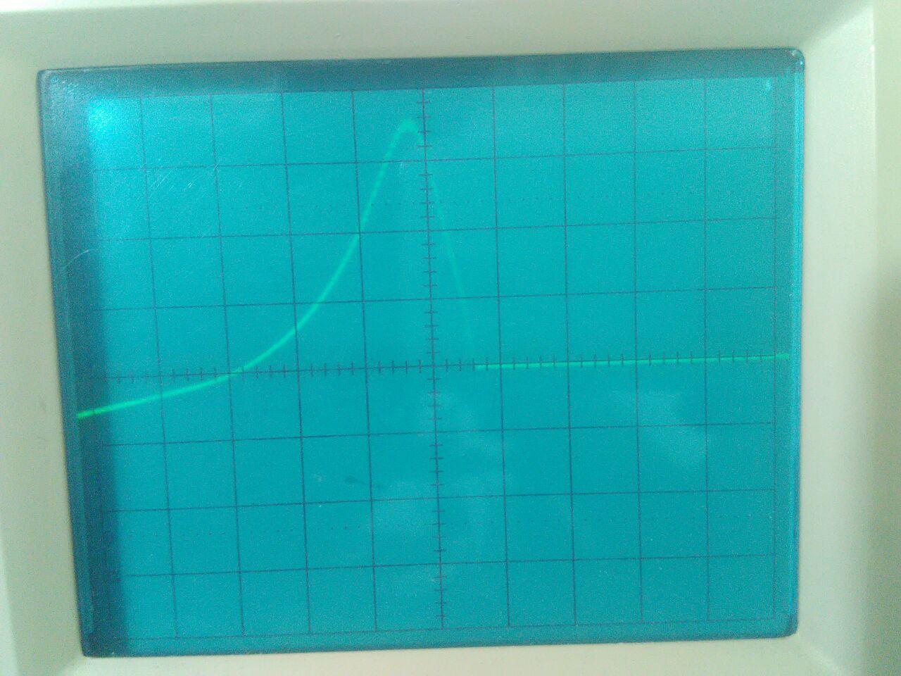

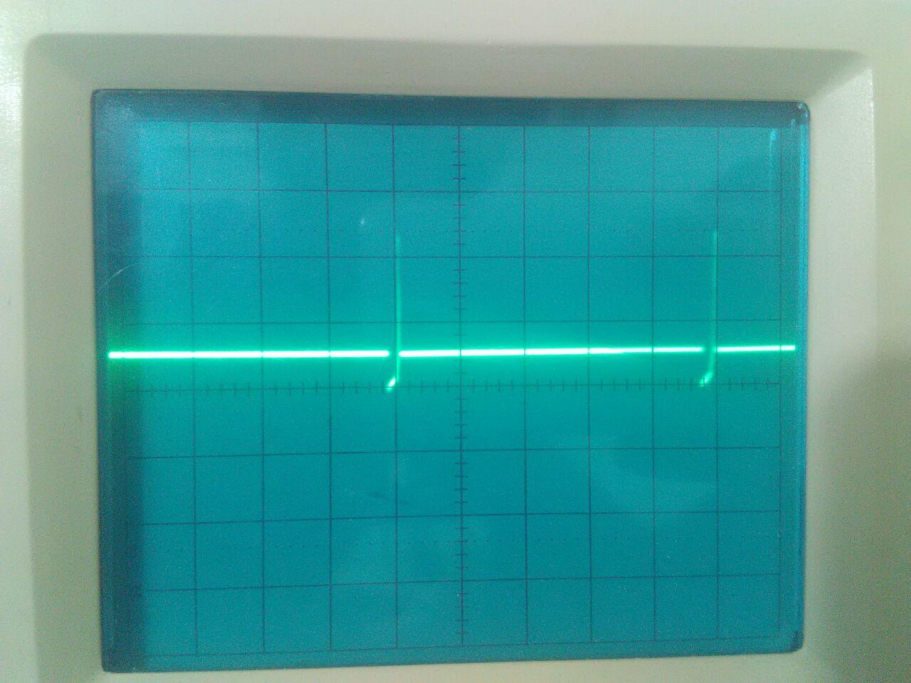

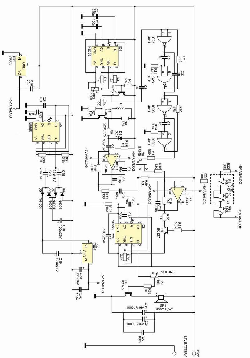

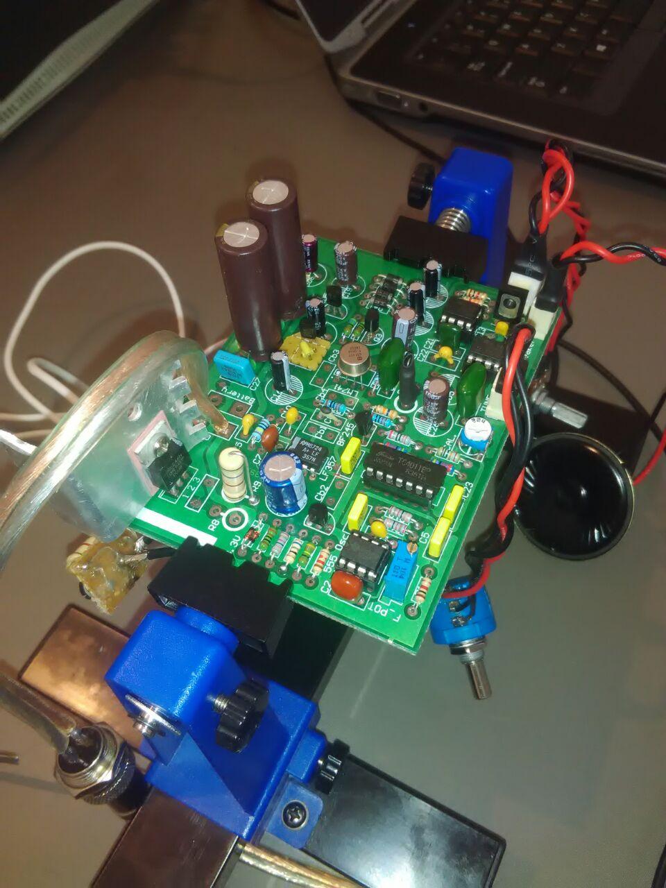

                • can anybody help on this problem?

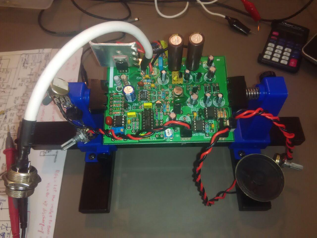

                  i made my own PCB for this polones schematic
Name:	Modified Sandbanks(polones) - from Ivconic.jpg
                  layout is ok connections are ok but it hardly detects a big iron lock
                  coil information:
                  0.75mm enameled
                  13 turns
                  1 ohm
                  should be about 260uh
                  damping resistor 470 ohms
                  gain of PreAmp is 3700 (on the high side)
                  here are all the necessary information of the running circuit
                  settings are : volt/div= 5v time/div= 2ms otherwise mentioned

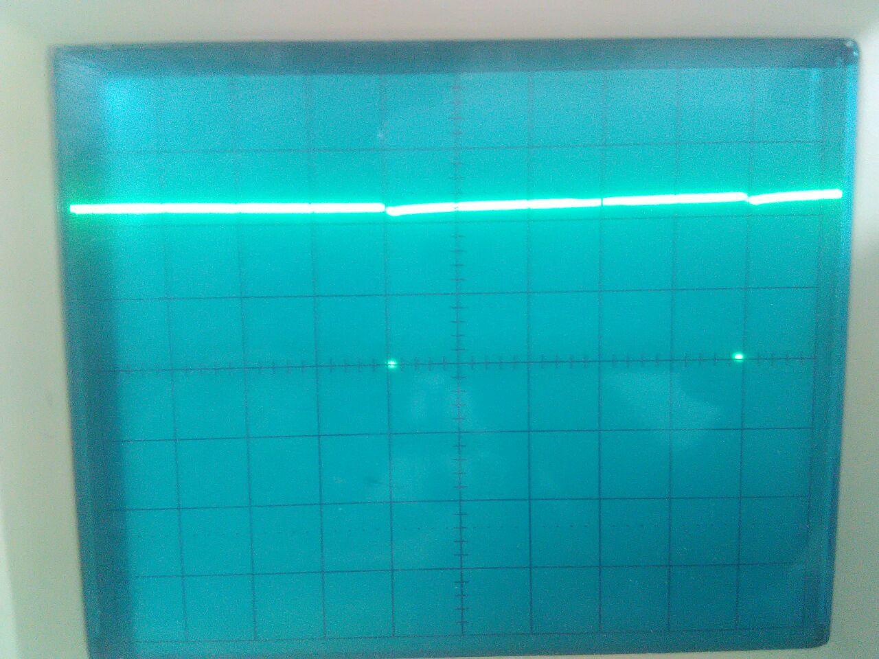

                  1_oscillator output
                  2_gate of IRF740

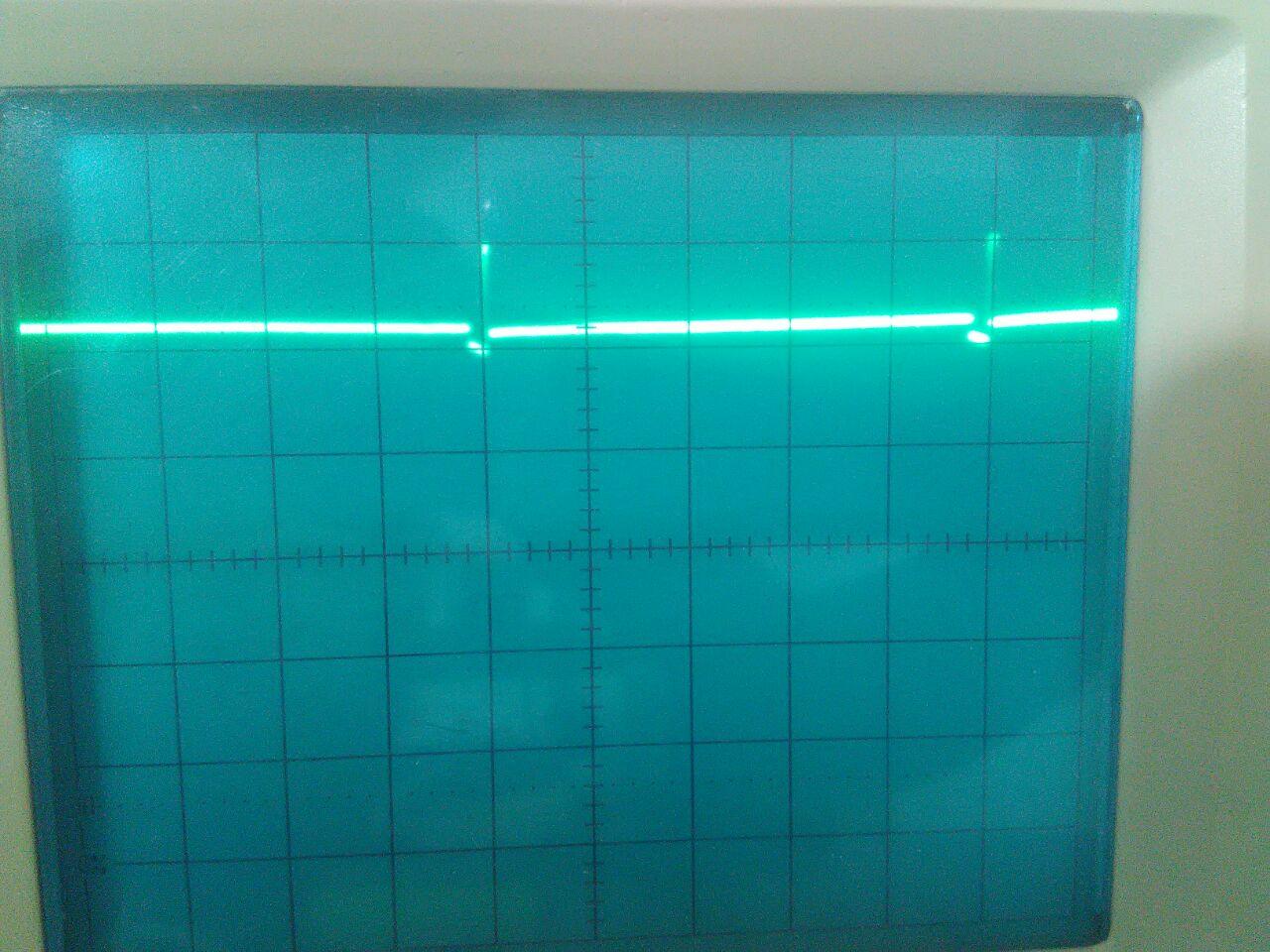

                  3_Drain of IRF740
                  volt/div = 20V time/div = 2ms

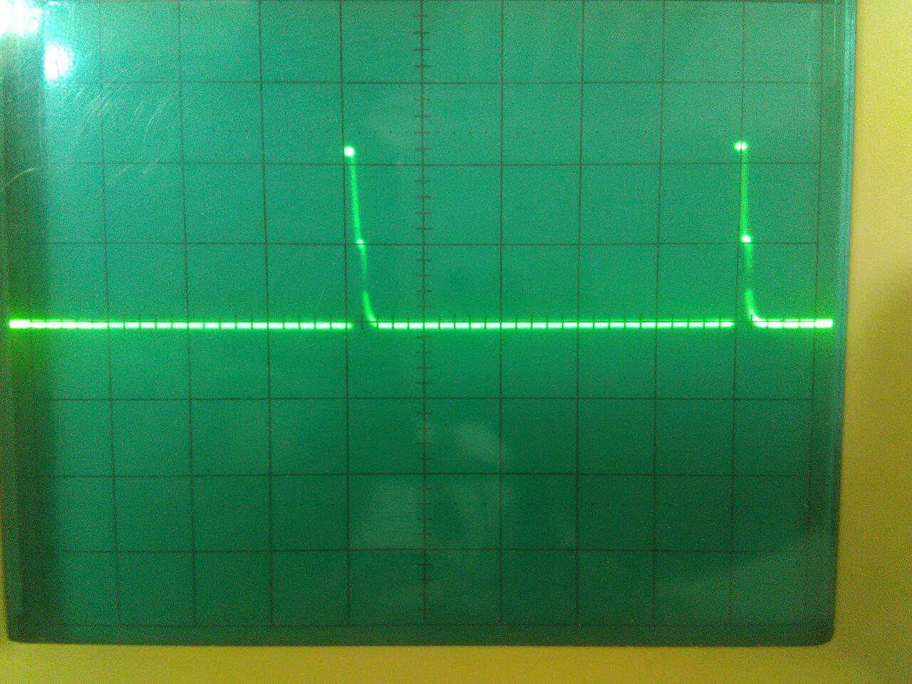

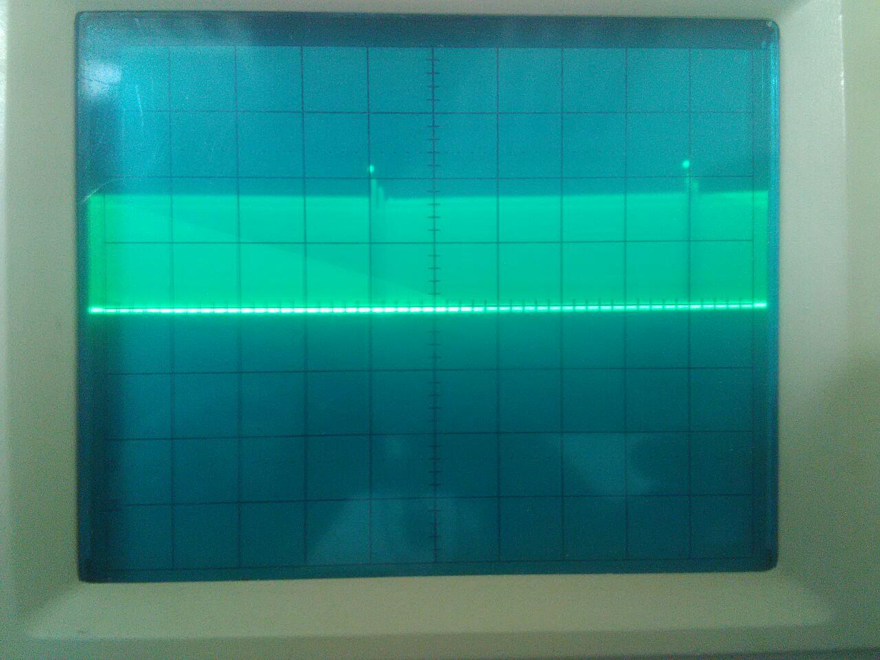

                  4_drain of IRF740 zoomed out Back EMF
                  volt/div = 10v time/div = 20us
                  it has a bit of undershoot on the falling edge about 0.5V

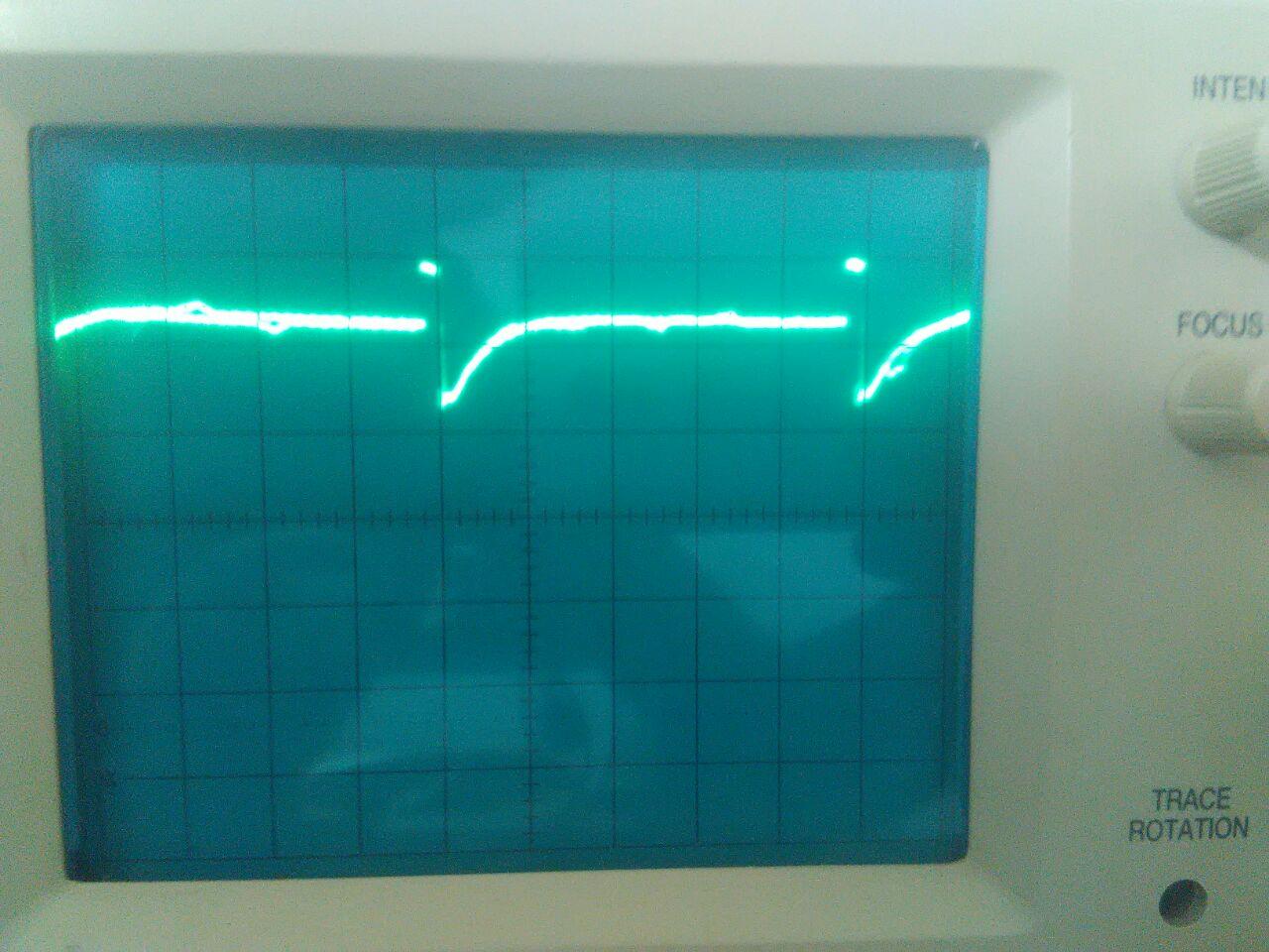

                  7_pin 6 of preAmp
                  any help would be great
                  • a better view:
                    • 2_gate of IRF740
                      how much PULSE WIDTH?
                        2_gate of IRF740
                        the hole pulse on and off time is 10ms (each division 2ms) = 100Hz
                        so i think it's about 200us on top(peak) of the pulse and 400us on the bottom side
                        but over all the duty cycle is 2%
                        by the way i changed the two gate drive resistors by calculation
                        the series one to (R6) 27ohms and the pulldown one to (R7) 33K which is ok for the frequency i think.
                        • 200us PULSE WIDTH gives 400V p-p. you can not check pulse on the gate because you DO NOT SEE IT.
                          so also it is HIGHT VOLTAGE and you will burn your o-scope in moment.
                            i changed the pulldown resistor(R7) on the gate from 33k to 220 ohms and i think it was too low that the mosfet didn't fully turn on(it was dead cold)
                            I changed that to 2.2k and it's better i guess
                            now the PULSE WIDTH is 70us or there about and mosfet doesn't get hot at all
                            detection is improved just tiny bit and i think the problem must be in coil driver and coil itself
                            do you know what is the optimum gate pulldown resistor for the IRF740 ??
                            the series resistor for gate(R6) is 27 ohms
                            now i'll just add couple of turns to the coil see what happens
                              820k under lf357 changed to 1M
                              Bernte did you put trimmers in place of the two 33k resistors to enable changing the sample delay?

                                How did you choose the size of your damping resistor? Did you use the variable damping tool? I am thinking that it is not sized optimally.
                                Cheers
