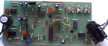

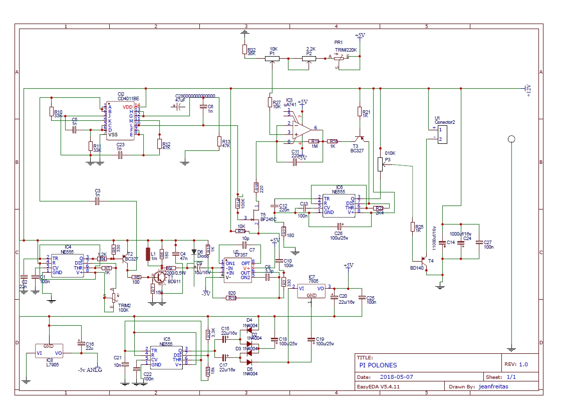

      at the moment we start a project here in german forum based on this pcb
      I have this layout, seems the same.

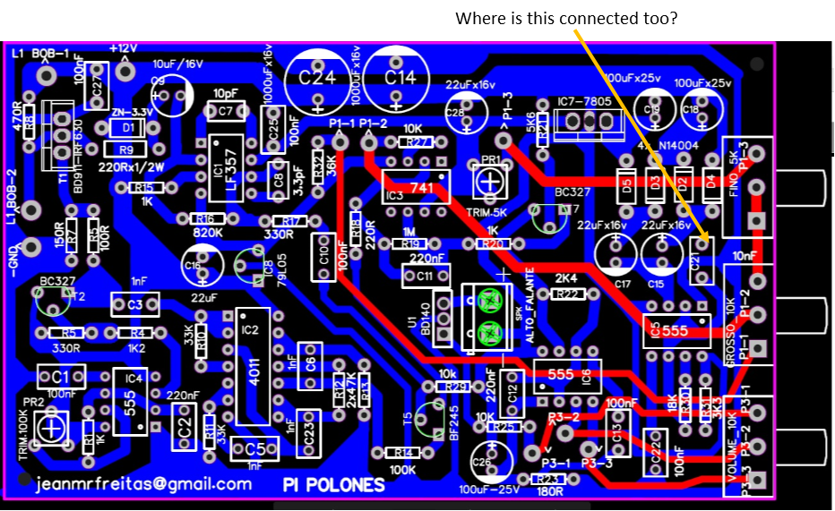

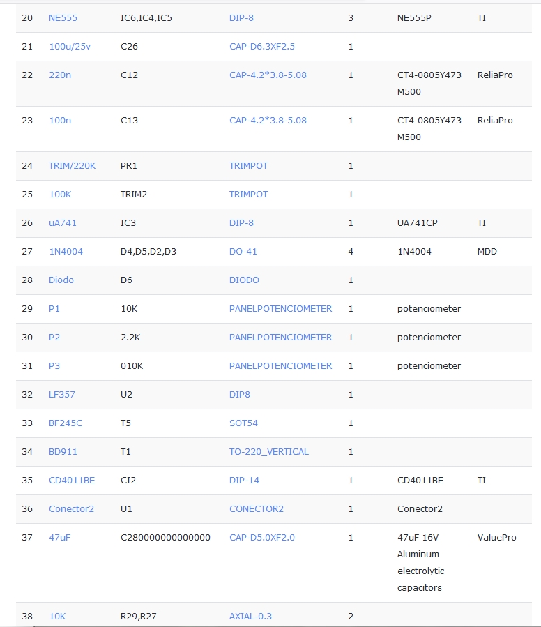

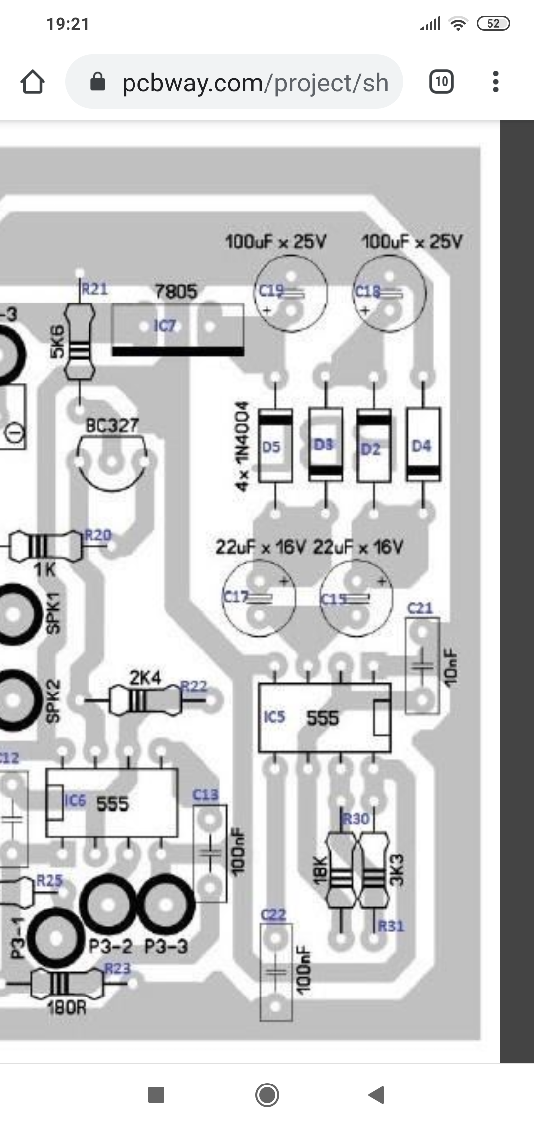

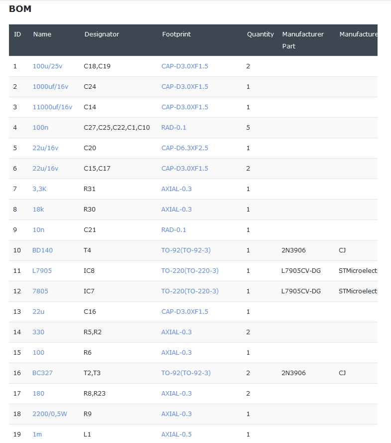

                            • Thank you Andi68,,,,There seems to be a capacitor unconnected on the pcb image from the new Polones project? Regards,,,Marty
