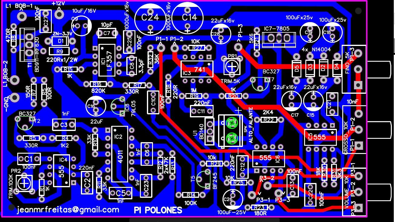

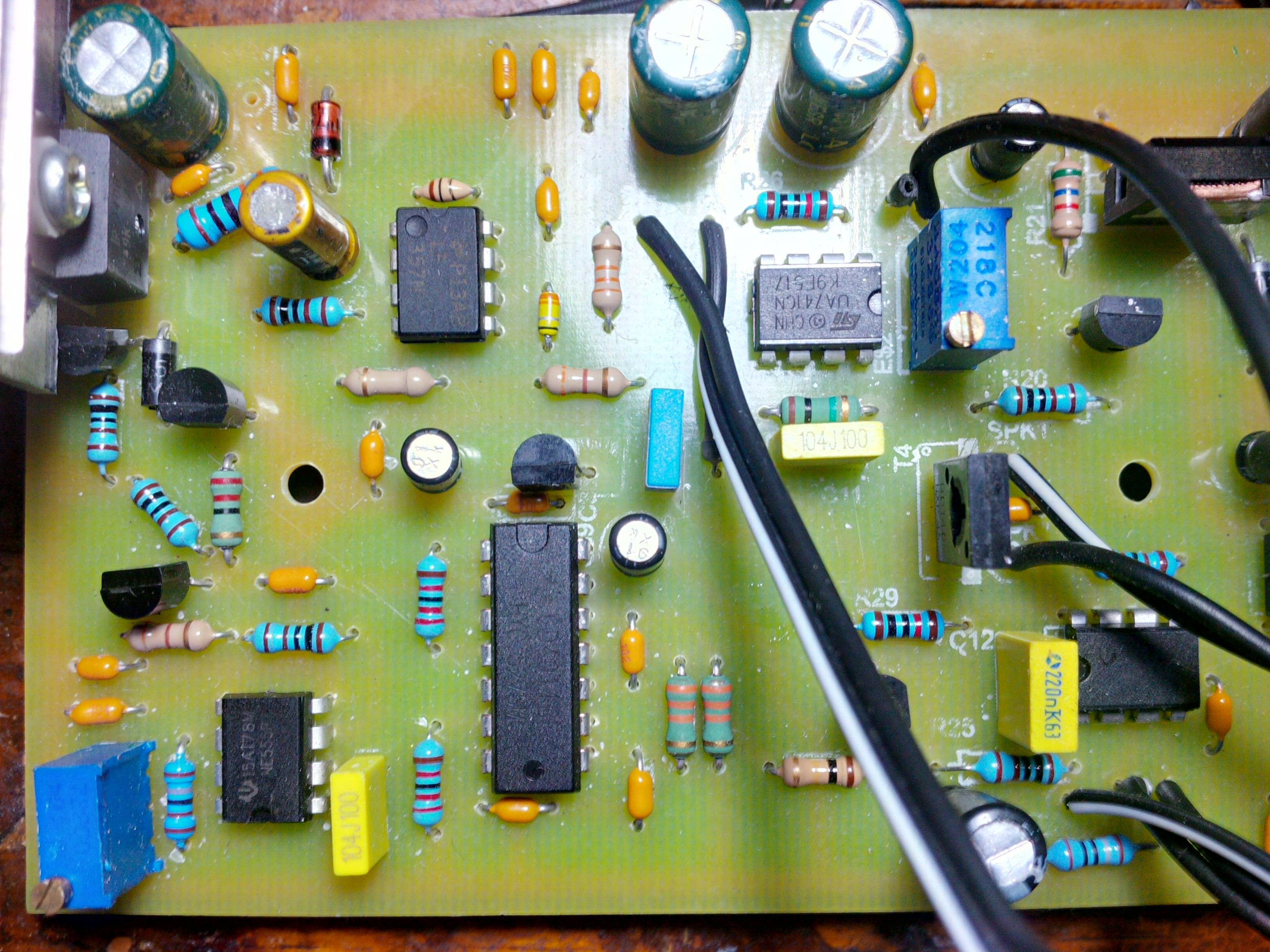

            modified from PI Polones
            inside

            modified driver mosfet and sample delay, sample window
            spec :
            Freq : 200Hz
            Pulse Width : 125uS
            Sample Delay : 25uS
            Sample Window : 50uS
            Coil : 302uH

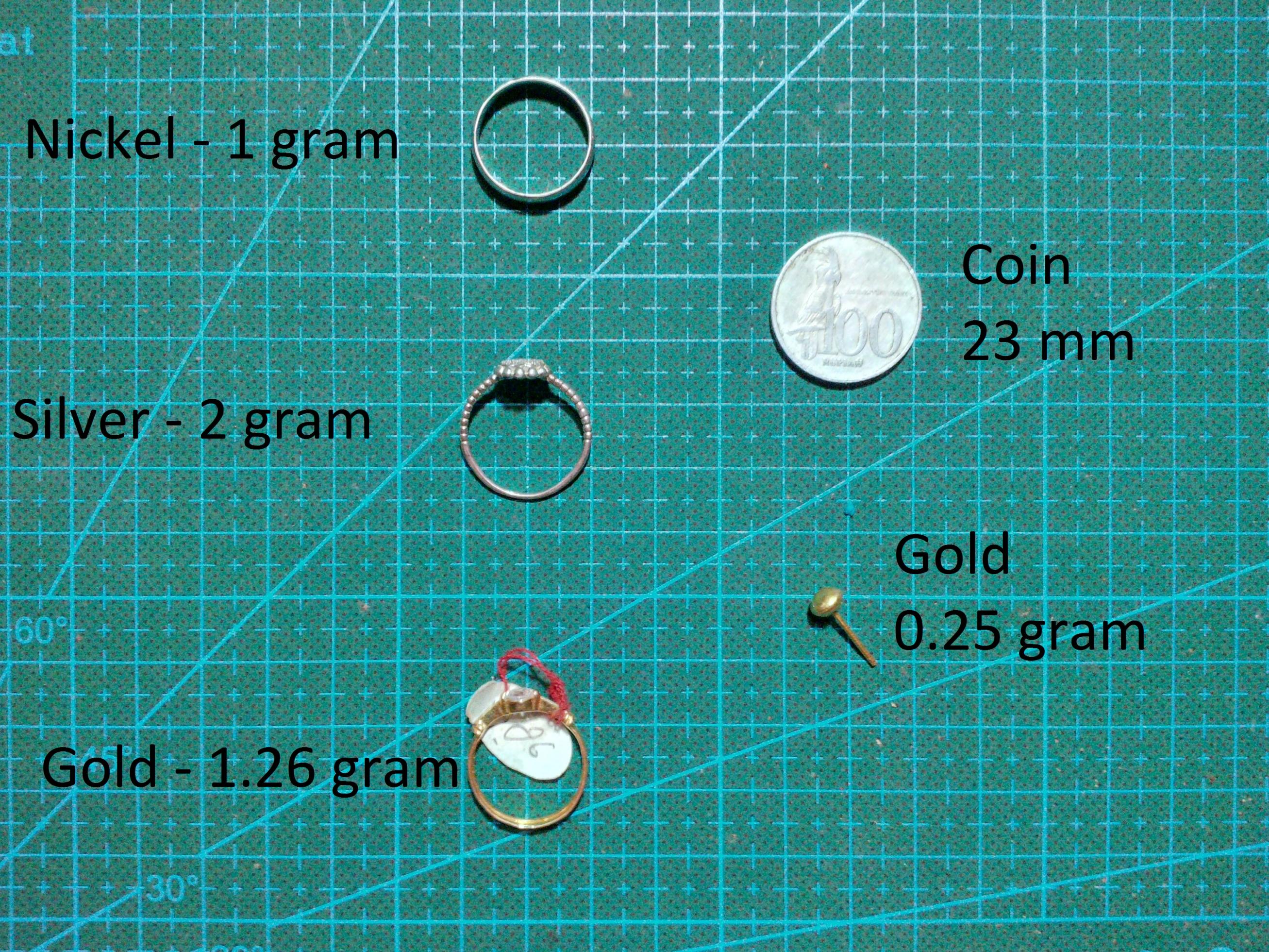

            testing :

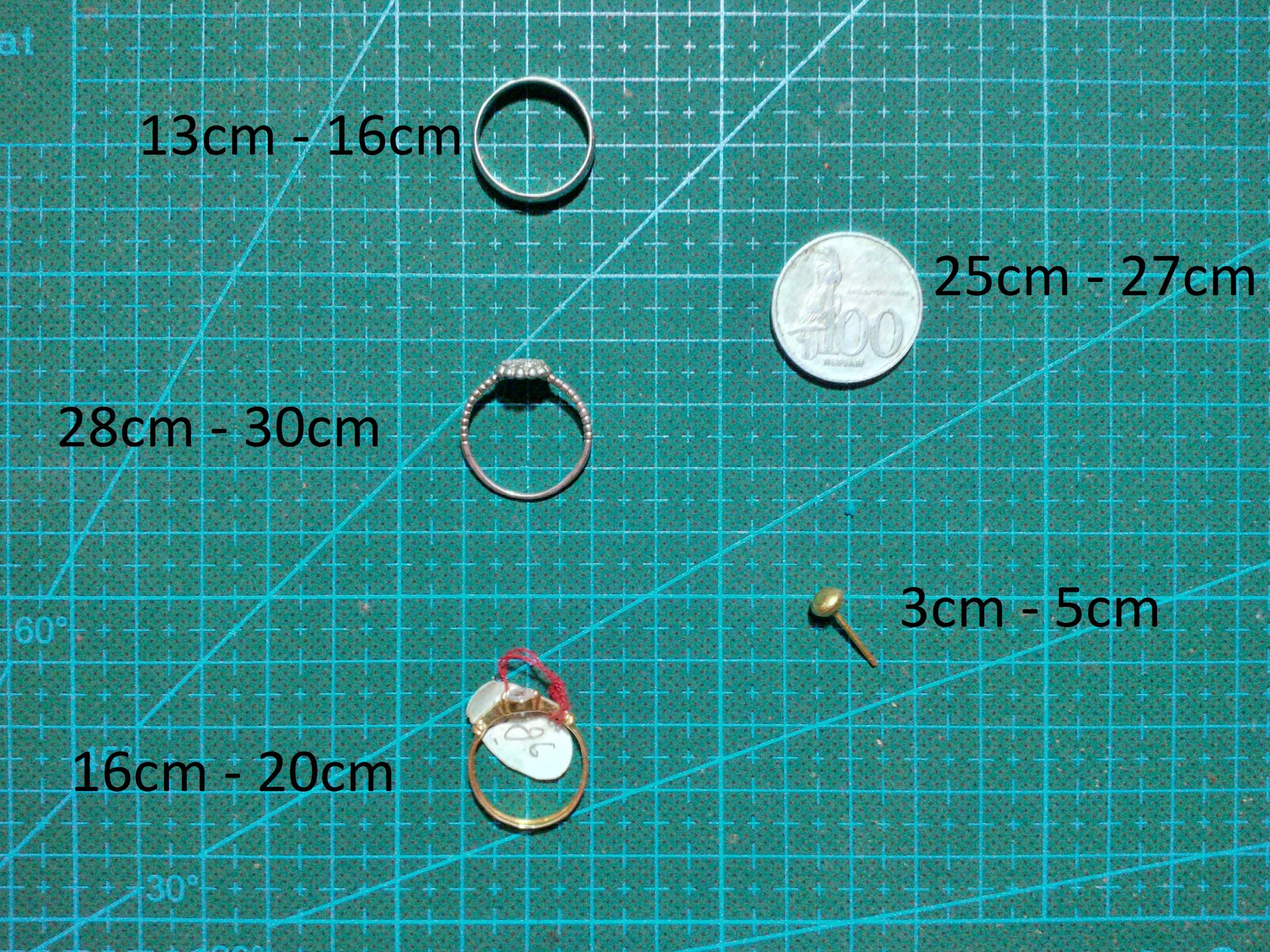

            result:
Name:	IMG_20161229_152257_hdr - Copy.jpg

                  Hello . WAHYU, YOU HAVE THE SCHEME OF THESE MODIFICATIONS.
