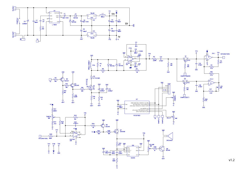

      Here's my take on Sandbanks & Proscan. Changed Gain 1000, instead of the insane 10,000; Simplified timing control; Added EF sample and integrator from Dooley TD3X; Diode for mosfet drain; PSU as in MiniPulse Plus;

      • #78
        Interesting collection of ideas, you are switching Q1 and Q3 with only 5 volts from the micro is that enough ?
        • #79
          Voltage should be right. The micro/jfets configuration is same as in Minipulse so this should work just fine.
          Will the micro provide enough current, hope so !
          From datasheet: "- High current source/sink for direct LED drive"..
          Maximum output current sunk by any I/O pin............................................... .................................................. ... 25 mA
          Maximum output current sourced by any I/O pin .................................................. ............................................ 25 mA
          Maximum current sunk by GPIO.............................................. .................................................. ...................... 90 mA
          Maximum current sourced GPIO.............................................. .................................................. ...................... 90 mA

            Here's update on the schematic. You can use PIC code from Hammerhead II thread to run this, though will probably require code tweaking.

            • #81
              Scoped my MPP and yes it only uses 5 volts on gate, this could be handy for another project.

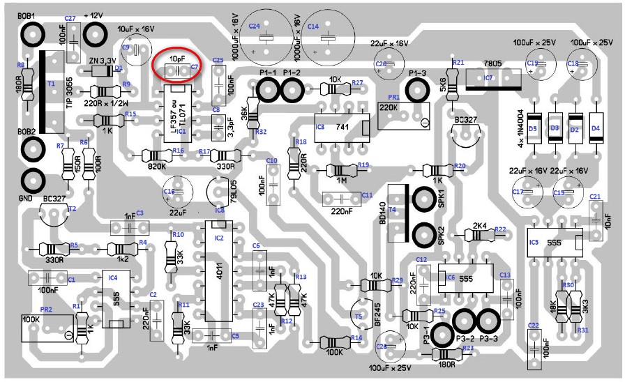

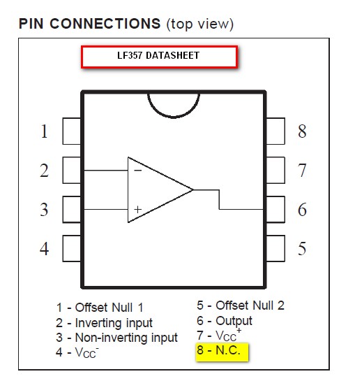

                          HI
                          Can anyone explain what exactly is the role of the C7?
                          Considering the fact that Pin 8 in the op-amp LF357 is N.C!
                          tnx

                          • #88
                            Originally posted by koohyar View Post
                            HI
                            tnx
                            [ATTACH]37389[/ATTACH]
                            [ATTACH]37390[/ATTACH]
                            It looks like a mistake to me. Here's the original Sandbanks article:
                            http://www.geotech1.com/cgi-bin/page...anks/index.dat
                            and it doesn't use an LF357. So I assume the PCB you posted is someone's modified version.
                            • #89
                              Looks like a Cap that may have been used with some other Op Amp.
                              • #90
                                The original used the LM709. It was used for Freq Compensation. Pin 1 / Pin 8.
