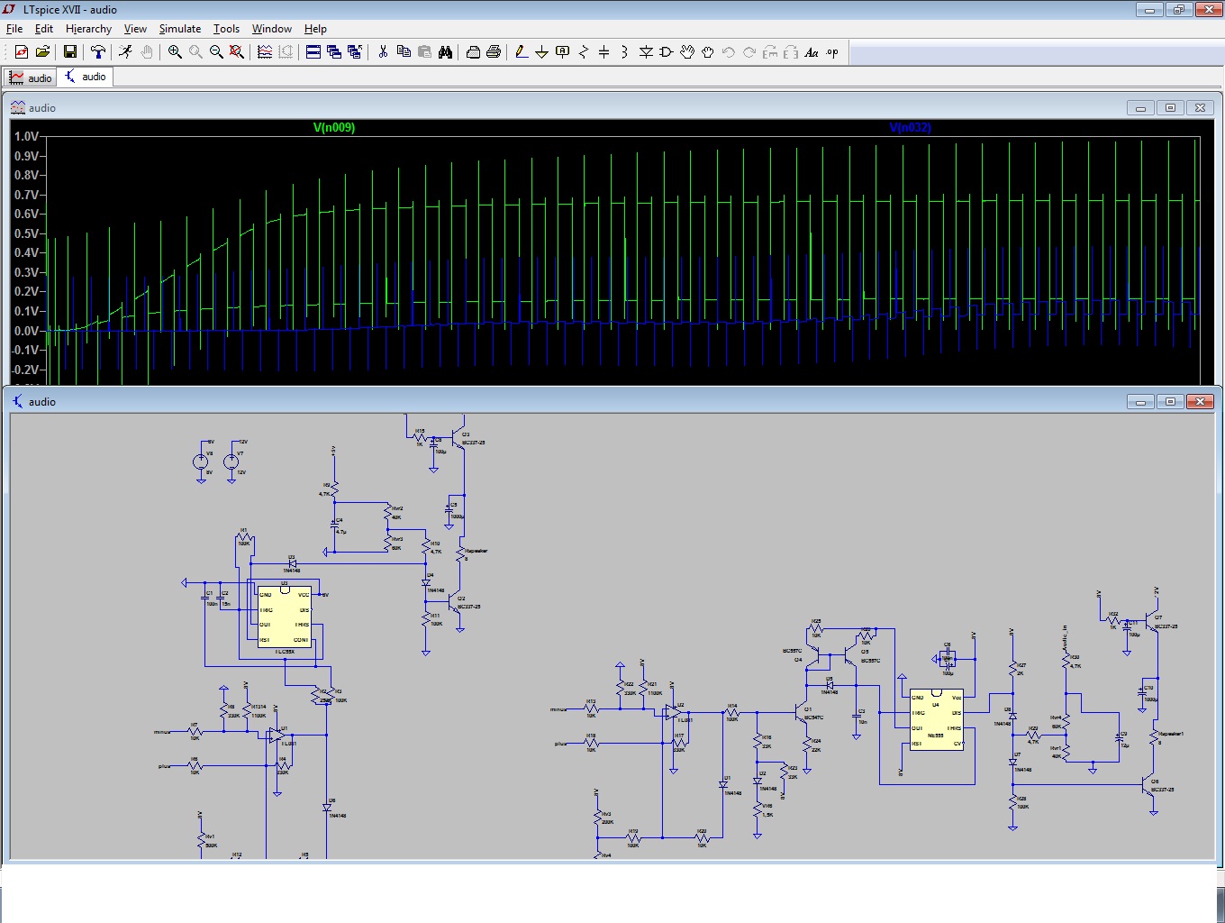

        • Hello, maybe someone helps to simulate the audio section, can`t fire it up in LTspice

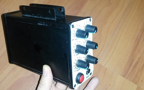

          • Quick video of my second attempt to build this thing. Main changes are PIC microcontroller instead of the 2xTS555, 4093.
            Low level 4066 switches (directly controlled by the MCU), 1V reference diode instead of the op amp, commercial optocoupler (pretty fast response - no noticeable lag at all).
            Voltages +5V for mosfet, +10V for op amps. With this coil I'm getting 200V flyback on 50uS and 330V on 100uS TX.
            Only one 555 timer (for the audio) and it's not TS555 (but regular NE555), I will try to get one.
            Still fooling around with it, it's not finished yet.
            • tidy assembly you have there eclipse,
              and nice audio also.

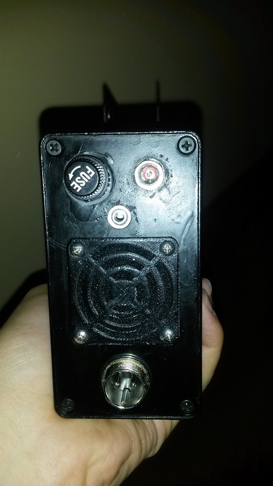

                  • I've tested different op amps today for the preamp.
                    I think we have a winner. OPA2134 blasted away the TL072, NE5532, etc... so it's a keeper. Sound at the edge of detection is now more crisp.
                    I was currious to test the 4.7uF cap in the sound stage, so I've tested different value (100uF) - sheesh don't do that! Sounds like an alarm.
                    Also tried different op amps (even a LT1018 comparator) for the final TL062. Better op amps perform worse (flattens the "wobble" sound effect) so this one stays that way.
                    Other op amps (TL062s) are AD712. Closed the enclosure.
