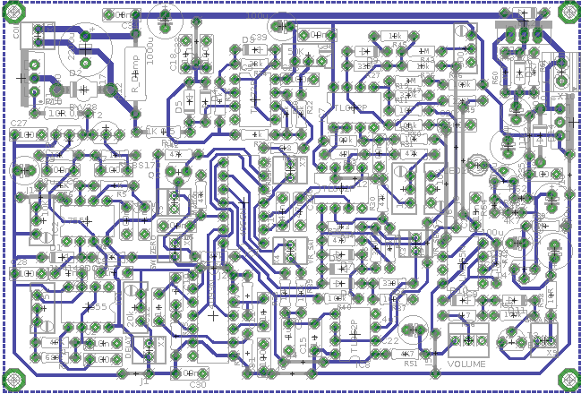

      • TD3X eaglecad brd
        TD3X-eaglecad-brd.rar

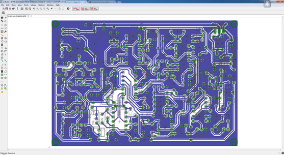

        • Is this board complete? I only see bottom layer in eagle.
            yes this single layer, unfortunately i lost my sch , you can trace pcb and free to modified
            • I,m having difficulty interpreting your layout. Some components connect to nothing? Is this meant to be common(ground)? I must be missing something here. This is how it shows up on my eagle software.
                please klik "ratsnest"
                same as md20falcon
                TD3X it's good for beach for small stuff, good SAT i like it SAT TD3X very stable
                • The good old ratsnest. Yes, thank you.

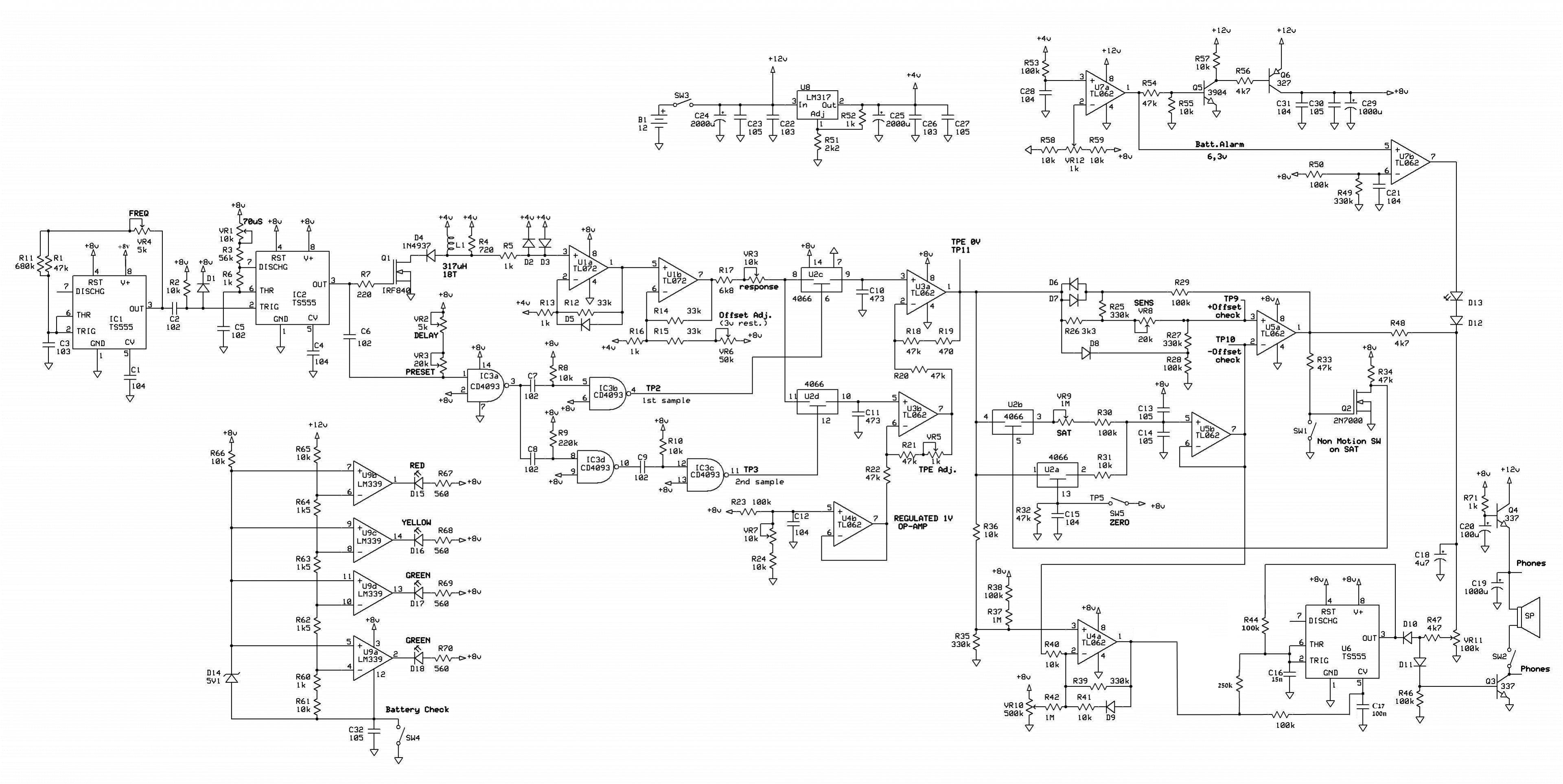

                  • Bouncing this project back up.
                    I had planned to work on this back when it was first posted but circumstances prevented it. So, after reading thru this thread a few times it looks like the project was good to go and Dooley made a change to the vactrol so it was eliminated and working without. I think it was Ivconic that did the full full page schematic as original to Dooleys.
                    Anyway, just wanted some clarification to the schematic to make sure it is good to go with the audio change.
Name:	TDX3 w Audio change.jpg
                    • I've made both the versions, the original and the modified and the audio of the original was far better.
                      I suggest following the original designs which worked better.
