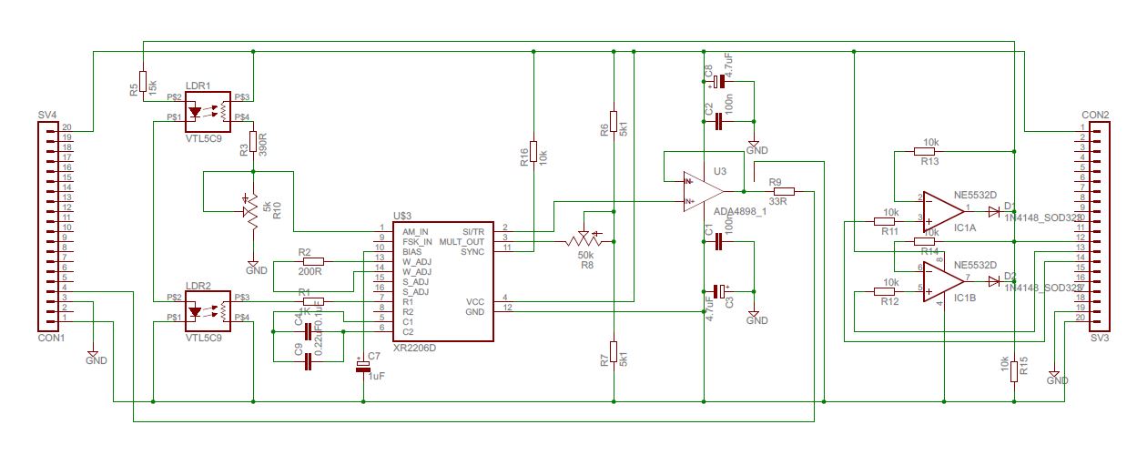

For my modified MPP I designed an audio stage around the XR2206. This is a monolithic function generator capable fo producing a high quality sine. It's an olden days IC and can still be picked up from ebay quite cheap.
In my configuration I use two Vactrols to get a warm but still very fast response that changes both loudness and frequency. With the MPP the threshold I can tune to a nice quiet low frequency sine. The ADA4898 is the headphone amplifier. (I had ordered a couple of these and plugged one in the circuit but they are actually overkill). The Vactrols can be also be easily obtained.
