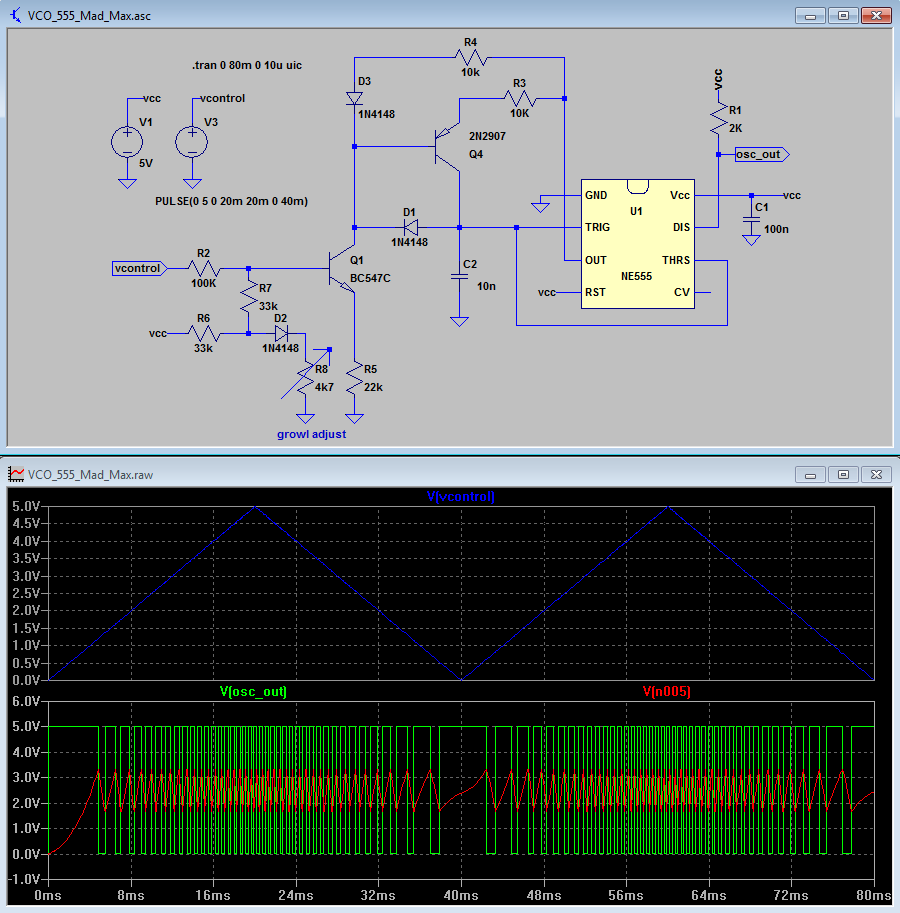

              ...applied Mad Max change, posted by Davor because [ATTACH]34341[/ATTACH]it uses 1 matched pair. Also added some notes - down left corner.
              Mad Max mod needs no matched transistors. Actually those PNP transistors may be just about any PNP laying around
              Also the growl trimmer VR12 should be 2k5, as the value from simulation is roughly about mid way.
                  Not quite, emitter degeneration does not work miracles. Try replacing Q4 with differet types in the LTSpice simulation and see what happens. The PNP transistors must be at least the same kind and preferably the same batch.
                  • I don't think Davor was advocating mixing PNP devices, although if he says it works that way I would believe it. Why the gun slinging for Davor? Seems like Davor and KT315. The 2 biggest contributers of Ideas to the forum draw the most fire? What's the Prob?

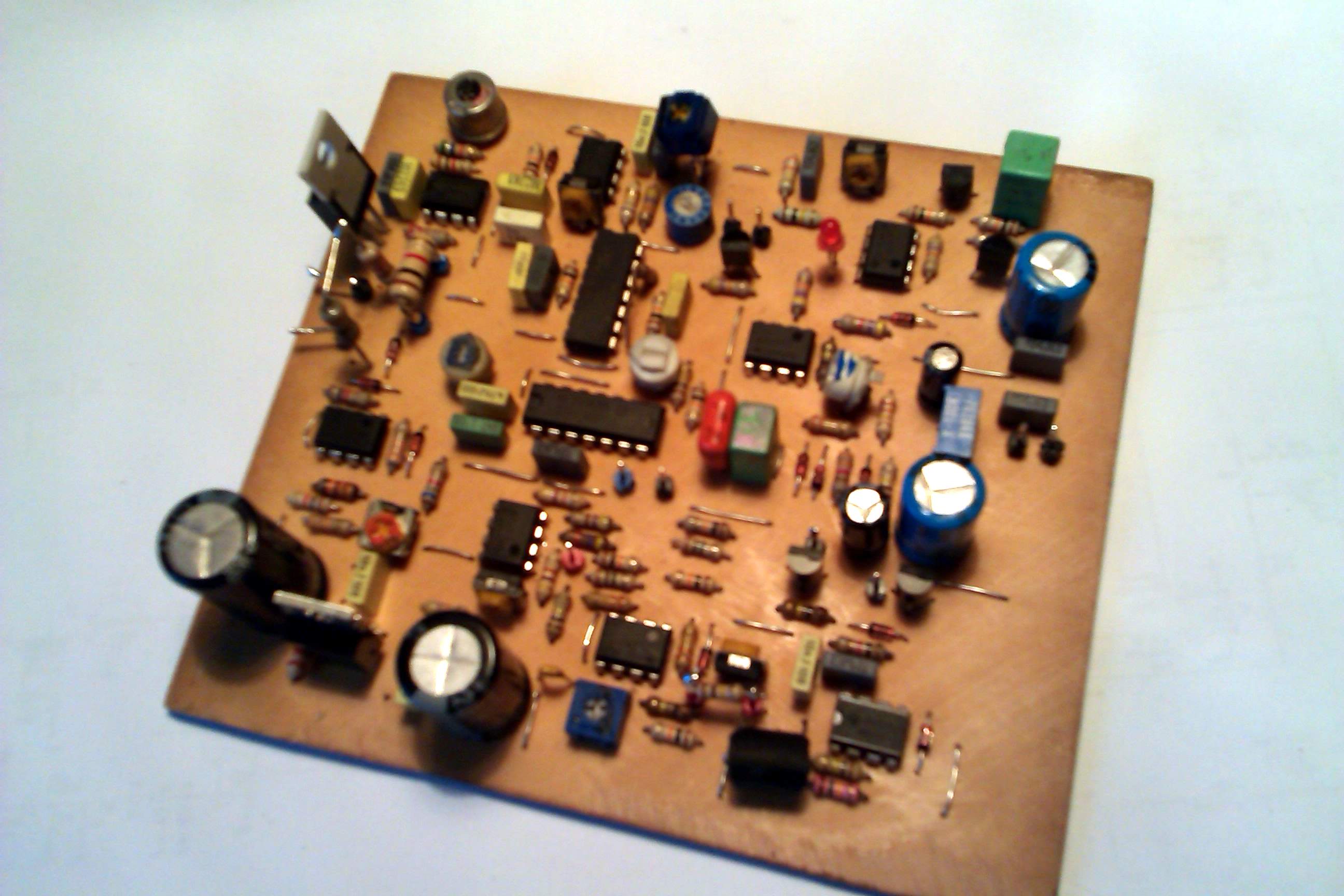

                    • I made one yesterday, finished late at night.
                      It's been a while since last time that i did pcb manually using thermo foil.
                      Vactrol i made with ldr and small blue led. Tried with red led too but seems blue led is "softer" in behavior.
                      I replaced 33k with 100k to cut down voltage&current for blue led diode. I got bit better behavior with 100k.
                      Ldr's i have dozen, mostly new ones. I even tried "couple" from old vcr. Have tried other solutions too.
                      F is 1.350kHz, coil is 38cm diameter, 0.33mH, 1.2 ohms. Resistor parallel to coil is 330+390 ohms giving 720 ohms.
                      All the voltages are in range, with trimmer i used on pcb i can't precisely adjust 8v, but 8.14v. +4v line is giving me 4.12v.
                      Detector is running smooth and is very sensitive on small items. Much more sensitive than Barracuda and SurfPi.
                      Also distances in air are fantastic; various coins is detecting from 20 to 40cm in air.
                      Overall; this detector is success! Bravo Dooley!
                      There is one bad thing though; Q2 BC337 from your schematic can get very hot if 8 ohms speaker is used and audio is present more than few seconds.
                      Luckily i am having one 100 ohms speaker and replaced 8 ohms speaker with it. Later i tested it with constant audio and Q2 remains stone cold.
                      So, i was thinking only to make some modifications there at audio output, so any other 8 ohms speakers later may be used without worries.

                      • Looking great Ivconic!
                        How do you always keep your board layout so simple, I mean just a few jumpers here and there on the top side is really cool, especially for first layout.
                        For the speaker there's a suggestion to add 33R for speaker, 100R for headphones on the audio output transistor, perhaps it can help.
                        Results are impressive too! Wonder how it will perform with larger (square frame coil) with increased pulse width?!

                          It works allright. It works even with a transistor diode replaced with a normal diode, and a bit adjustment at the growl trimmer, as per attached picture. Output symmetry gets worse though, and therefore a PNP signal transistor of preferably the same type is advised. Please don't consider the attached circuit as a solution - the price difference between a transistor and a diode is too small to compromise this much.

                                On contrary, i feel bit rusty in those things. Haven't draw pcbs for a quite some time.
                                It can be much better and more optimized. I am planing much better pcb once you establish your final version with all the proven modifications.
