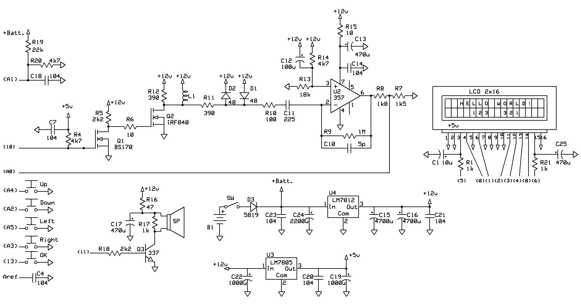

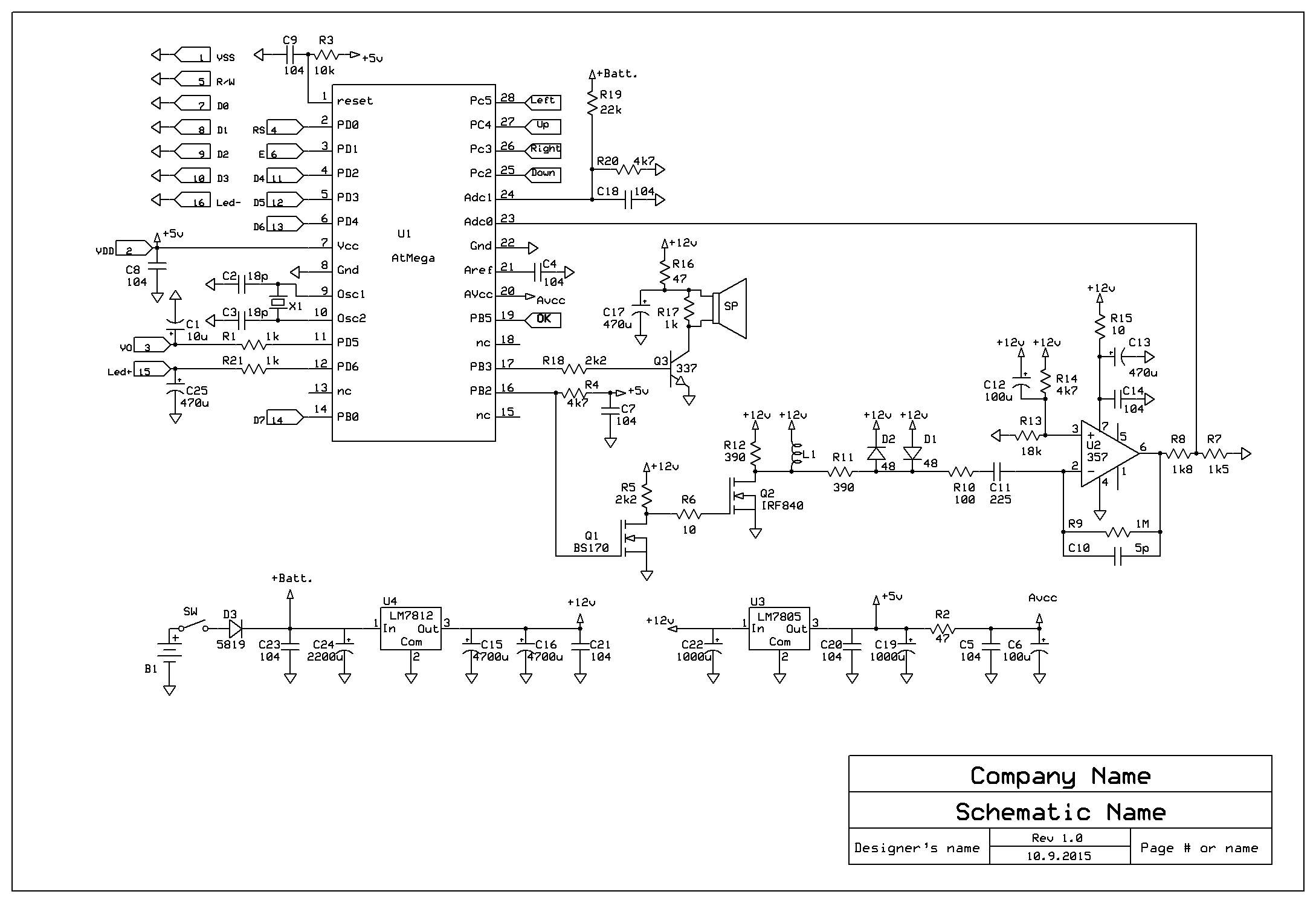

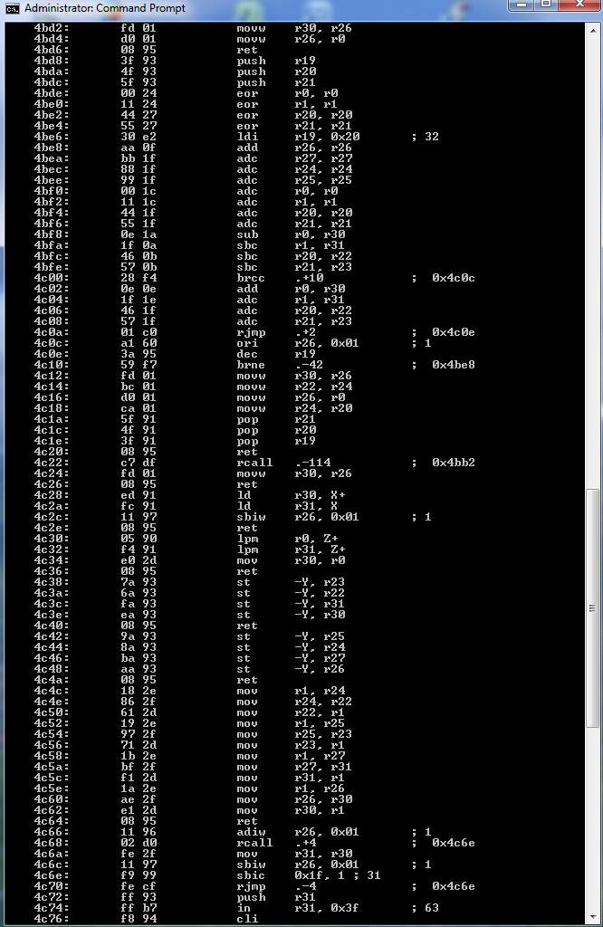

Is there any chance we to see source code here?
Arduino UNO and MINI Pro are here on the bench, waiting me to adapt schematic.
First step is to make better view on it;
The only way I can think of getting the source code is using disassembler (IDA PRO) which will produce C like source code,Originally posted by ivconic View Post".
[ATTACH]33729[/ATTACH]
which would help if you need to rebuild the source, but it needs to be written from the ground up as the produced code cannot be compiled.
Good schematic drawing by the way.

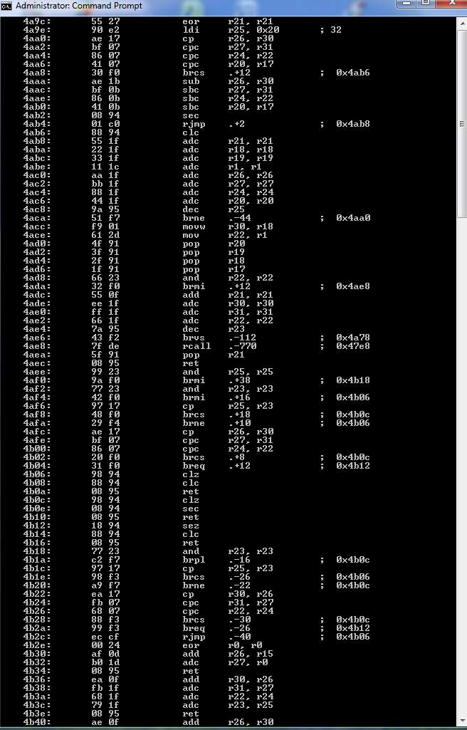

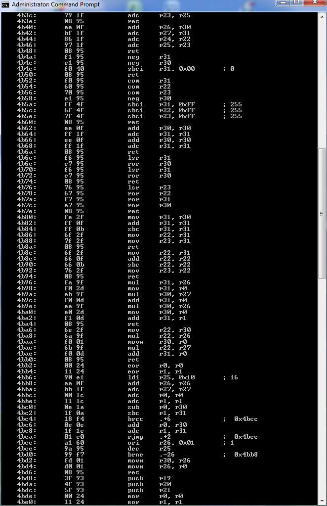

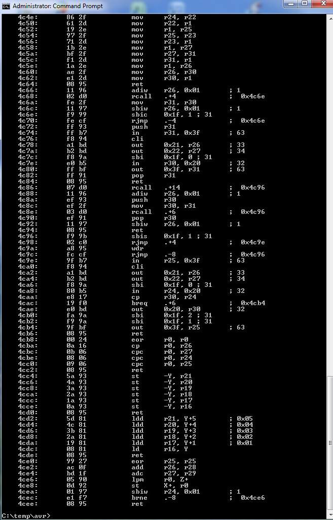

Yes i thought so. I have IDA for long time.Originally posted by eclipse View PostThe only way I can think of getting the source code is using disassembler (IDA PRO) which will produce C like source code,
But i tried avr-objdump and it does the job ... only i can't locate dump file on my hard disk yet!?
Process is invoked from command shell and it runs so fast that i can't see a thing, i only see dump lines "running" fast until it finishes and close cmd.
Must be some flag that i forgot to include in cmd line?
Try this and see if you can catch dump file location; avr-objdump -j .sec1 -d -m avr5 FelezJoo_PI_v3_00.hex
The thing is that I can't get pseudocode function to work for this file. I've tested it with Quasar ARM and it was working. Seems CPU dependant.
Dumps can be studied within the program itself, outside and without pseudocode view is nearly useless.
FelezJoo_PI_v3_00.rar

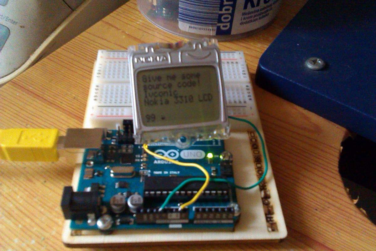

Davor; would it be enough to attach lcd&buttons&extra_few_parts on Arduino and upload the hex file, than connect it to digital scope and see the outputs&inputs?
Before making any progress in this diy it is indeed itchy for me to see the "menus" and options; therefore i did adjustments for Arduino UNO:
