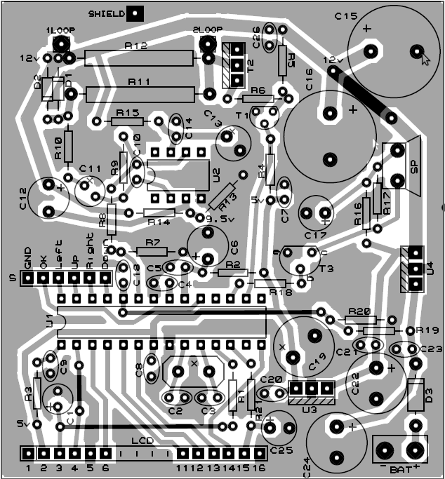

            As promised, here's the schematic. If you spot any errors, please let me know and I will correct them.
            I've also included a PCB overlay with the components and tracks combined.
            I guess we'll soon know how well the "iron reject" feature functions, and whether it's capable of working with Oz soil conditions.
            It would be interesting to test the claimed ability to detect small gold, as the huge gain in the preamp should be a barrier to sub-10us sampling.

                HI Qiaozhi,
                With gain like that on the preamp, I can tell you it definitely will not work here in Oz..
                Cheers Mick

                  That was exactly my thought as well, but the claim is that this is a PI detector to suit all conditions, and with iron reject.
                  We shall see what we shall see, as soon as 6666 has built a copy for testing.
                    From the pictures I posted at the link below, everyone can see how bad mineralized soil is and thats only with a preamp of 100x.

                        But ... the Minelab GPX uses Multi Period Sensing (MPS), Dual Voltage Technology (DVT) and Smart Electronic Timing Alignment (SETA) ... and I don't see any of these in the schematic. The GPX is also designed to find sub-gram nuggets, which requires sub-10us sampling. With the preamp gain set to 80dB (and a 380uH mono coil) there is absolutely no possibility of this happening in this design. I'm sure the software is using some novel techniques to try and extract target information from the input signal, but [like all PI detectors] you cannot extract information that's not there. Although you can do some clever manipulation of the sampled data, any so-called "iron rejection" will still be based on target conductivity, so it's never going to be anything more than an educated guess.

                              THANKS Qiaozhi, much appreciated, this will be a long term project, and depends if I can manufacture the pcb.
                              I would like to discuss R5 which is 2.2k , I've seen similar ccts, with the resister being as high as 10K such as the Skif PI
                              what concerns me a bit is that circuit configuration will dump the 12v onto the gate of the IRF840
                              but wont the high value of resistance 2.2k (up to 10K) limit the current into the gate and not fully turn
                              the fet on ?
