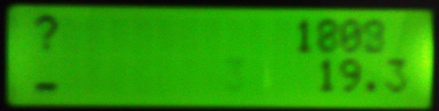

    In the picture above you see on the screen that displays a summary of system settings.
    The first line of a question mark, indicating the number of VDI.
    And when the system will sense something instead of a question mark, a number from 1 to 99 displayed.
    The letter S stands for sensitivity. And the number after it, the amount of sensitivity that is a number between 1 and 20.
    The letter D stands DELAY and number later also show the amount of manual delay.
    The letter F stands for frequency, and the number after that displays the set frequency.
    The letter p stands for the pulse with. And then also the number it shows.
    Next in line is the dark line represents the balance of the system and if the system is in this case an exclamation point! Show, indicating the presence of holes
    Go out right on the screen, the battery indicator that shows the battery voltage.

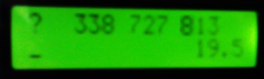

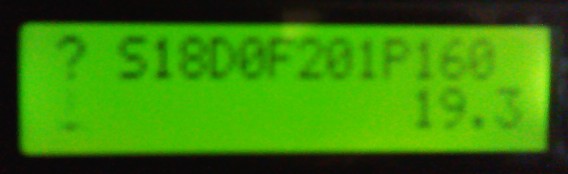

    And if you press the up button, for the second time, you have three numbers on the screen, you see, as
    shown below.
    These numbers are very important. And indicates that, Op-Amp is the original, and system health.
    These numbers, called numbers separate channel.
    To separate operation, properly done, and iron removal be done carefully. Note that these numbers should be close to (300,700,800).

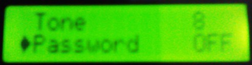

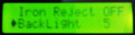

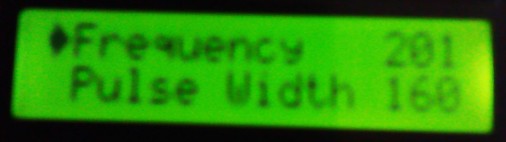

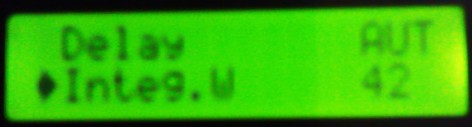

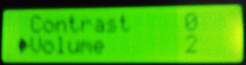

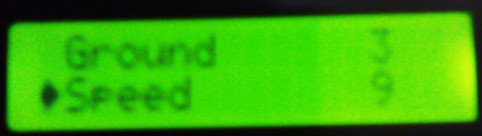

    In the next picture you can see the options in the menu.
    Using the up and down keys, you can switch between options. And using the left and right keys, you can change the desired options.
ID:	343407Click image for larger version
ID:	343408Click image for larger version
ID:	343409Click image for larger version
ID:	343410Click image for larger version
ID:	343411Click image for larger version
    In the next post I will try to pay close examination of menu options, and how to fine-tune these options, explain.

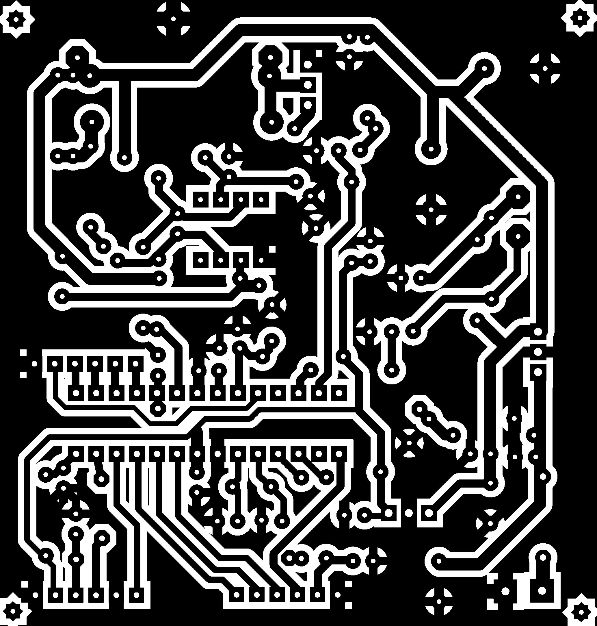

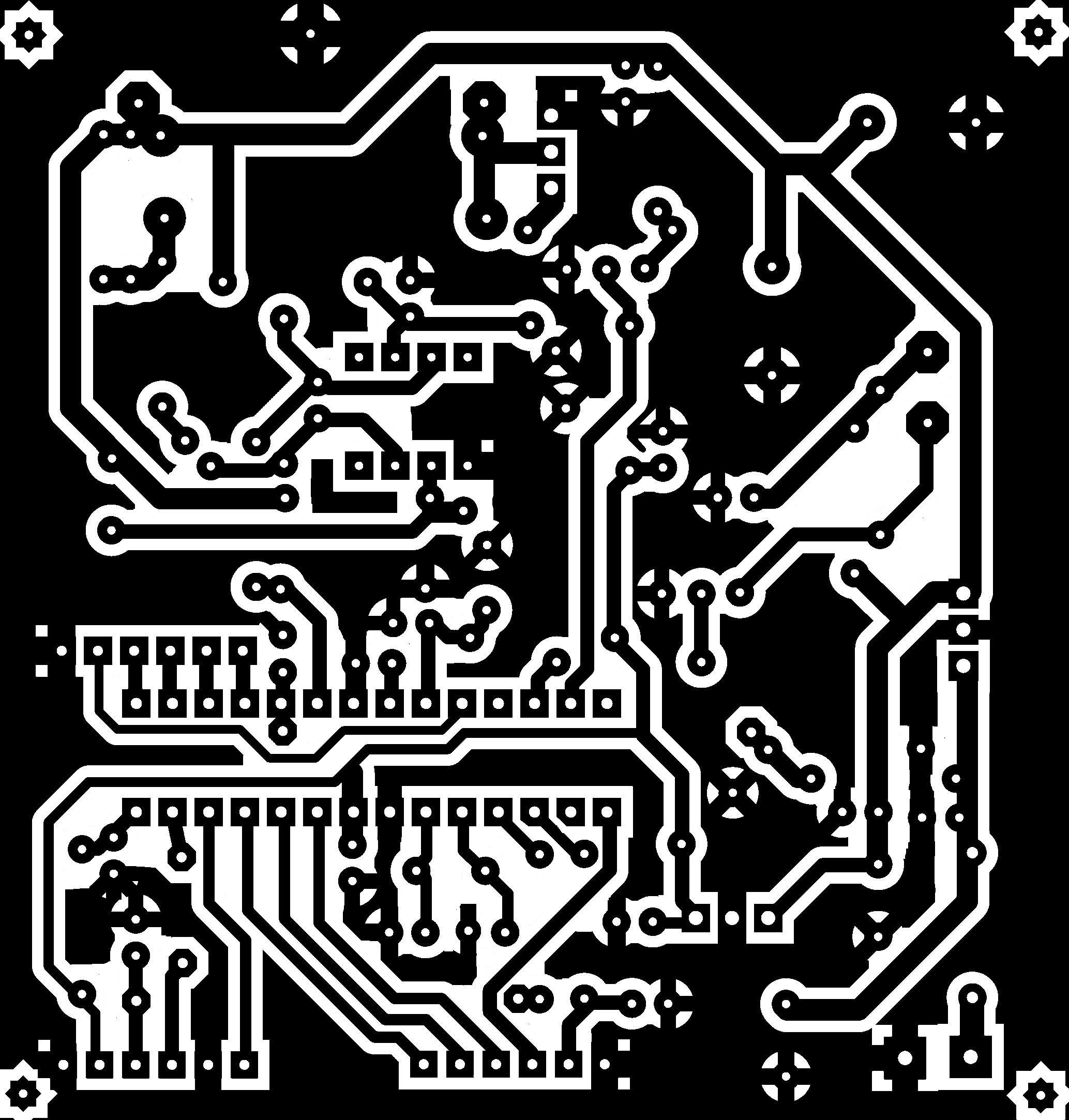

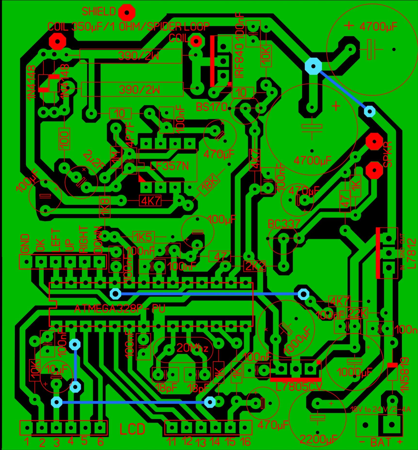

        hi all
        i ve made sprint layout pcb,if some one want??
Name:	pcb sprint.jpg
          hello nick
          just put them in the message Attachement as zip Container, thanks
          you could add thermal pads on the solder points which are on the massive plain
            Hello Nick, please give board in format Sprint Layout
            if possible

              Nice work nick.
              If you can ad black-white one .jpg, it would be great.
                hi all!!!
                hi bernt,it s nice to read you!!!
                i ve corrected the layout with thermal pads ,but don t know how to post file!!!!
                WM6:
                i can give it ,only in bmp format .sprint layout export B/W file only in bmp!!!
                  BMP is ok for BW. Thanks.
                    On the left side menu choose Save this file as xxx.LAY. And ready
                      hi wm6
                      here s your board :75mmx78.6mm
Name:	pcb sprint thermal bw.JPG

                          Very nice. Thank you nick.
                          Please check this (arrow), cause it could lead to short circuit:

                              A little retouched nick layout:
