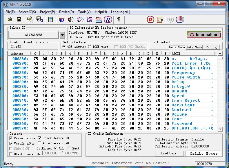

              Hi Nick, thanks for the finished file as TYPON 2. Do you have any information about password-felezjoo pi.hex

                  This is a picture of programmer you see option password

                  • #54
                    Password means you can set a password (numbers) to make device private.Then when device starts again, it asks password to run. This option (password) provided to NOT allow non-owner use device without your permission.Here is a kind of anti-theft option
                    • #55
