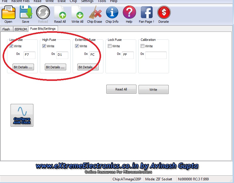

                      • Could some one help me to burn this atmega328 with usbasp burner and avrdudess software (i dont know how to set fuses) thanks lot
                        • Originally posted by nick holas View Post
                          have same problem maybe someone skilled like Silverdog could help us
                          • It's all there in the first post. The only setting you need to change before programming the chip is that on the photo.

                            • Hi all
                              Thanks for your reply eclipse but i don t have the habit with atmega and avrdudess (i prefer using microchip pics).
                              Perhaps someone could help us to brun this ,step by step?
                              (I allready broke 2 of them!!!!)
                              Thanks a lot
