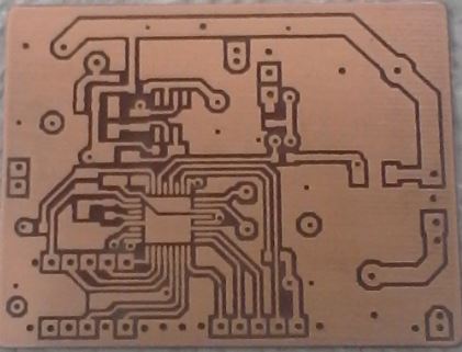

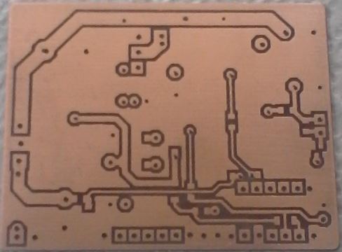

Hello
for usbasp connection board to atmega328p
AVR Target Board: This for programming AVR chips and specifically the one's i am using are the ATtiny85, ATtiny2313 and ATMega328P. This not my original design. At this time i can not locate where i got the files from. When i find them i will include them. &n…
I simplified it for only 28 pin attached lay6 and pdf
