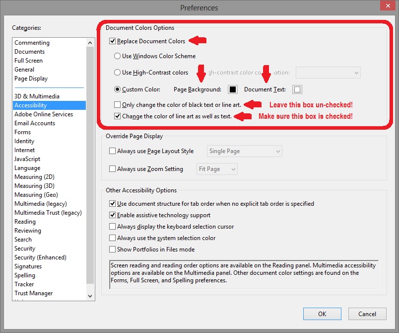

                            • Negative artwork from positives
                              Silly me... As it turns out, the Acrobat Reader software will allow you to invert the positive PCB artwork to create negatives (I did not know this).
                              So if anyone needs negatives (for example, using negative photoresist), do this in Acrobat Reader:
                              - Go to Edit > Preferences > Accessibility
                              - Follow my instructions in the RED area within the JPG below, then just save and print
                              Presto! Now you've got negatives.
                              Guess I was trying to re-invent the wheel earlier.
