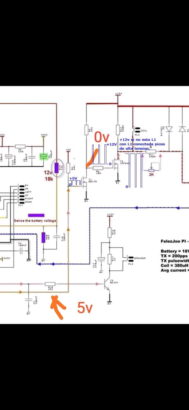

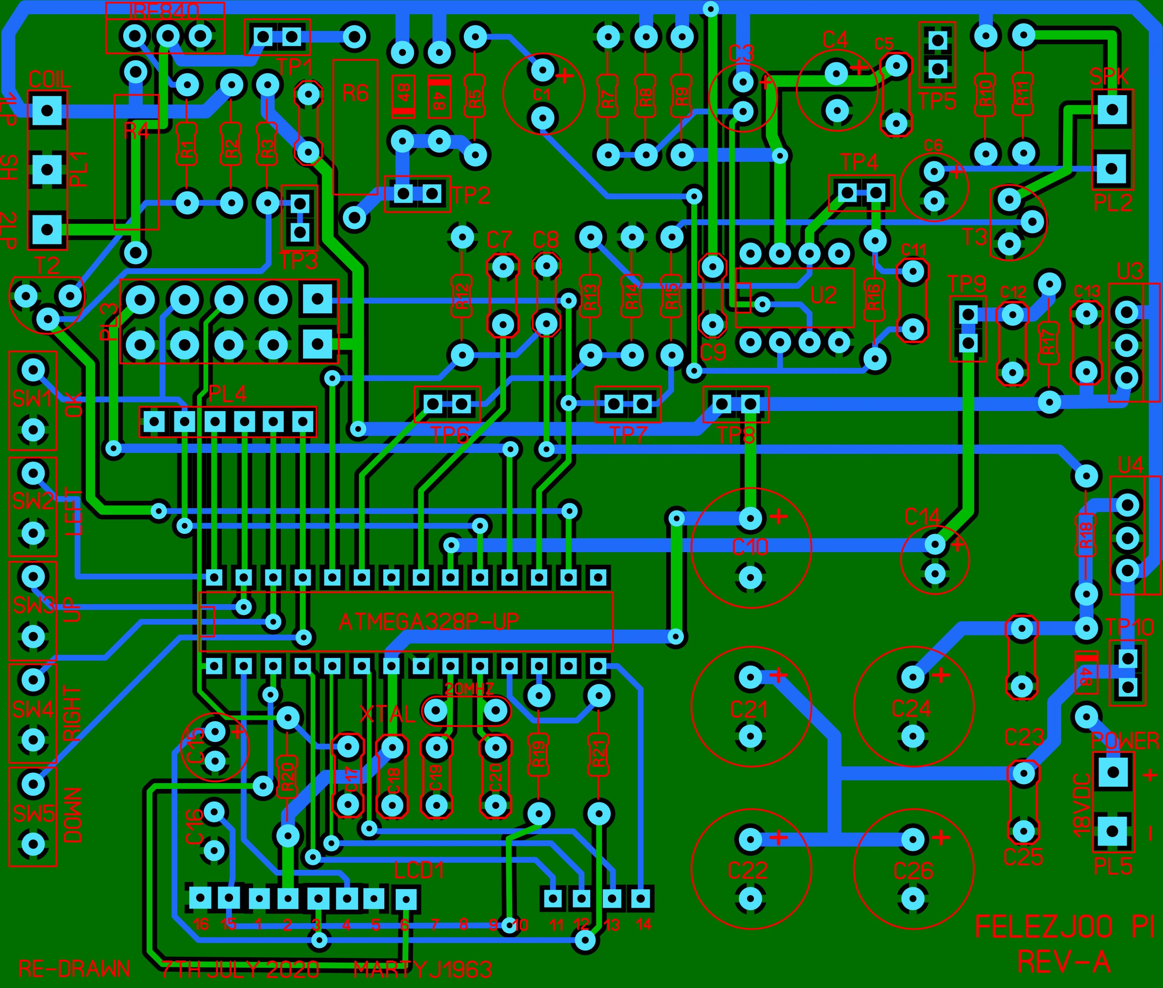

            • I was able to check and indeed the BS170 is not the problem, it is that there is no pulse in the Gate in the BS170, but then what would be the error, by the way, I will upload the image of the pcb that occupies the diagram as well.
              If you could tell me if it is because of the pcb or something else, I would appreciate it.Click image for larger version

              • There is no way I can tell you what is wrong. You'll need to troubleshoot, start with the micro and find out if it is working or not.
                • If there is no pulse at TP3; obviously the chip is not generating it, or...
                  Most trivial reason; TP3 is by mistake inadvertently short-circuited.
                  If not the case; than chip is faulty.
                  Or... the code in chip stopped to work properly due some over-counter protection.
                  Small oscilloscope that you have is good enough to check these things.
                  First make sure that TP3 is not short-circuited.

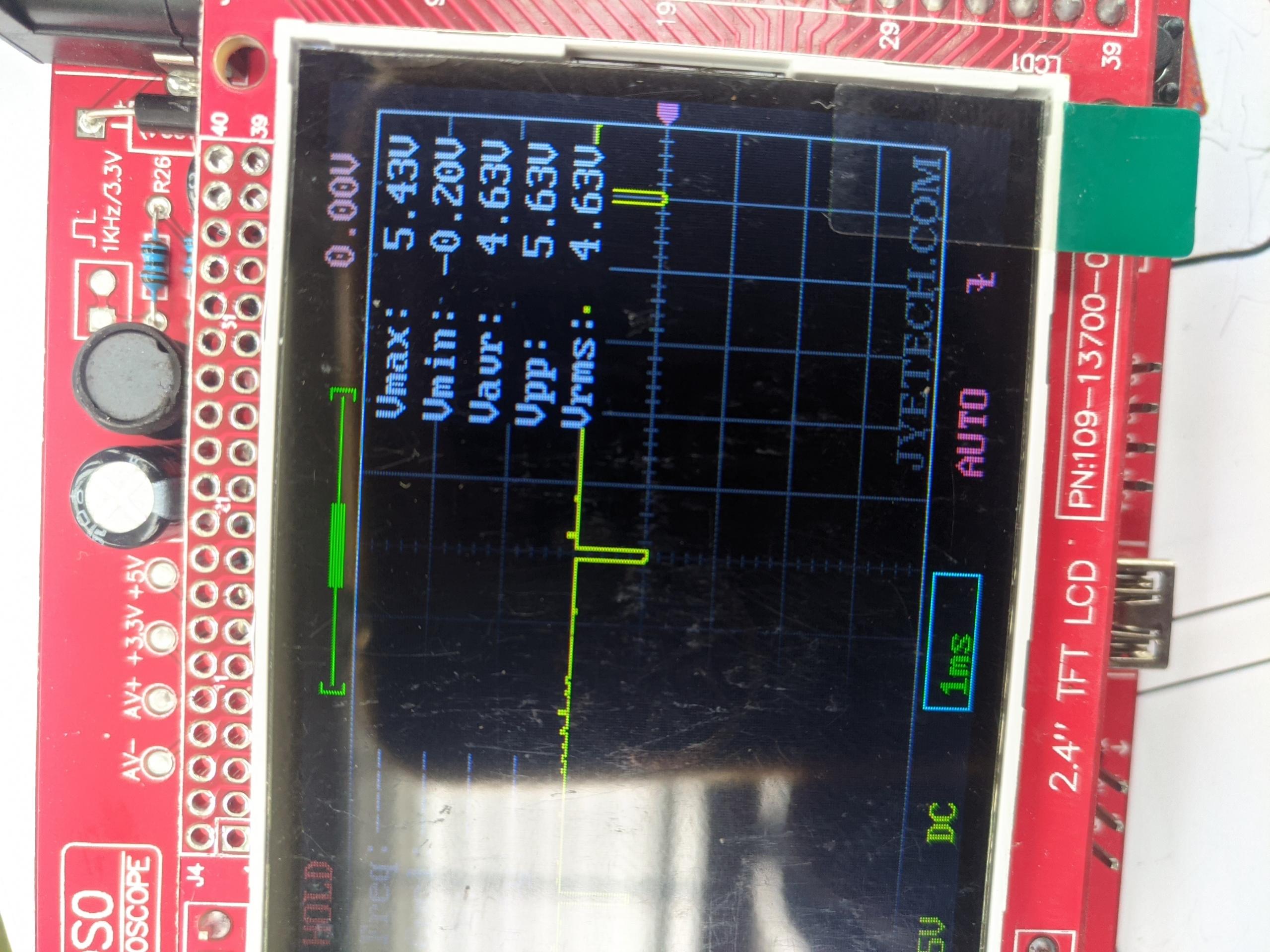

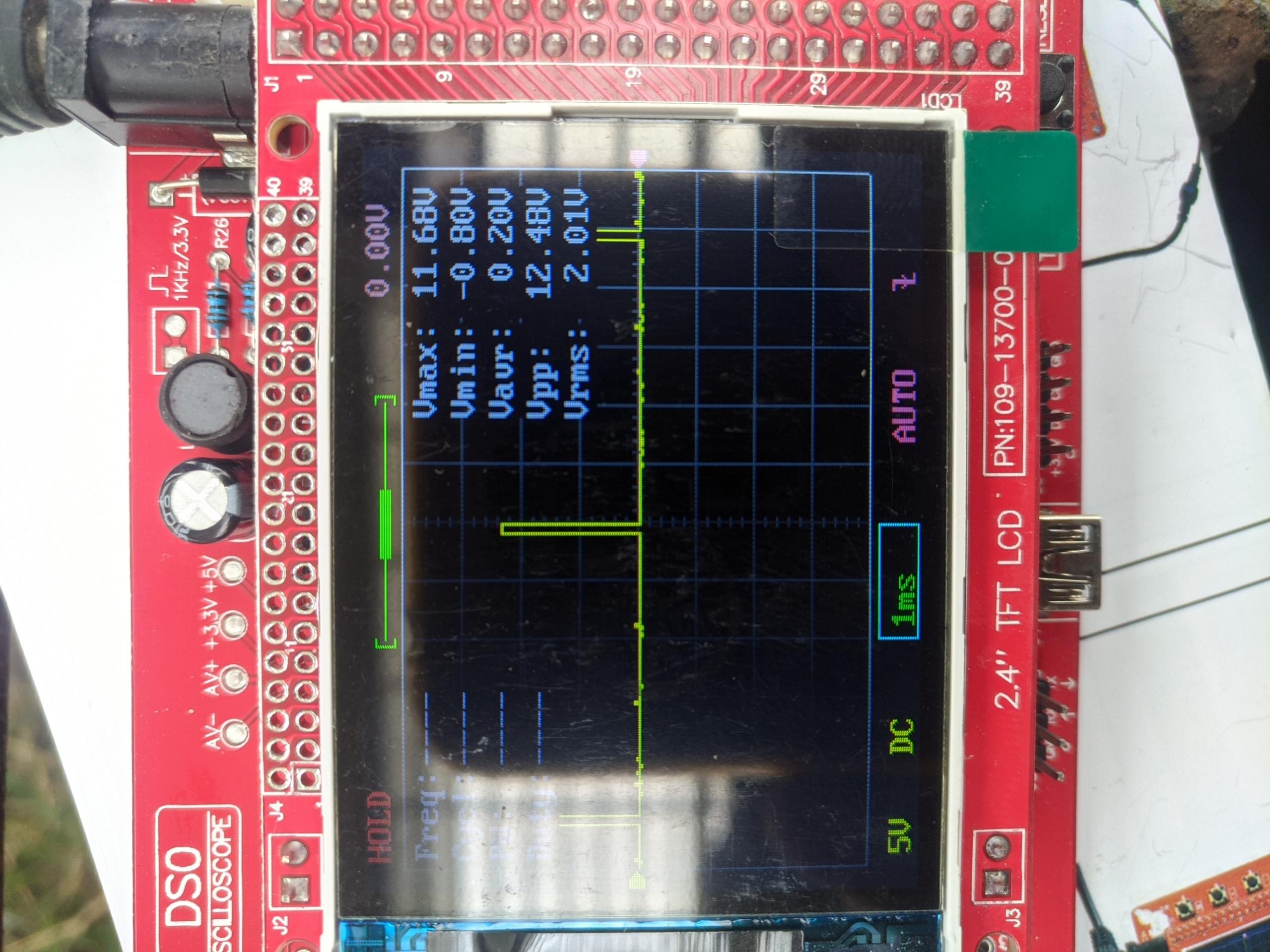

                        These are the data that I obtained in gate and in the output it seems that if I have the pulse but in the output it does not seem correct for that reason some replacement for bs170

                          Since felezjoo is largely the same as Pickini - the main difference is voltage sampling vs temporal sampling:
                          The pulses you measured at gate and drain of the BS170 look OK: inverting level shifter 5V->12V.
                          The only problem I ever heard of with the BS170 is that there are components with different pinout:
                          But this other pinout does not result in a correct pulse inverter like you have.
                          • but I checked the pins of the bs170 with an lcr checker and everything is correct, so I don't find the problem since in gate it is fine but in drain it is wrong, it seems inverted.
                            • They gave me this image, it's fine, so I mean the pulses in the bs170 and the irf840
