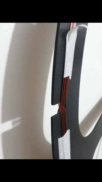

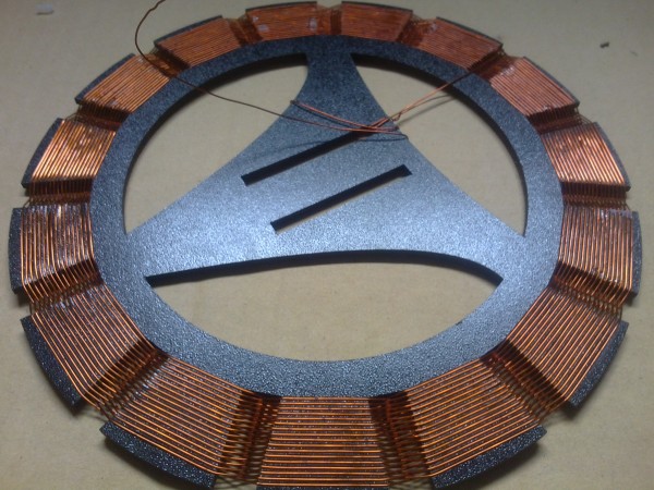

                    -i strongly recommend flat or spider loops provide about 20% more power than a regular loop, also the discrimination depends a lot! (use the exact wire size for different coil diameter)
                    Specifications of Different Spider Loop Models Suggested with Lacquer Wire
                    20cm loop: 12.5cm inner diameter - 42cm - about 24m 0.8mm wire.
                    30cm Loop: 24cm inner diameter - 29cm - about 27m 0.8mm wire.
                    45cm Loop: Internal diameter 39.5cm - 22cm - Approx 31m 1m wire.
                    60cm Loop: 55.5cm inner diameter - 18cm - about 35m 1m wire.
                    Loop 70cm: Internal diameter 65.5cm - 17cm - Approx 38m 1m wire.
                    80cm Loop: Inner Diameter 75.5cm - 16cm - About 41m Wire 1mm.
                    90cm Loop: Inner Diameter 85cm - 15cm - About 43m 1.2mm Wire.
                    Loop 100 cm: Internal diameter 95.5 cm - 14 rounds - about 45 m 1.2 mm wire.
                    The coil does not need to be exactly 350 uH and 1 ohm! This is a suggested limit for achieving the right range with the correct separation. So a capacity of 300 to 400 uH, even a little more or less and a resistance of 0.5 to 2 ohms still works well. So you don't need to look for exact figures. Big coils should not be tested indoor!!! For me, also 30cm diameter coil is hard to test indoor , keep it away from big metal when testing.

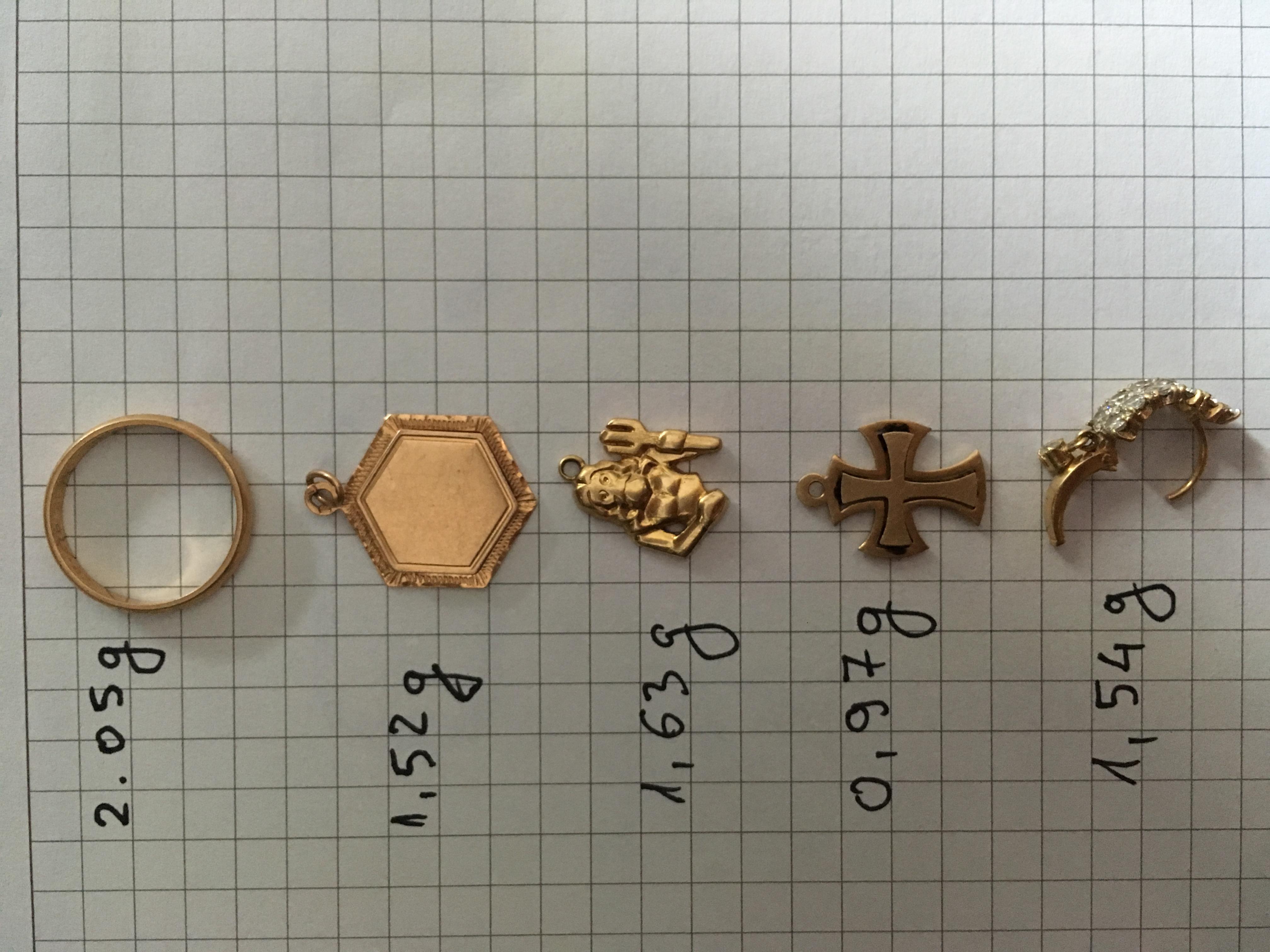

                    Air test settings: Freq 201, Pulse 150, Delay 0 (for most sensibility to small items), Ground 10, Speed 10, Sens 18 (adjust at maximum you can without having chatter) Integ44, Iron reject must be adjusted different from coil to coil.
                    Author suggested settings for land use are: Frequency 100 - Pulse Width 180 - Delay 30 - Off Ground - Speed ​​8 and Sensitivity 12. However, maintaining the correct loop distance from the ground is always the most important factor for good stability, especially on poor terrain.

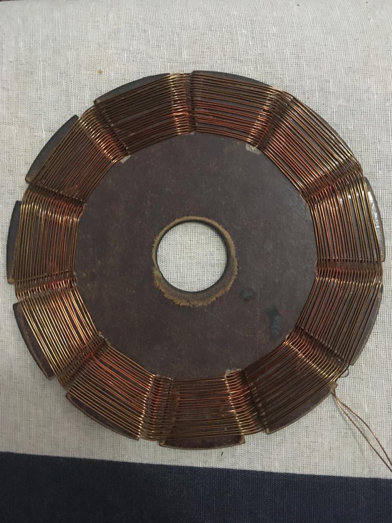

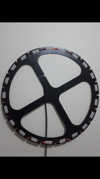

                      • Some coils:

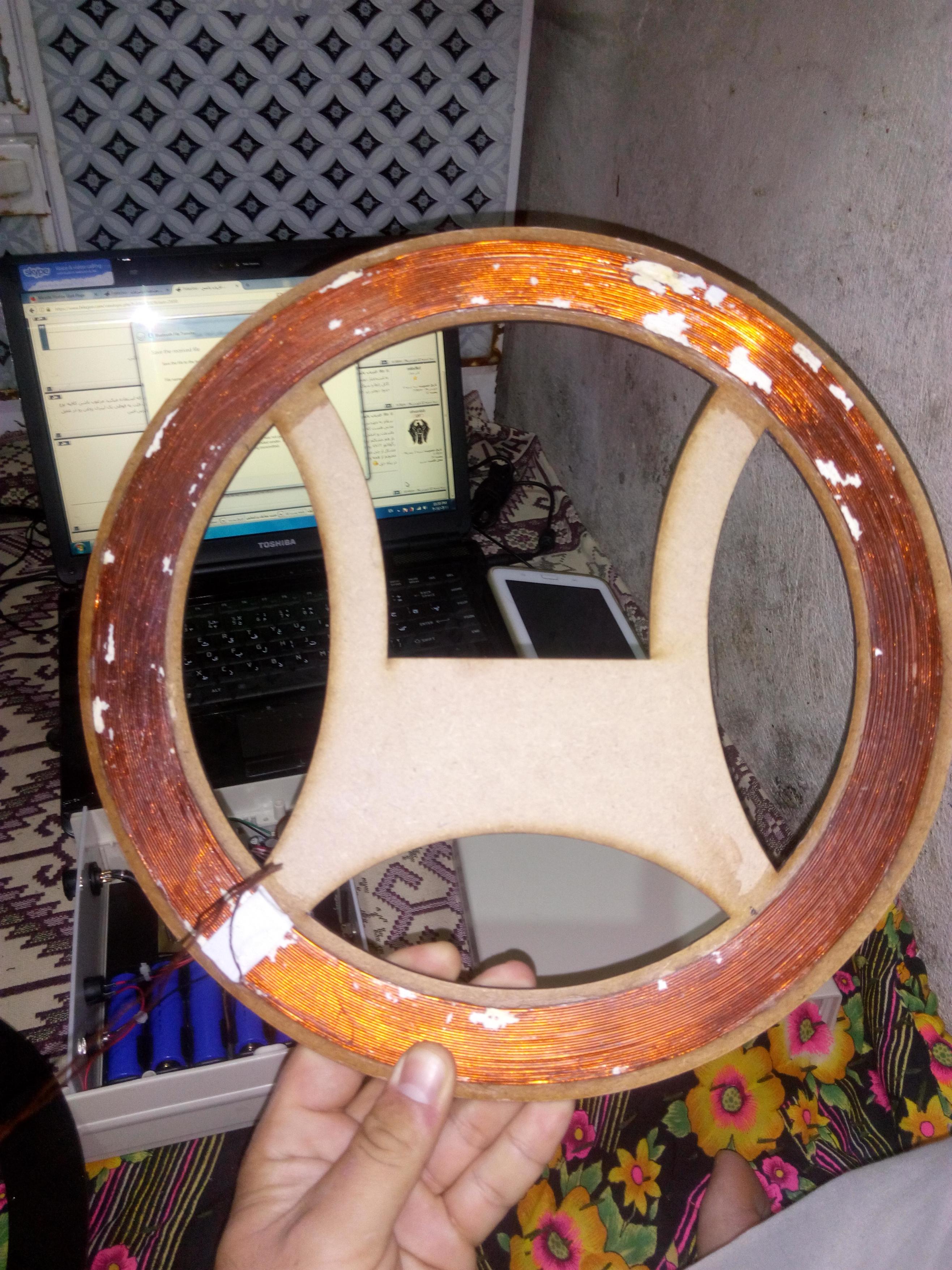

                        • If someone can post appropriate files for these coil forms so to get them cut from cnc machine in my area.

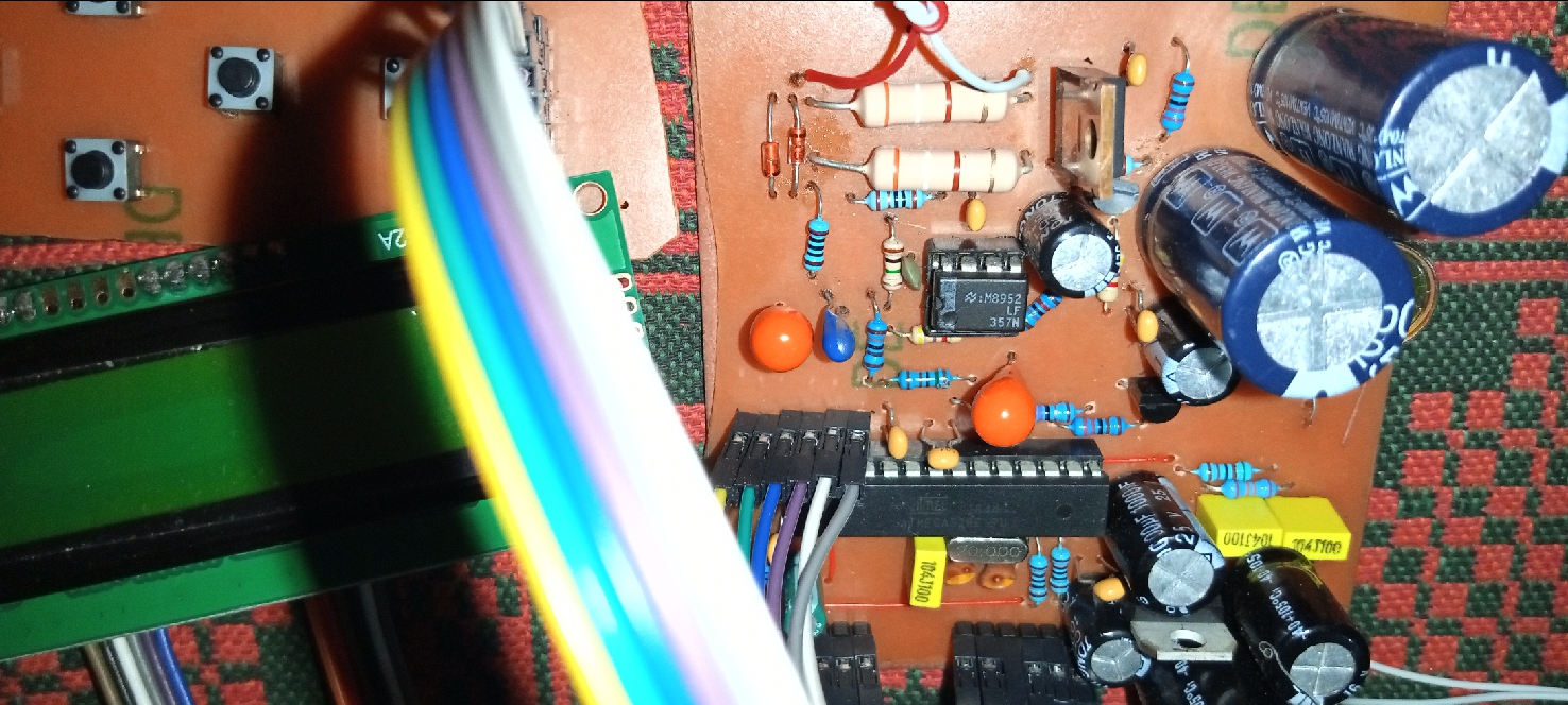

                          I have lots of hope from this m.d. My components are same value as prescribed. I have two boards to try different combinations. One board has no U4 but both are running on 12v battery.
                          I think EMI is a big big issue in this board; Not cleaning the solder-paste residue gave me coil errors. Maybe a better layout is required. Ferrite beads sounded a excellent idea but no experiments shown on the thread.

                            My 12cm coil base was cut with a laser by a friend from textolite, i did not have the file but it is easy to draw. important to make uneven number of grooves.

                            As for the layout designer explained that he calculated every single detail, component placement, ground plane, traces etc.

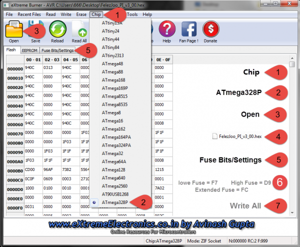

                            • Dear radio friends-amateurs, I have программатор of AVR USBASP and the program AVRDUDE is set, I can not find FUSE for programming of ATmega 328, I ask for help.THANK YOU!
                              • Originally posted by nikko10 View Post
