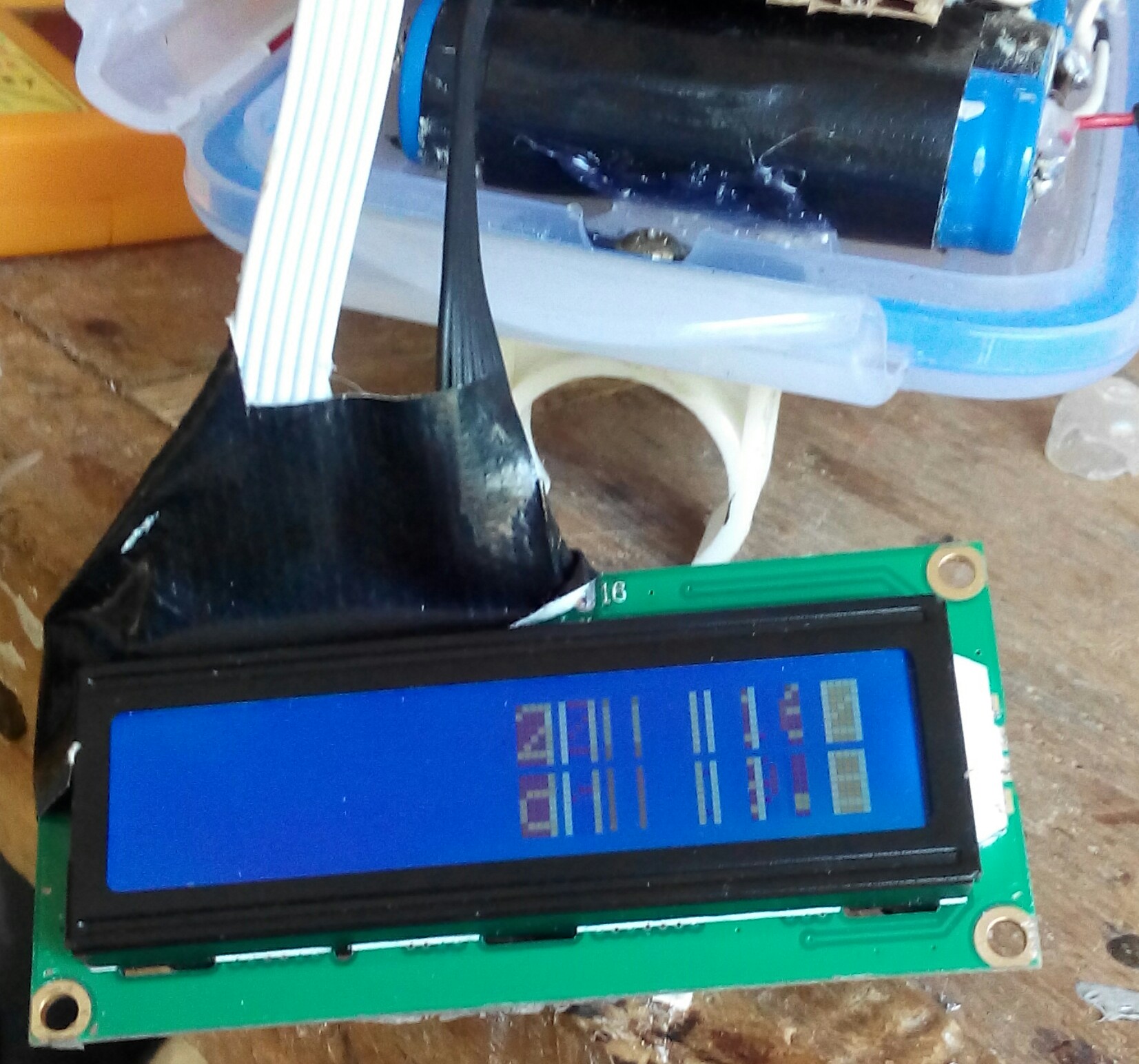

Either is broken either you swapped wires.Originally posted by jladre View PostAfter transfering all parts to my new easy open waterproof box my lcd seems damage. Can anyone tell what would be the problem? I had already check the wirings and it is good and correct. Lcd display photo is below.
[ATTACH]35630[/ATTACH]
Also check paths from Atmega to LCD.
Check all over again.
Most probably it detached from its base. There are rubber-like contact ribbons that provide contact between a LCD base and a LCD glass, and those are notoriously flimsy. That's one of the reasons I hate LCDs for terrain use. You may try to fix it, but your better choice is to simply replace a whole LCD and avoid hours of frustration.
